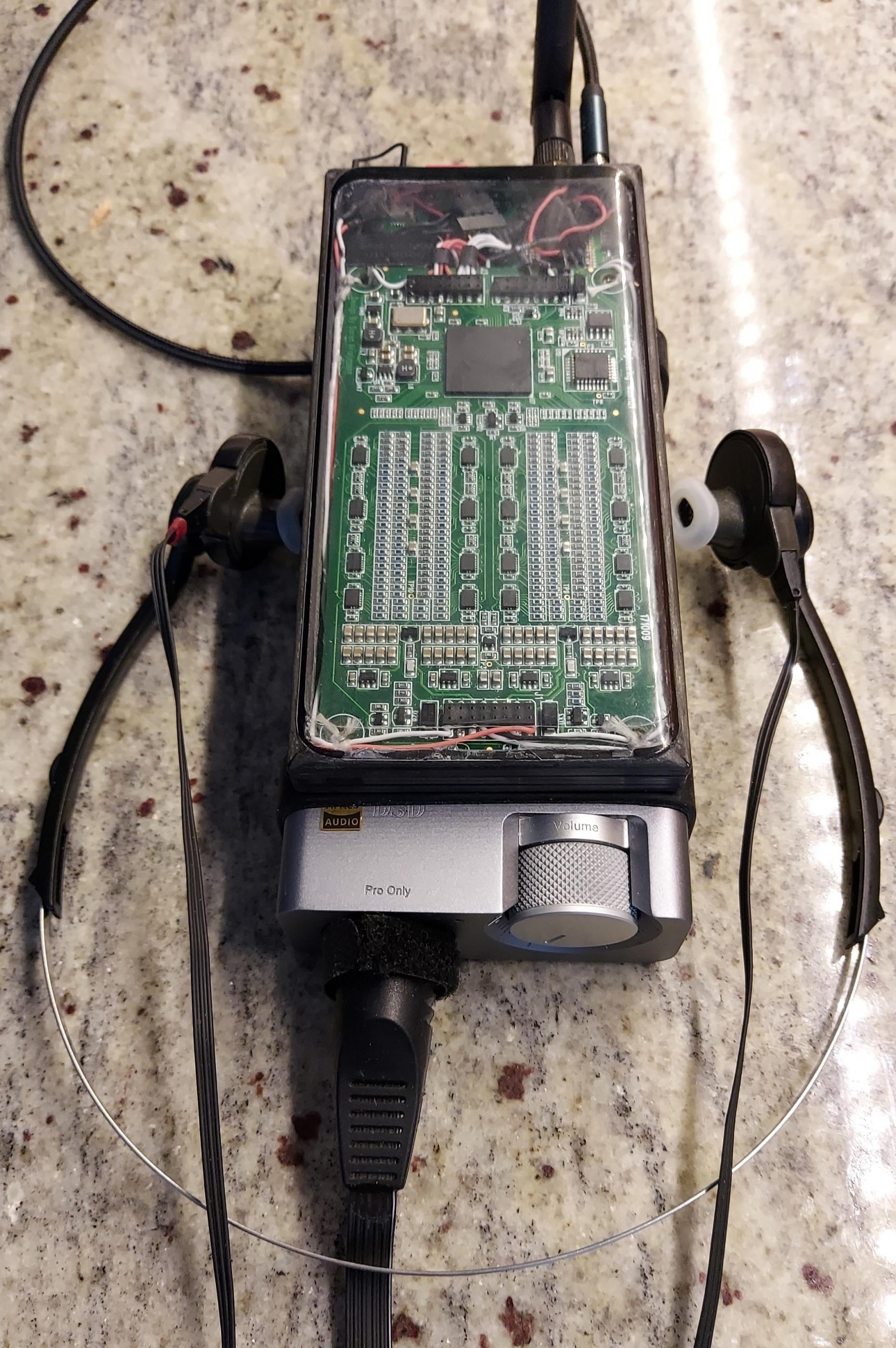

Portable Dac
The long in-work of aportable Dac part of a music system is ready.
It took such a long time is due to the Chinese showing their worst side by sending two broken bluetooth receivers. But the third time, a working unit came. I2S bus is connected and it worked immediately. With an old-fashioned antenna, both range and sound quality are better.
Well, it's been a lot of handicraft anyway. All connector are homemade as the space is not enough for something ready.
Without carbon fiber profiles, it would hardly have been possible to craft a light, attractive and strong casing. Only glue and double-sided adhesive tape is used. There is not a screw.
The dam1121 is Soekris' smallest size Dac and so nicely built that it deserves to be shown under the mobile glass.
The battery with a Traco low-ripple converter supplies +-5V and lasts for 6 hours of use. The UDB connector allows for recharging ad well as an I2S temote connector.
The companions are a switched ELS amp with earspeakers from Stax.
Sounds super.
As you realise, I am betting on a pandemic-free near future.
Lars

Funny i am working on something similar, except i won't use a battery, but i will include a player. I will also use a dam1121, and different other parts :
headphone amp base on opa1678 + opa1656
silent switcher psu
nano pi neo 3 as mpd player
probably a couple of amb a24 as buffer and se-bal converter
All that in a takashi MXB4-10-14, i receive the case today.
For the software part the nano pi is suppose to support 24/192 in it's i2s out. I will use mpd and the api you can find on the net to control the hardware mixer of the dam.
I should finish it in a couple of weeks, i will post some photos.
