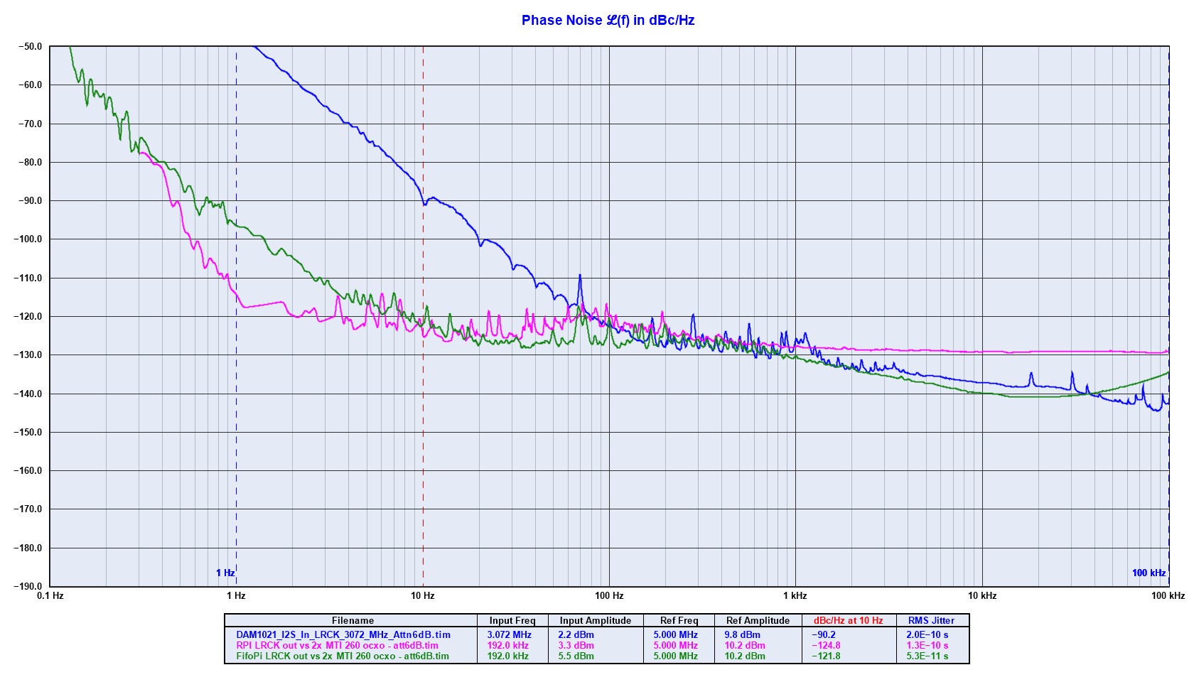

The backstage coming out from the DAM0121 is far form the reality, but if you like its representation I'm happy for you.
I'm not so happy.
Then this is the measured result: the DAM1021 LRCK is 34dB worse than the RPI LRCK. And the jitter has not been reduced, it has been added as you can clearly see from the plot.
It does not matter?
Well, let me know about your experience and your results.
I'm very curious.

Do you seriously think that everything you hear from the DAM is clock driven?
I will refrain for discussing SQ because it's to personal and subjective. What I don't like is that you spread false info about the relation between clock behaviour and analog side impact - with no measurements and obvious a lack of understanding about the relations.
You claim that something was rather added jitter wise - I wont believe that before I see a measurement without changes to the Si - and that wont happen - we both know that - but it doesn't make your claim a fact. It's probably just a guess or wishful hope - right?
I have stated many times that the DAM fifo don't let jitter pass, only wonder - it's technology and its defined by the fifo time constant for changing the clock. That has been shown by zfe measurements - if you don't understand them, ask.

I have measured the jitter, it's a fact, there is no reduction while it even increases.
I don't spread any false information.
I believe the front-end of the DAM is not properly designed, this is my opinion.
You don't agree. Well, I'm sorry, that is.
Would you measure the impact of the jitter on the analog side?
Well, buy the gear or build it yourself.
Do you trust the relevance of the long term stability in digital to analog conversion?
Well, you are confused, but it's your problem not mine.
And finally I see you have not yet explain your experiments.
Maybe you have not yet experiment?
I think so.

You are correct. You can't measure jitter on the analog side of DAC - only on the clock, jitter is defined /Yoda style/ Jitter has impact in analog side and you think-wish that it is "timing" but you really don't seem to have an engineering idea about what happens - you seem to think that it is also timing here, but kind-of different timing.
I own the Ian FIFO since long and have tried with different clocks. I also made mechanical isolation trails.

You really don't understand.
The timing errors occur during the conversion, when the latch of the 595 is clocked (on the rising edge).
At that time the ladder changes to generate the voltage corresponding to the new digital word (since the DAM is a voltage output DAC).
The jitter causes a timing error in the above transiction so the ladder is updated before or after the predicted time.
Does this generate THD?
Maybe, I dont know and also I don't care.
If you care build your gear and try to measure the THD.
