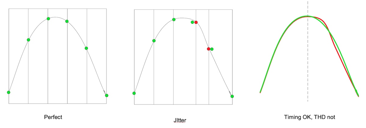

It's a timing distortion rather than a digital one.
From the digital point of view there is no distortion since data are and remain bit perfect.
The problem arises when the conversion from digital to analog signals takes place.
In a PCM DAC like the DAM1021 there is a precise moment when the switches change their state.
At that time digital data are converted in voltage or current (depending on the DAC) by combining the resistors of the ladder based on the digital word.
The conversion takes place with a precise time cadence to reconstruct the analog signal from digital data.
In case of PCM DAC like the DAM1021 the timing signal that dictates the cadence is the LRCK.
If you assume perfect switches and perfect resistors in the ladder no THD can occur.
But if the timing signal is not perfect a time distortion can occur (jitter in time domain, phase noise in frequency domain, anyway short term stability since long term stability does not matter in digital audio although someone continues measuring the Allan Deviation).

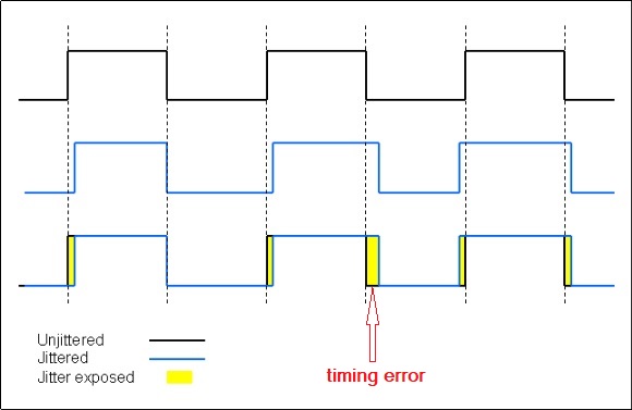

Jitter (or phase noise) does not imply "timing errors" in music reproduction.
Two very valid points.
Not exactly.
When you have jitter (or phase noise) each clock edge will not take place exactly at the expected time, that is will be affected by a timing error.
The audio samples will be played with an incorrect cadence that means exactly "timing errors" since we are talking about time.

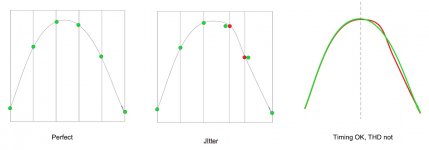

Not *exactly*... I'm sorry, but this is false. If you just think a little about the time scales between jitter and a struck drum or a plucked string - or even an imagined small tiny bell creating one little "pling" of one half of a 22kHz sinus, you will realise this. I sorry if this shatters your world but it is, a fact. How you can confuse a clock edge with an aural, i.e. a by listening possible to detect "timing" error - this makes me think you don't understand how PCM really works.
Re-creating the positive envelope of say a 5 kHz tone occupies 4,4 sampels - all these samples has to be moved in time so that a timing error can be perceived. Digest that. Ponder it. Be an engineer!
I help you some more.... the absolut shortest sound event that the earbrain can detect is maybe a micro second. I'll give this some security margin, call you, and raise you a 1000 times -> 1ns. So, 1 nano second. Now, for the timing faults (there are none... but I will imagine one for the discussion...) you seem to think of is in the region of pico second - which is 1000 shorter than whats detectable (with a safety margin of yet an other 1000) which you will call a very poor clock.
What really happens is that 5 kHz the envelope gets cooked because on samle comes in late or early... hence, distorsion - if you gaze at that envelope in the "10 nano second per div setting", you will see that it is "in time".
