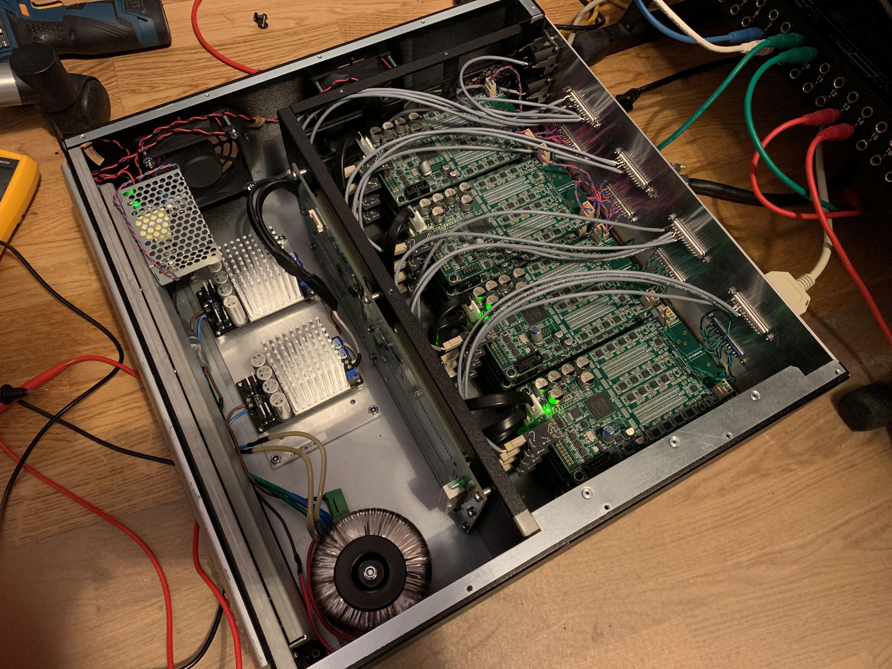

I used an old AVID case for it. Put the active cooling back with the fans running at a very low voltage. 16 DAM1021 together in a case do produce some warmth. 🙂
16 channels... oh wow. Is that for DIY or (semi-) professional use? What are you driving / is its intended purpose?
I still don't understand how the output op amps in the DAM1021 are powered. It appears the voltage is always only slightly below the incoming DC voltage. That would be fine with a quality PSU powering the DAM, but how can there be clean DC with AC input only?
It is primarily for use with a large format studio mixing console.
I'm not sure I understand your question. According to the manual there's a full wave rectifier bridge for AC/DC conversion. It increases voltage by sqrt(2) minus a couple of volts for the rectifier loss. Then I assume it is regulated down by dropping voltage over LDO's.
The linear regulators I have used all have a frequency that is either fixed or can be set by a simple surrounding circuit. What is on the DAM1021 appears to drop the voltage to a level in relation to the incoming voltage.

Or are you saying it seems to bypass the power regulator?
You guys are not the only pathologically lazy ones. I also cannot be bothered to take a continuity tester to the dac 😀
Never wondered how those opamps are powered but in my defense they were the first parts to leave the board with one way tickets.
Looking at pics of the pcb it looks like there is indeed no regulation: raw dc seems to be powering those parts. No biggie.
