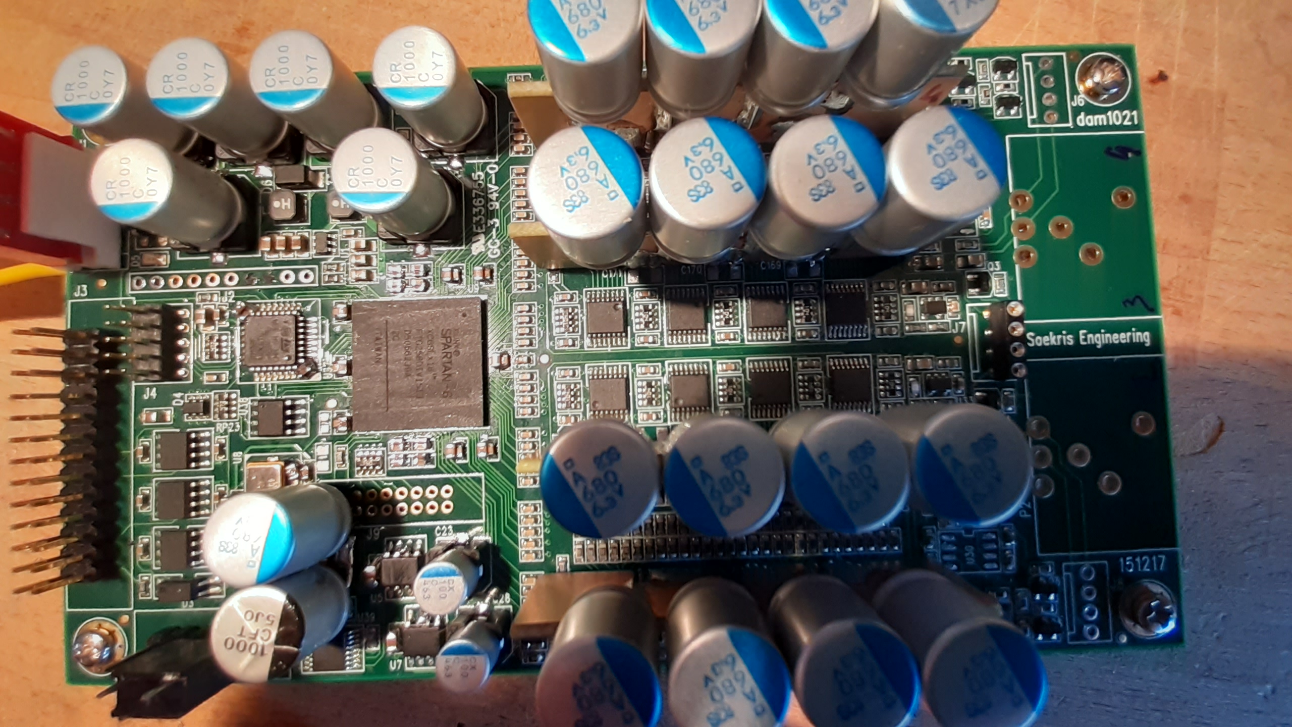

Merci les gars 🙂
Just pay attention to cap polarity and max voltage 😉
An easy mod is adding some capacitance to the clock and the vrefs.
Use a very good regulated power supply for the DAM and also for the USB interface.
If it's a V1 you definitely need to do the lowresmod or the transistormod for the vrefs.
Regarding the "Low Res Mod 499R/0R/0.01R" for REV 1 board, do you leave the 22 uF output capacitor alone or parallel it with 47 uF as in the factory mod?

Without the simple cap upgrades, I wouldn't do anything else. This is after all (today) the low end of the Soekris-series, but with still quite some potential under the hood if you are really DIY. Safe the money for fifo's and stuff and get a dac upgrade if you really want to buy someting. Just my 2c.

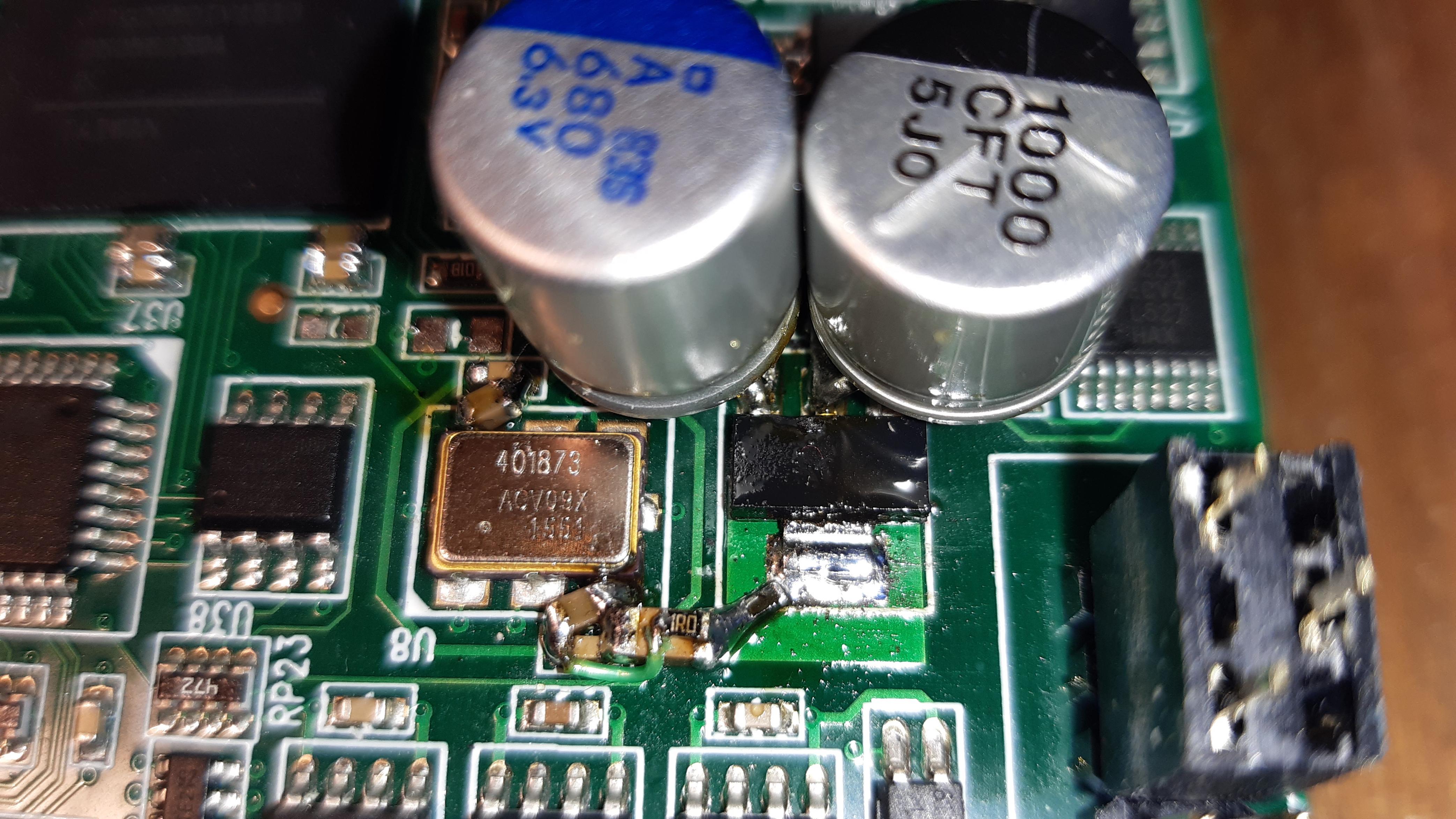

The 3.3V regulator (SPX1117) does supply the clock as well as the shift registers - right?
So far I only tried to add polymers for decoupling VOut:
On the one hand directly at the regulator (or rather on top of the adjacent ceramic cap). This does wonders to improve SQ.
On the other hand locally at the shift registers. I tried various configurations (4-12), different caps etc. Never liked it, always got a somewhat muddier output.
I didn't look at it with a scope capable of properly measuring 40 Mhz and beyond though. Was decoupling of VIn necessary to get the improvements you are showing? Then I will try that.
Also, the balanced output stage in the latest revision is really good - but it doesn't get on-board regulation. You need to feed the DAM1021 very clean low impedance power and use a proper thick (low impedance) ground cable to the PSU of around +/-10V. Too low voltage doesn't sound good, too much will create to much heat and other problems down the road.
Also make sure all the homework in the grounding department is done (PSU directly to chassis, XLR outputs pin 1 to chassis, no other DAM1021 PCB chassis connections.
Thanks, Berny!
No, the shift registers get their supply from the +/- 4V Vref
But there is 1 3.3V regulator feeding the mcu, oscillator, isolators, I/O-banks of the FPGA, etc... so allready very noisy to start with. I still use only that same single regulator, but removed the RC feeding the oscillator on the FPGA-side and made a new rcrc filter starting from the regulator tab (also 3.3V) straight to the oscillator. So I use the 'cleaner' side...
