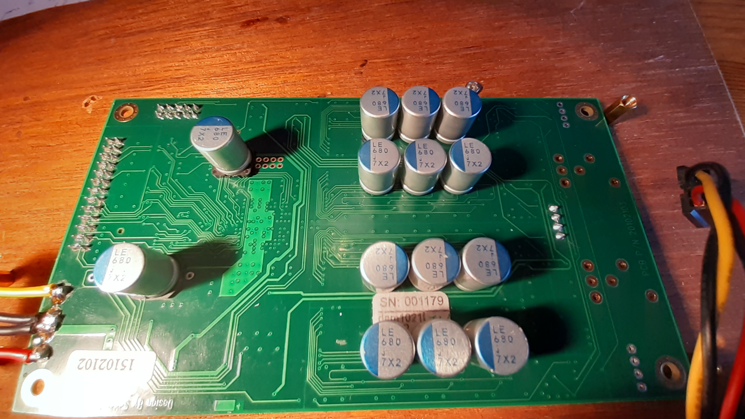

Got the 1000uf 16V polymer caps today and implimented one decoupling the 3.3V regulator input. Obvious improvement, sounds more real, detailed and clearer bass punch. Cheap and easy ugprade. This and a 1500uf 6.3V regulator output decoupling cap are mandatory IMO.
I looked at the data sheet of the 17L33 regulator, I suppose it is the NCP1117 from ON. You see page 6 fig. 12 that there is indeed a risk for instability with the way it was used in the DAM. Data sheet advices 10uF at input and output and care for the minimum impedance... increasing the Cout above 100uF should deal with that issue once and for all. Personally I would also increas the Cin at approximately the same value. I don't understand Rev7 does not include some more capacitance around that regulator (there was space to do it), but the oscillation issue seems to be dealt with by increasing the trace-length between Vout and Cout by a little loop 🙂 I have myself 680uF and 1000uF directly on the regulator and it is indeed solving all issues and decreasing noiselevel on the 3.3v powerplane. In the end I have 3 x 680uF on the 3.3V powerplane with very good results.
Another interesting change I see on rev7 is the increase in pre-regulator voltage for Vref. It was 5V and now increased to 5.4V... important changes to get 'only' 0.4V more. Does the DAM2541 use the same Vref opamp? Anybody an idea why that additional .4V would be necessary or does it just give the opamp some more headroom & performance?
Low end sounds quite different with the VIn cap added (Vout cap had been added long before). There was always a little bit bass missing with the DAM1021, but this rectified it.
Where did you place the other 3 680uf caps?
I implemented both, Cin&out at the same time, but I mixed-up the high and low voltage caps between Vin en Vout.. so I have the 6.3V polymer on Vin at 8.5V for now.. 🙄 not a long term solution..
I inserted the other two caps on the bottom of the board, as close to the board as possible (with an smd-cap plastic spacer to avoid shorts) on J9 and J2. I'm rather confident, these connect directly to the right powerplanes for 3.3V without too much trace in between.
