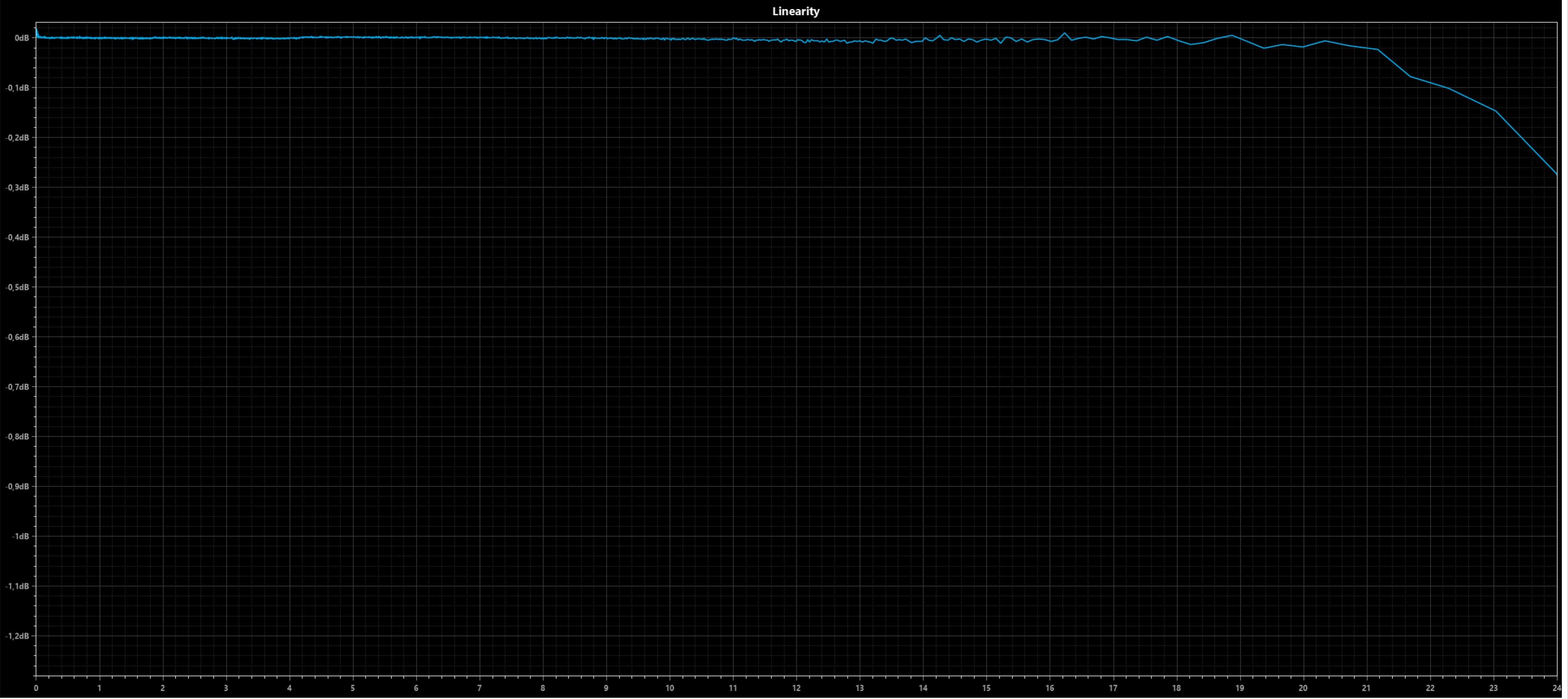

Here's an example of the incredible linearity the DAM1021 is capable of (measured with a Prism Dream AD-2).
It looks like this if and when you are lucky to catch a period of low drift.
The clock drift issue really is an insult to the quality of the converter and the Soekris customers. Soeren, are you ever going to fix this?

If it were only wow and flutter - no. But we established with a 1/4 sample frequency test tone that something else is going on. It's hard to reproduce and measure at the same time, but I do think it may be audible as signal degradation, and I have an idea multiple passes through the DA AD sound different depending on drift. You can see the difference in waveforms carrying musical information, samples do not line up with the shape of the waveform as long as drift is high (corresponding to distortion in the 1/4 sample frequency).
Theoretically there is option to stop small clock constant change around the target frequency by putting on hold I2C communication with bringing SCL low.
Assume we have very good clock just before i2s input ,after initial adjustment of dac si514 to that clock only small updates overshooting target are send so if we temporary put on hold this communication we will have stable clock. Critical is how close to target dac clock was set.
The dam1021 adjust its oscillator with an accuracy of 1 Hz, it don't have anything to do with drift. The oscillator will adjust as needed, but can never hit exactly the frequency of the incomming sample rate. It have been explained multiple times since 2014, please read the whole thread 🙂
The adjustments happens in a interrupt routine, so If you want to test without updates, just enter uManager, updates then stop.... But I doubt that anybody can hear it.
