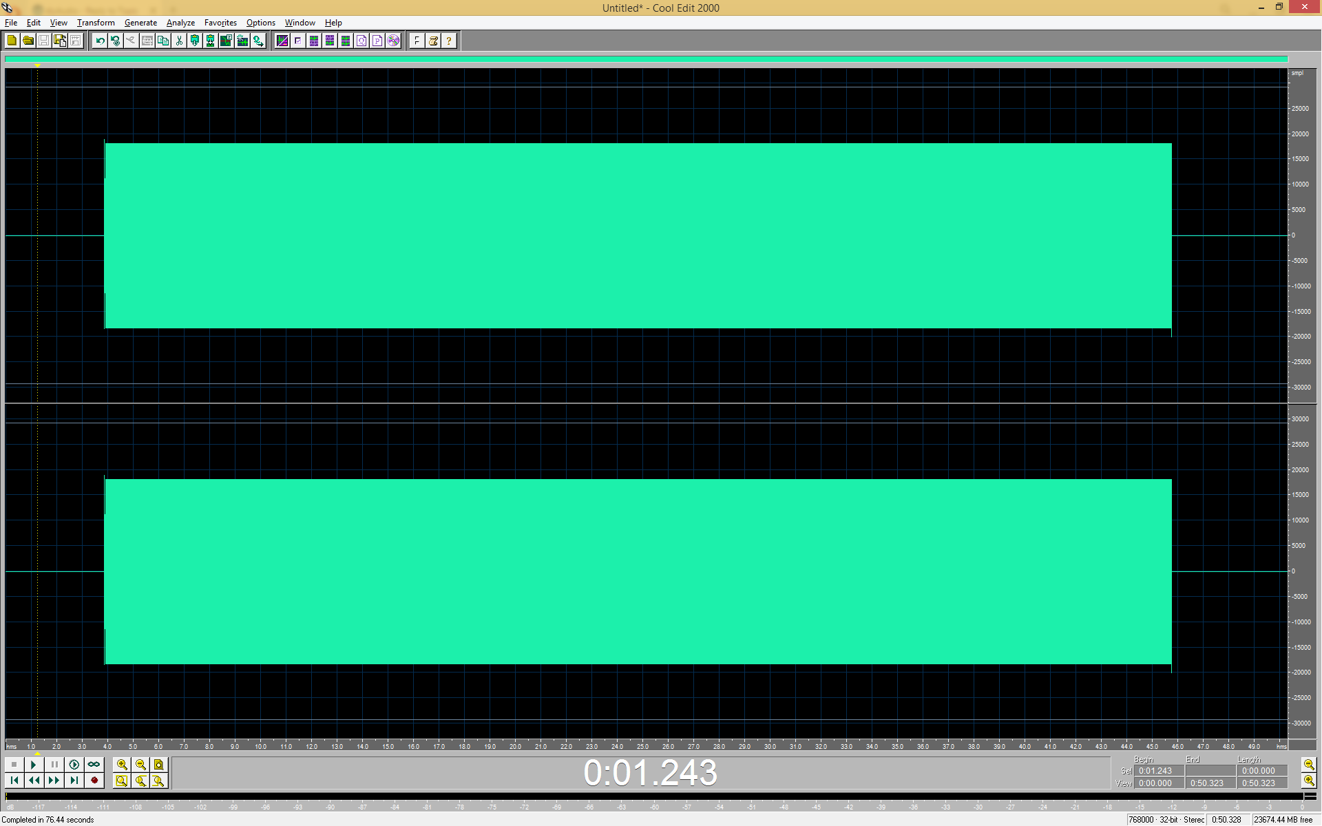

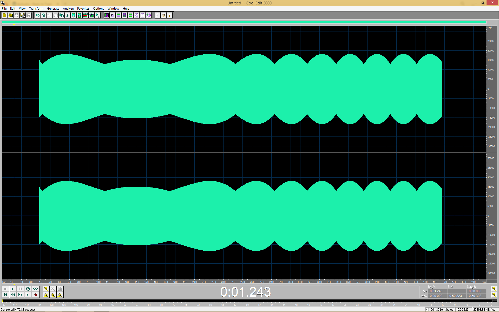

I generate a sinewave. At 11025 hz the DAM1021's amplitude is unstable and varies down to -3 dB peak (RMS is the same) from the target amplitude. This corresponds to the signal looking like a triangle at maximum and a clipped triangle (of lower amplitude but identical RMS value) at minimum.
The AD converters and the DAM1021 all use the same master clock. Other converters with and without sophisticated re-clocking hardware don't show this behaviour.
It has nothing to do with the AD converter or it being one the same clock as the DAM1021 or not. The DAM1021 does this on its own.

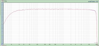

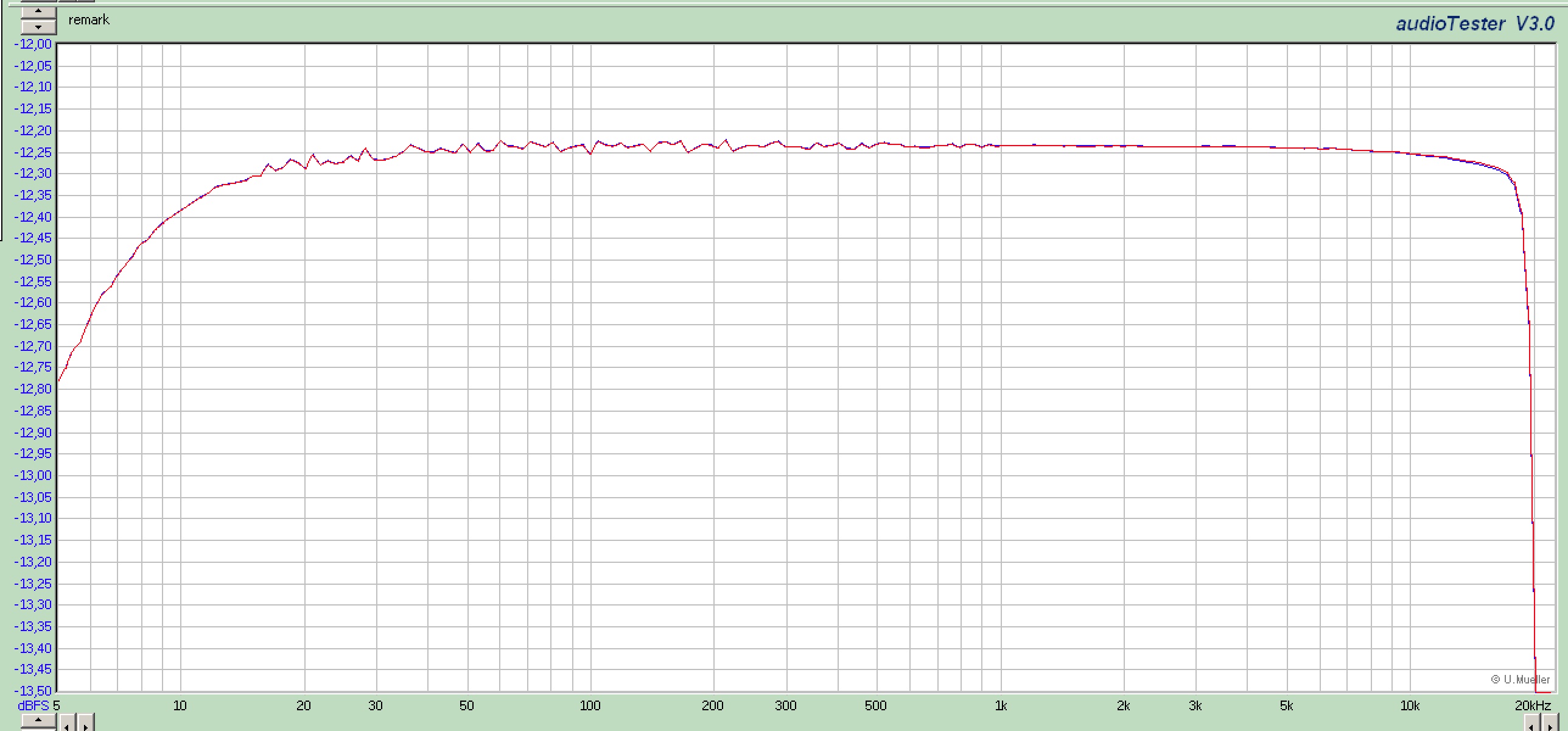

At 44,1 the DAM with the filter I presume living sound is using, looks like this:
Measurement thanks to zfe!!
RMS is the same because the DAM1021 amplitude does not actually vary. I attached a screenshot of the first 50 seconds of your 11025.wav recording at 44100 Hz and HQ upsampled to 768000 Hz (this is a correct operation because of near-ideal ADC filtering). As you can see, the actual peaks have constant level.
Soeren may describe it better than me but judging by what he said already DAM1021's DAC section is never locked to your master clock in any way, it always uses its own clock not derived from anything and constantly adjusted by 1 Hz according to FIFO fill.
It is inavoidable if the reclocker uses an independent programmable oscillator. Such oscillator will almost always have small frequency difference with the incoming clock, less than its adjustment step.
