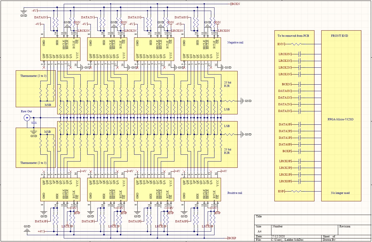

Again, please read carefully:
"Using 2 separate ladders for each channel (one for the positive and one for the negative rails, that's the sign magnitude notation), you can add 1 bit of precision, to reach 14 bit."
So with sign magnitude notation you add 1 bit of accuracy (or monotonicity if you want) but the math is the same.
Please, take a look at R2R DAC INL and DNL.
But if you are so sure, you shouldn't had any difficult to mathematically demonstrate what you are claiming.
You can calculate the THD using a spreadsheet.
The DAM1021 ladder schematic could help you to do the math.
Soekris uses 0.01-0.02% resistors,
so in a pure R2R DAC that gives about 13-14bit precision (1/2^13=0.00012*100=0.012%)
13 bit has SNR of about 78dB
Still Soekris manages to get about -110db on the analog output, which is 18bit.
This should be impossible according to you reasoning with 0.01 resistors.
This extra resolution that you get is due to the sign magnitude design.
I'm still waiting for your math to demonstrate what you claim, words are not math.
As I said you can do the THD math with a spreadsheet and the schematic I have attached can help you to understand how a Collinear DAC works.
I'm waiting for an explanation of your claim that the DAM1021 with 0.01-0.02 resistors should only have 13bit 78db resolution, bust still manages 17bit 100db
You are still confusing resolution wit precision (or accuracy or monotonicity), which are two totally different concepts.
As I said previous, please take a look at DAC INL and DNL to understand.

Maybe because of 64 times oversampling which gives additional 3 bits. 14+3=17
That’s why I ask Soren about dam1021 rev.7 FIR2 and shift registers sample rate change.
Oversampling - Wikipedia

It's more to do with the oversampling. Same idea behind sigma-delta, just applied differently. Also, there's THD, IMD, SNR, INL, DNL, that all contribute to ENOB. I assume the last two aren't too great for this design, but for audio (no DC levels), that's no concern.
