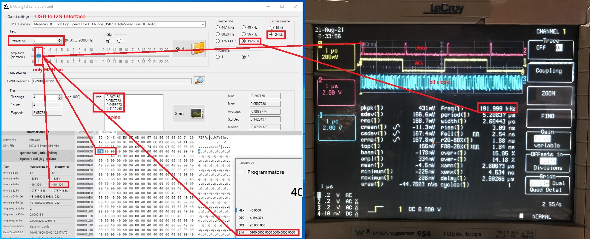

DC samples issue
Hi Soeren,
I'm trying to play some DC wave samples at different amplitude with my DAM1021 but I didn't succed.
The attached picture shows a DC wave sample 192kHz/24 bit where the MSB only is on (Big-endian 24 bit signed 4194304, hex 400000, binary 010000000000000000000000), please see the scope screenshot.
I expected to measure around 1 Vdc peak at the raw output of the DAC but I get noise only.
Is it due to the filter?
Is there a workaround to play the sample bit perfect?
Thank you
Andrea

There is a high pass IIR filter used in all the stock filters.
Here is an edited version of a filter file with DC filter removed, you need a serial interface to upload it.
How to load custom filters for Soekris DACs | Super Best Audio Friends
I had to change extension to .txt to upload it here, it needs to be changed to .skr
For something closer to 'bit perfect' you might want to use the 'NOS' filter instead to avoid any attenuation and keep the original sample values.
If you ask in filter brewing thread someone should be able to provide a filter file with the NOS filter and without DC filter.

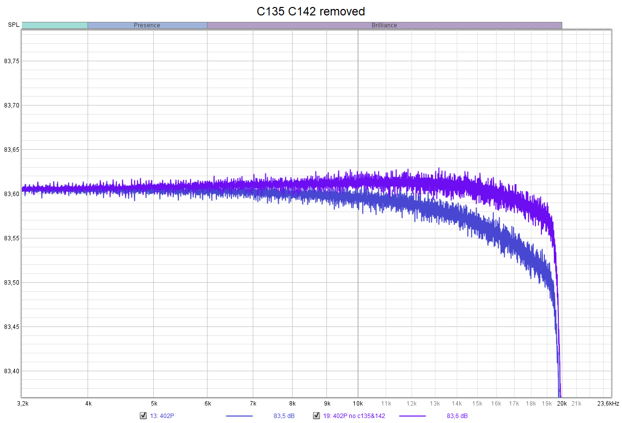

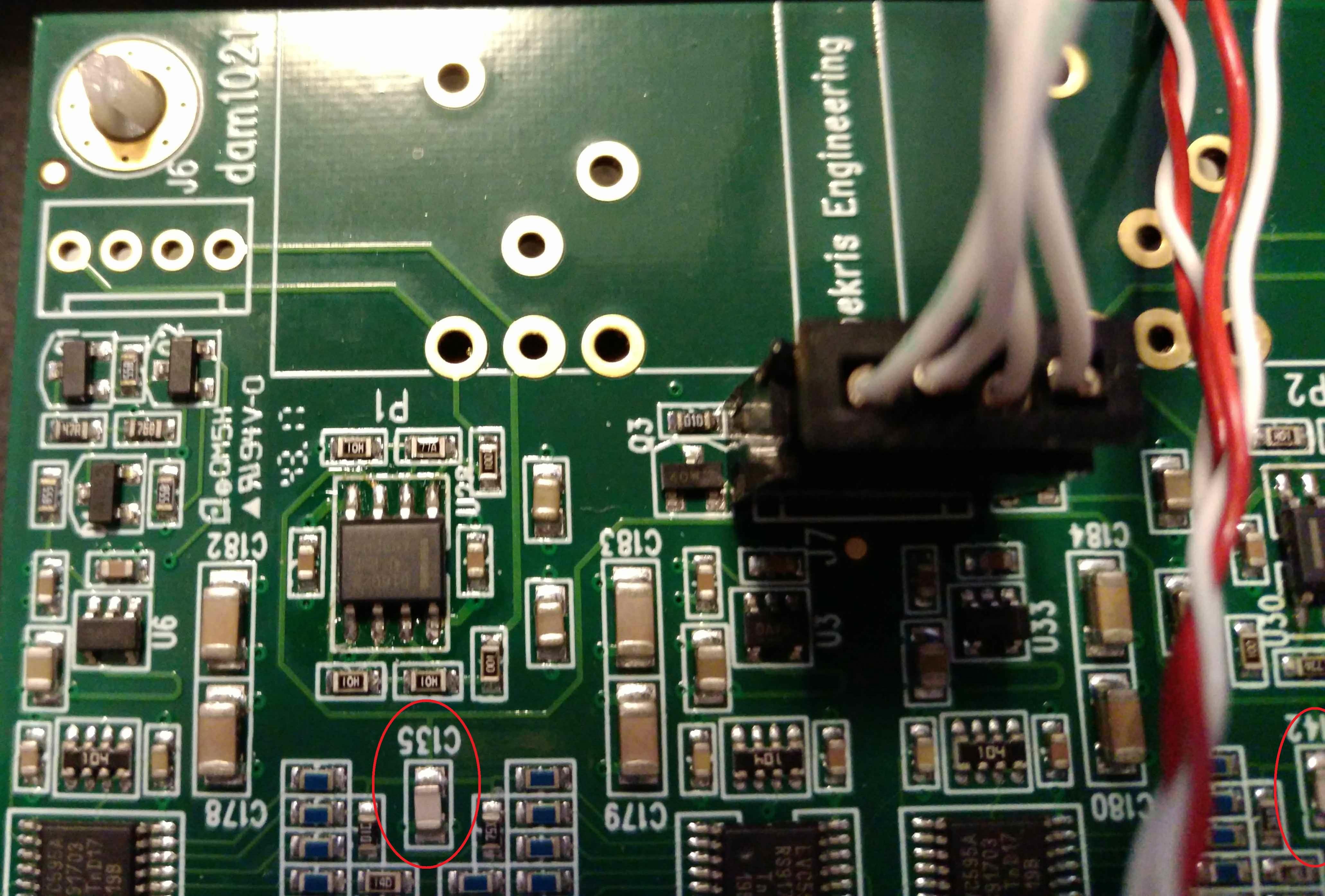

Is that an output coupling capacitor that is directly in the signal path? Or part of a low-pass output filter that connects signal to ground?
it's part of low-pass RC filter on ladder output.
as stated by Soren
C135 and C142 are 1500 pf NP0 ceramics, together with the 640 ohms impedance from the R-2R network they set the -3 dB 165 Khz point of the RC filter.
as stated by Soren
Thanks, that's what I thought. I had also seen some mention/complaints of output coupling caps, but couldn't actually work out where they might be in the circuit. So confirming these are just filters, and have seemingly very little influence, is reassuring.
(Also worth noting that on rev7 boards, the equivalent caps aren't labelled. But it seems obvious which caps they are, right between the two polymer caps on each channel.)
