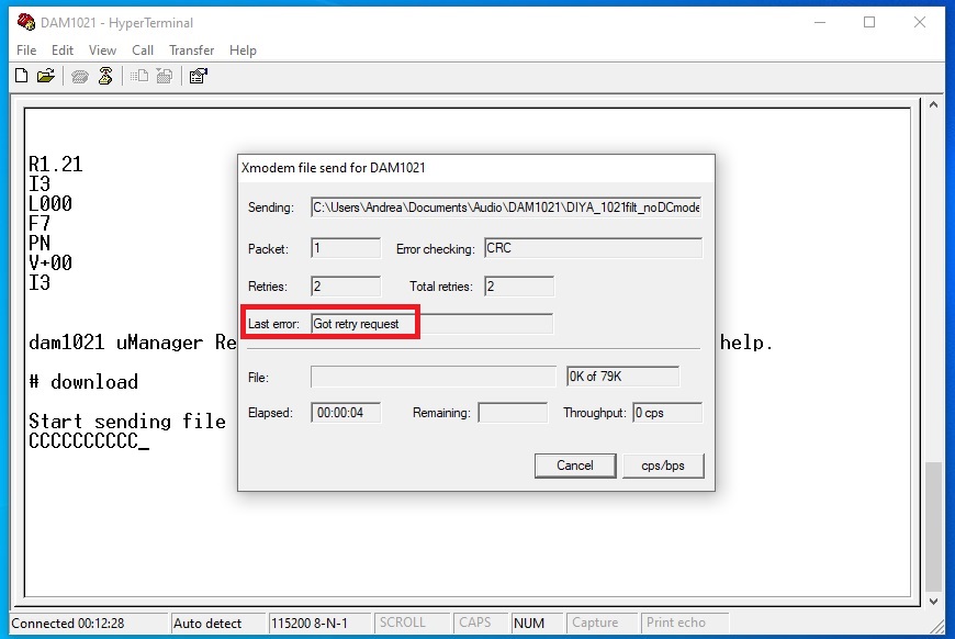

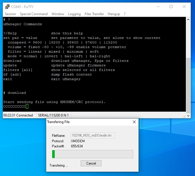

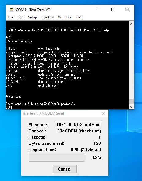

Finally I got the USB adapter working via J3.
I get the uManager and I'm able to download the filter but:
- using Tera Term the data are not sent because file transfer starts and freezes
- using Extra Putty file transfer never ends, it restars as soon as all the packets are sent
Any help?

When using Putty try Flow control : none
Alternatively look for hyper terminal binaries from older Windows versions.
Last resort toggle between XMODEM 1K and XMODEM and setting slower connection speed
Thanks for the tips but I have already tried (hyper terminal aside, I don't know where I can find it for Win 10).
I wonder if there is a way to update the filter, I have already tried 3 USB adapters without success.

I have followed the manual, I have tried by J10 and J3, with Tera Term and with Extra Putty, I have tried 3 USB adapters.
NO success anyway.
Can you please tell me where is the problem?
Or the succes is random?

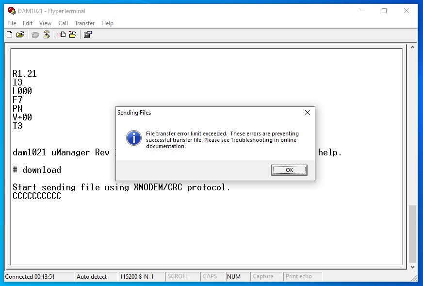

Just tried with Hyper Terminal, no way to transfer the filter file.
Well, seen you are so smart, please let me know what I have to do to transfer the filter file.

Please choose whatever hardware and software you want and let me know how I can succeed updating the filter.
If its was so simple surely you can tell me what I have to do.
There is also very popular SiLabs CP2102 chip, I used some generic converter based on it with zero issues so far, 1121 and 1021 rev 7 work all right, including custom filter uploading.
if I remember correctly, after typing the download command you only have about 10 seconds to send the file.
So do you think I have to buy the fourth adapters?
3 are not enough?
I remember I have read 30 seconds somewhere however I send the filter file within a couple of seconds but the process fails.
