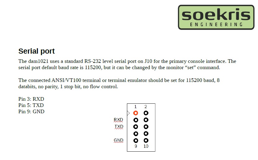

Fortunately the user manual is very detailed and all modern PC have RS232 port.

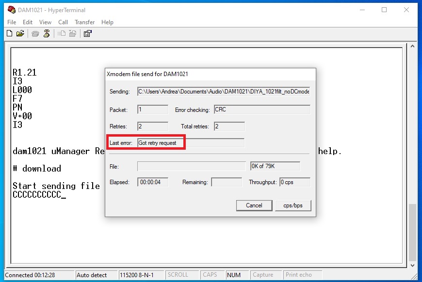

Anyway, thank you for the reply, but:
- I have already checked J10 solderings but ther is no way to get one of my 3 adapters working
- TX and RX seem to work via J3 as in the attached picture
- I'm able to invoke download command (Hyper Terminal screen attached)
- no way to download the filter by XMODEM or XMODEM 1K file transfer. Hyper Terminals says "Got retry request"
So I assume the communication between PC and micro works correctly but Xmodem transfer file fails.
I could check with a scope as you have suggested, but for what purpose?
The communication is settled correctly so I assume I would see correct signals on the scope.
The problem seems to be related exclusively to the Xmodem transfer file.
Maybe a protocol problem?
I have used exact same firmware on thousands of boards, also before the dam1021, so lets assume the firmware is good.... Then there is noise or your PC. Try Xmodem 1K or a different/clean computer, you might have software interfering, who knows.
I have tried Xmodem and Xmodem 1K, I have tried with a pair of PC, both running Win 10.
Tera Term, Extra Putty and Hyper Terminal.
Can you please tell me if there is something to configure software side or hardware adapter side?
