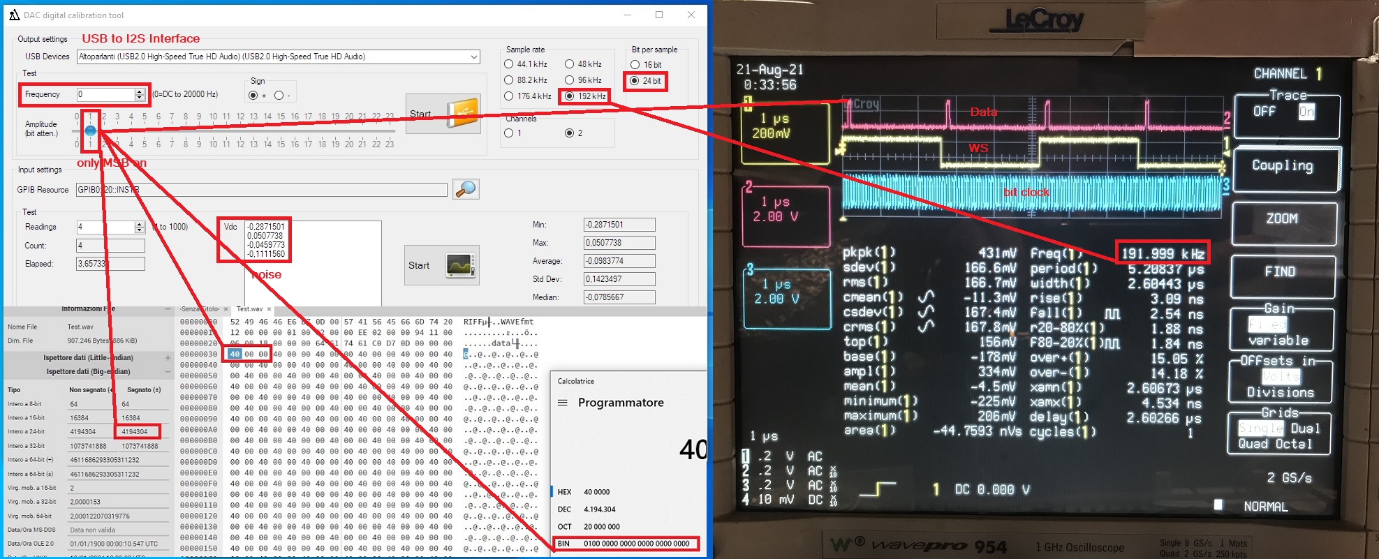

I own rev3 board and I'm trying to use TNT NOS filter without DC HP because I have to play bit perfect DC samples
Filter brewing for the Soekris R2R
So the problem could be the filter file?
So it's your own file, maybe verifying your setup with a known good filter file....
You have not replied, what does mean OS with DC sample since the word is always the same.

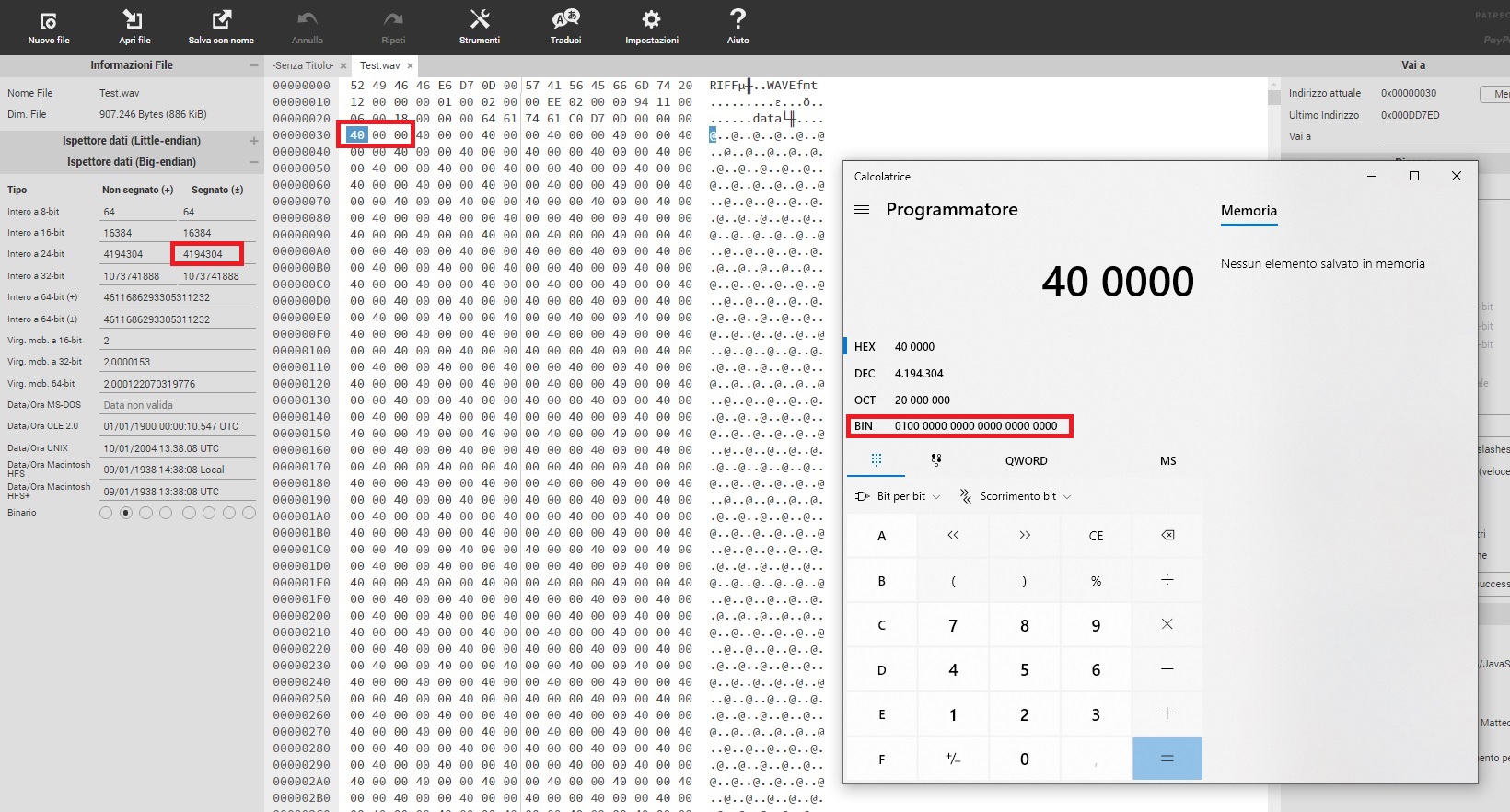

24 bit Hex 40 00 00 means half power, only 23th bit is on.
The wave file contains the same sample 40 00 00 from the beginning to the end.
What does happen to this word with your OS?
You don't make any sense. I can not understand what you write.
Oh, it seems to me the question is very clear.
However I attach a picture so you can better understand.
As you can see the wave file contains the same word from the beginning to the end: hex 40 00 00, bin 0100 0000 0000 0000 0000 0000.
Is this clear?
Only the 23th bit is on as you can see on the scope.
It's the I2S data, is this clear?
This means DC at the output of the DAC, assuming the DAM1021 raw output is capable of 1.4Vrms when all the bit are on, this means 1.9796 peak Vdc at the DAC output.
Is this clear?
If all the above is clear then the question isc clear.
What is the output of the DAM1021 with the above sample and your filter?
Does it provide constant 1.9796 VDC at raw output if you measure it with a DMM?

He writes his intentions in #10351. I don’t know if the pseudo-NOS filters will do as he wants, because obviously the dam is always oversampling in the MHz range but Andrea already knows this. Best he can hope for is that the coefficients are such that after OS the bits are again what they were on the input. gumisb’s latest F5 filter would also be a good candidate to test.
