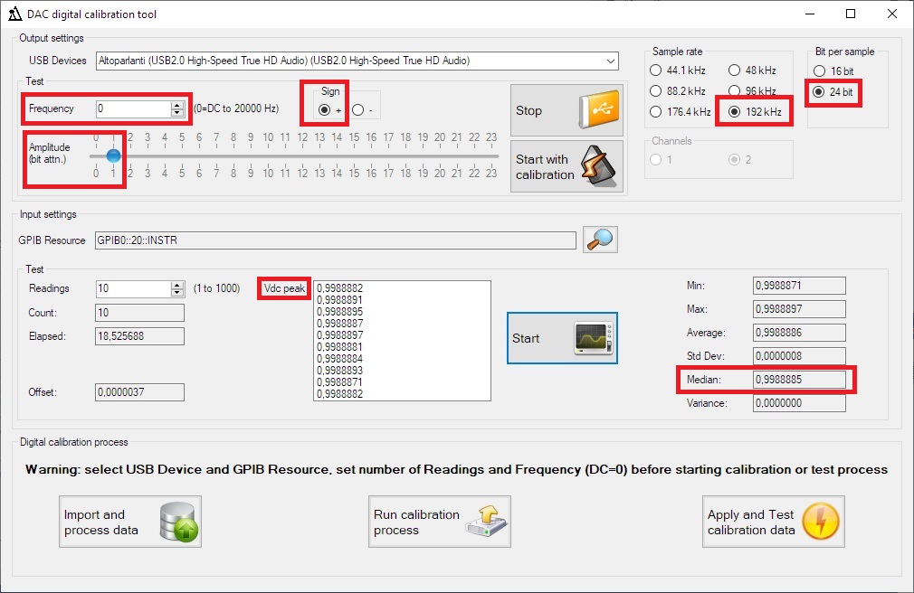

Succeded.
Finaly I have solved the issue using an old PC with built in serial port.
So I have loaded the NOS filter kindly provided from koala887 (thank you).
The only issue is that I have bought 3 adapters and none of them has worked.
It's not simple to find and old PC with serial port because modern PC does not provide such port.
So I would suggest to implement a USB port on the next revision of the DAM1021 because all modern PC has one and the communication it's much simpler for the user.
The filter works correctly as shown in the attached picture.
I'm able to play pure DC sample, indeed I have measured around 1Vdc peak at half power, only 23th bit switched on.
Now I can measure the accuracy of my DAM1021 to calculate the digital calibration in order to correct DAC linearity.
Thank you all for your support.
