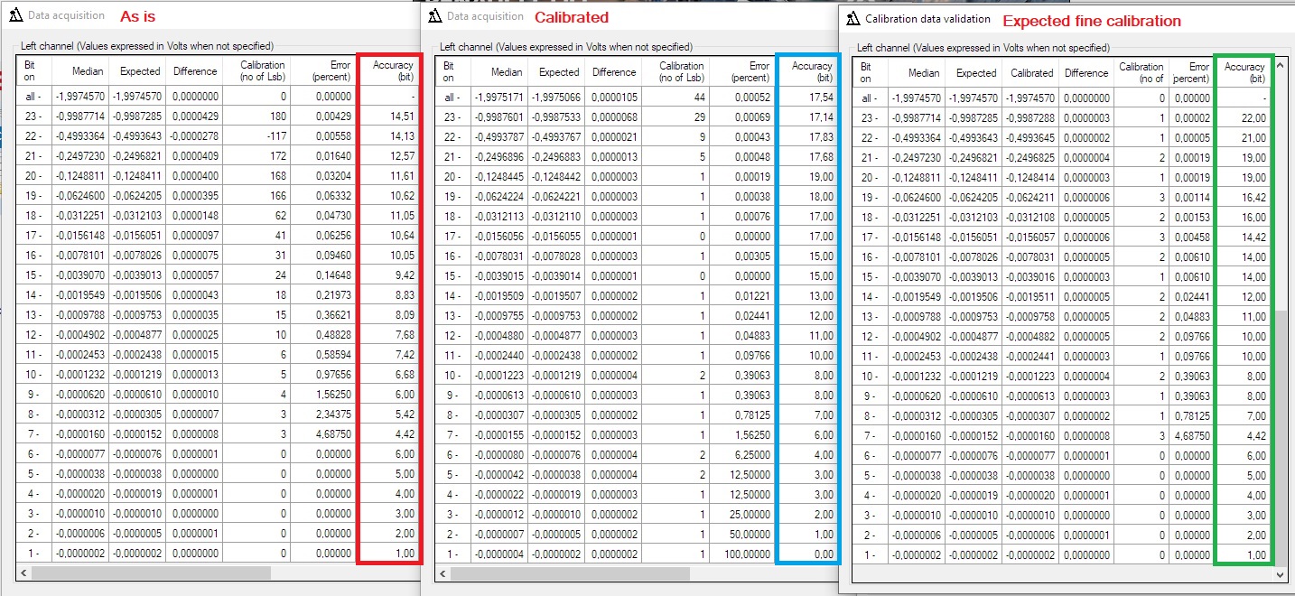

DAM1021 accuracy measurement
Although I have not found the way to get my DAM1021 playing bit perfect I succeeded measuring its accuracy.
I have used the filter provided by koala887, volume is set to -99, potentiometer not installed.
I have sent DC samples to the DAC to measure the voltage at its output for each sample, from full scale (max output) to LSB, dividing by 2 every time.
I expected only one bit switched on for each DC sample but unfortunately it's not so.
I have cheked each bit with a DMM and the bits are not switched on as expected according to the 24 bit word I have sent to the DAC.
I don't know if the issue is related to the filter or to the digital volume processing, I have asked several times but unfortunately the designer did not help.
This issue does not affect the accuracy measurement because the DC samples are scaled dividing by 2, so every division one expects to get half voltage at the output:
- all bits on, 24 bit word max decimal value, expected max output voltage
- bit 23 on, 24 bit word is 4194304, expected full scale / 2 output voltage
- bit 22 on, 24 bit word is 2097152, expected full scale / 4 output voltage
- and so on until the LSB
Unfortunately this affects the calibration because to get a fine correction one would need to measure the contribution of each single bit (each resistor of the R2R ladder network) to the output voltage.
This means switching on one bit only (single resistor) each time to measure its own contribution.
Since I have not found the way to get the DAC playing transparent this was not possible and so the calibration is not perfect.
I attach the result of the accuracy measurement which is in the grid named "As is" of the first attached picture.
Measurements are scaled dividing by 2 from full scale (all -) to LSB (1 -).
The column Median contains the measured output voltage, the column Expected contains the expected output voltage of a 24 bit DAC with perfect accuracy, the column Difference contains the deviation between measured and expected voltage, the column Calibration contains the correction needed to get perfect accuracy expressed in number of LSBs, the column Error contain the percentage deviation between measured and expected voltage, the column Accuracy contains the actual precision of the DAC expressed in bits.
Although many have argued that sign magnitude architecture will improve the accuracy of the DAC the measurement confirms the theoretical culculation based on the resistors tolerance used in the R2R ladder network.
Using 0.01% and 0.02% resistors tolerance you get around 14 bit accuracy, more or less depends on the combination of the resistors error in the ladder.
This is confirmed by the THD measurement: 0.006% THD means -84dB which means 14 bit (14 * 6 = 84).

Then my DAM1021 is a 24 bit resolution DAC (28 bit if you consider the room for digital volume control) but it's also a 14-15 bit accuracy DAC.
When calibration is applied the accuracy improves as in the grid named "Calibrated" which contains the measurement after the correction was applied to each bit.
Unfortunately a fine correction is not applicable because of the issue I have mentioned above.
The accuracy improves up to 17-18 bit but not up to 22-23 bit as expected in the grid named "Expected fine calibration", which would need the measurement of the contribution of each resistor in the ladder to the output voltage.

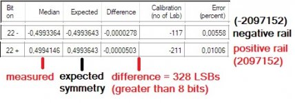

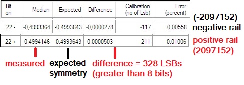

Finally I suspect there is something wrong in the math calculations inside the FPGA since the measurement indicates there is no symmetry between the positive and the negative rail of the magnitude architecture of the DAC.
I don't know if it depends on the filter I have used (I don't believe), but I have measured a wide difference between the positive and the negative rail when the same magnitude was applied to both rails.
The second picture shows the difference I have measured between the positive and the negative rail playing the same magnitude with opposite sign.
Since the magnitude is the same one expects perfect symmetry between the positive and the negative rails of the DAC, while I have measured at least 8 bits of difference.
Since I didn't expect such asymmetry I have checked each switch of the positive and negative when playing the same magnitude and to my surprise I noticed that the same bits are not turned on in both cases.
The switched on bits were different between positive and negative rail when the magnitude were the same.
This is very strange to me, maybe the designer could explain where I'm wrong.
