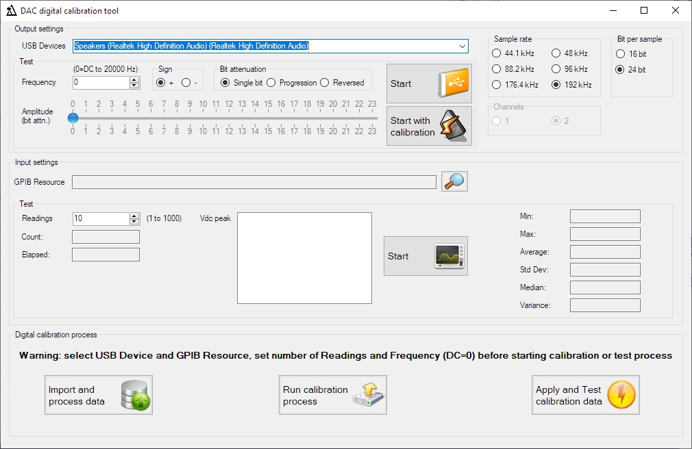

What I actually hoping to achieve?
I thought it was enough clear, I'm testing a system to calibrate R2R DACs.
My DAM1021 is a R2R DAC, is this a problem for you?
DC is completely unrepresentative of music, are you sure?
So the red lines in the attached picture are not DC?
However I have performed the measurement even in AC and the result is the same.
Only my DMM is a little less accurate in AC.
Then, if you know how a R2R DAC works, it should be clear for you that the best way to calbrate its precision is measuring the contribution of each resistor of the ladder network to the output voltage.
Is this clear?
Finally, 17 bit it's not impossible, around 10% of the production statistically will provide 17 bit.

The goal of the calibration is just to correct the nonlinearity of the switches and the resistors in the ladder of the DAC.
I believe I would get better accuracy if I succeeded measuring the error of each single bit (switch + resistor) but unfortunately I have not found the way to get my DAM1021 playing bit perfect.

Maybe you have not understood, I meant the DAC digital calibration tool I'm testing.
It's just software and I will release the application for free.

You are wrong, I will also release the dotnet source code.
The Windows application will be in public domain so everyone can adapt it to their DMM and USB to I2S source.
The application contains the algorithm to apply the calibration, so everyone can code his DSP to manage whatever DAC you want.
The algorithm could be even applied in software writing a suitable audio player wich implements it.
I have used Naudio library and it's very powerful.
I will not write the audio player.
But of course no support, I have not enough free time.
