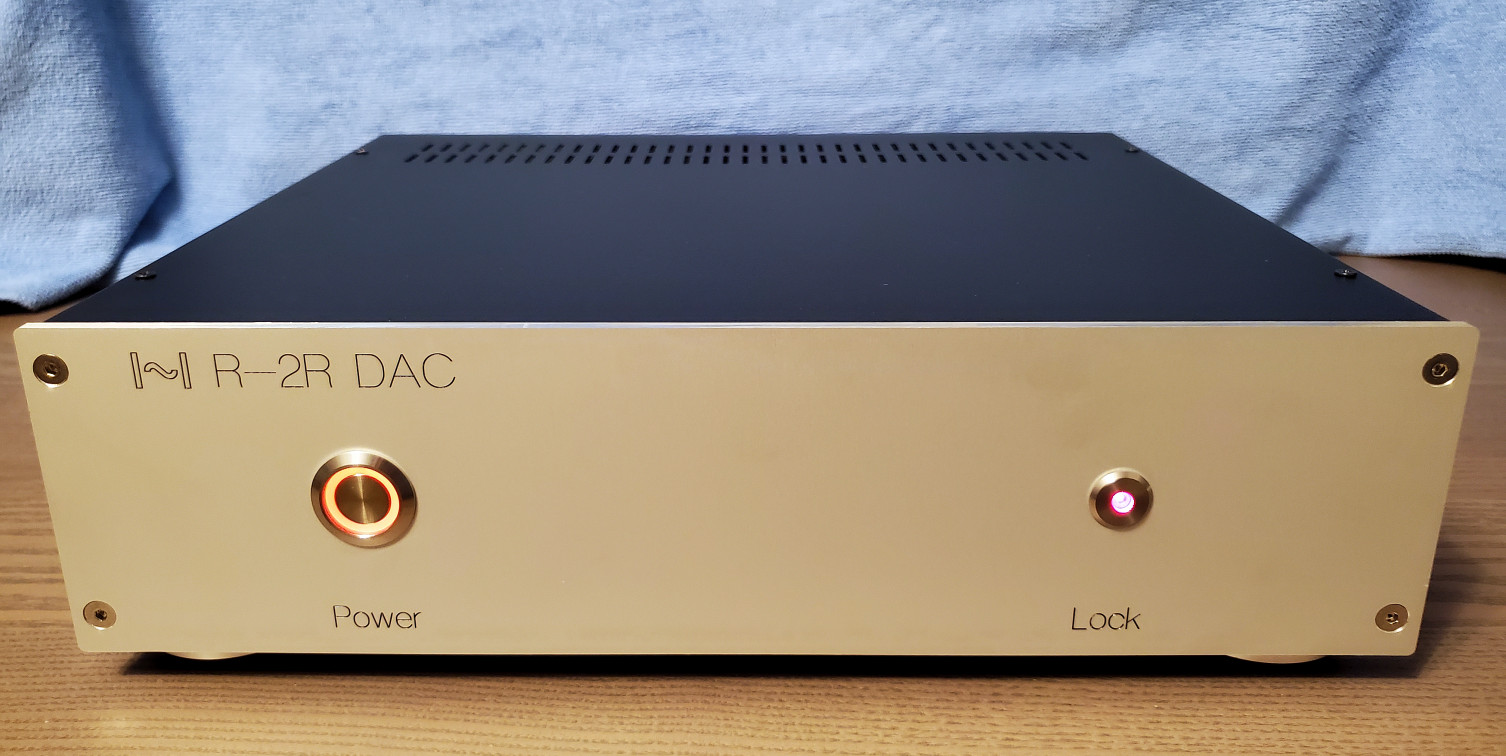

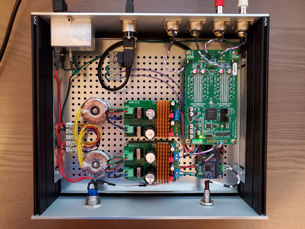

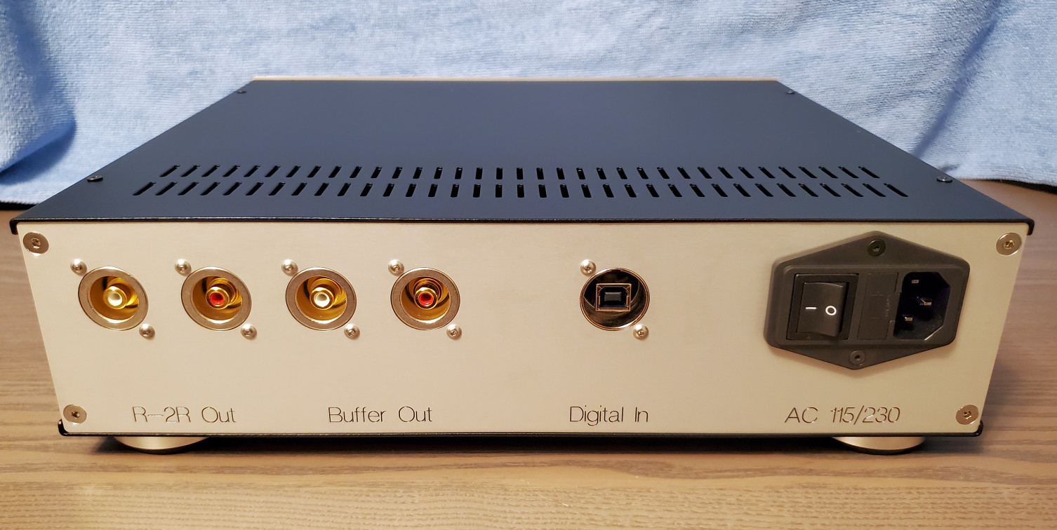

Anyway, moving right along. Nobody has posted their build here for months! I finished up my dam1021 rev7 build a couple of weeks back, so here it is.
Deliberately minimalistic, I almost called it "Singular Purpose". HiFi2000 case, FPE panels, JLSounds I2SoverUSB v.III input, DIYinHK LT3045-based power supplies, direct R-2R output intended for my headphone amp, and buffered output for my powered desk speakers. Sounds bloody marvellous, I feel no need to modify the board in any way.
My only regret is that I didn't add a second USB input and leave the USB/serial adapter connected internally for filter testing. I could add a small USB hub internally, but it would defeat the isolation provided by the I2SoverUSB module, which is essential given how damn noisy my computer's USB is.
So Søren.... thanks for your design, your patience with the community, and for the ongoing and continual upgrades over the years!

Nice build, thanks for the nice words, happy to see somebody still building instead of just creating noise....
You could use the isolated serial port with an interface and a hub, keeping it on the noisy side....
