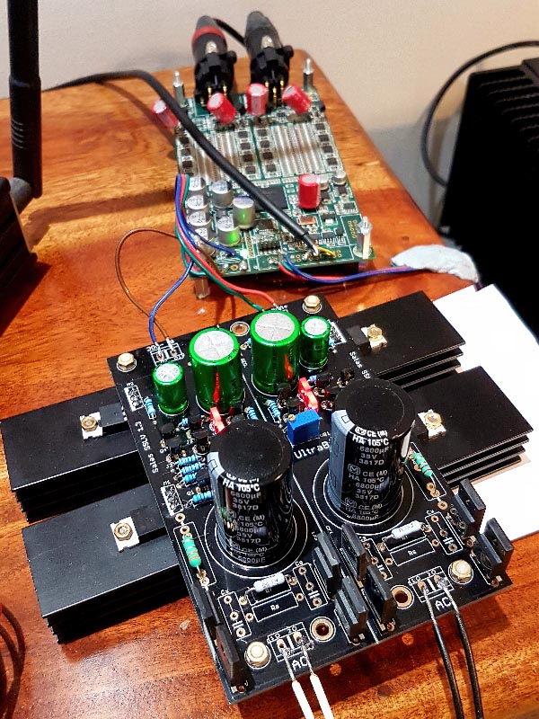

Can i please learn your r core connection experiences for power supply?
I have 4 transformers in my dac as they supply separated dc voltages to different parts. No opamps. Several Salas regs. The important +5v "analogue" line is supplied from the heater output of an R-core designed for valve preamp duties. Compared at least half a dozen transformers for this spot and R-core beat them all.

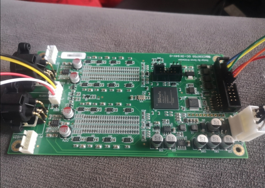

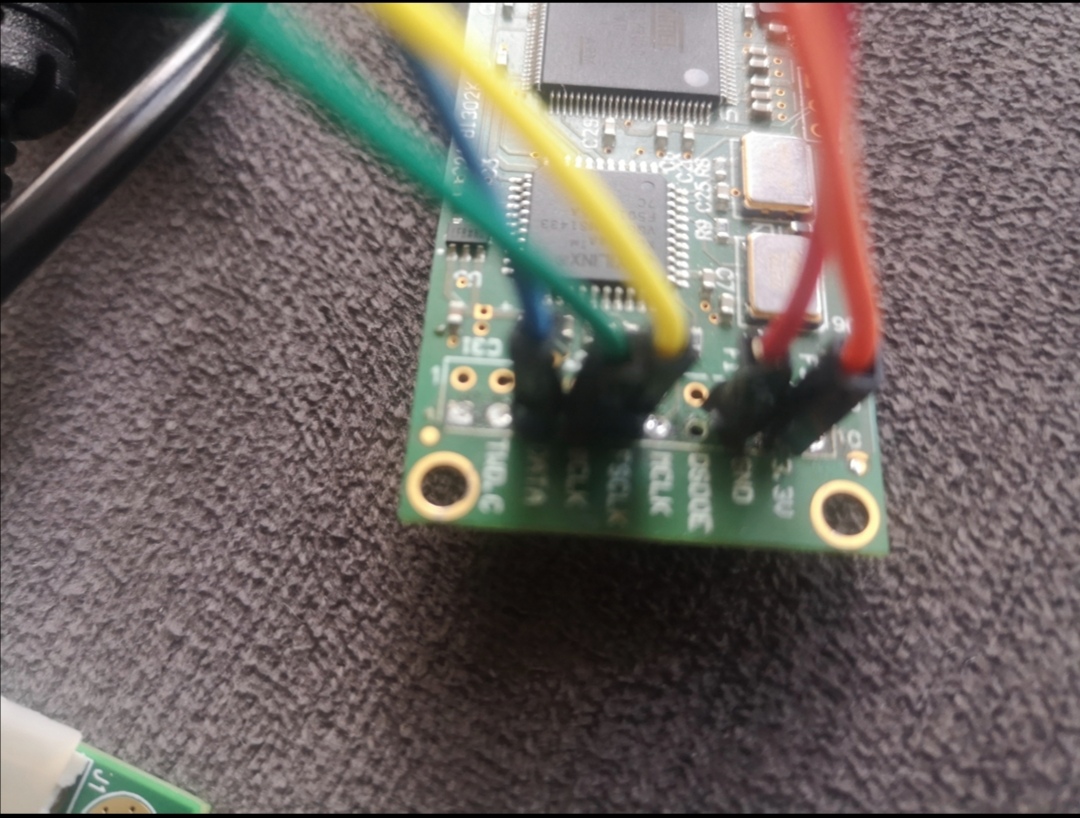

Thanks for your reply, i have bigger problem than transformers now. 🙂 I cant get sound from dac.
Hi all, i finally got my dam1021 and made all connections using 12dcv power supply, amanero i2s and raw output. I've checked j2 header, all voltages are ok. Green link is stabilised while amanero connected via pc. But unfortunately i dont get any sound from speakers.. What could be the problem? I've read old posts and made amanero firmware upgrade.. But i dont understand where to look at next.
Remove the I2S connections and try one of the Spdif module

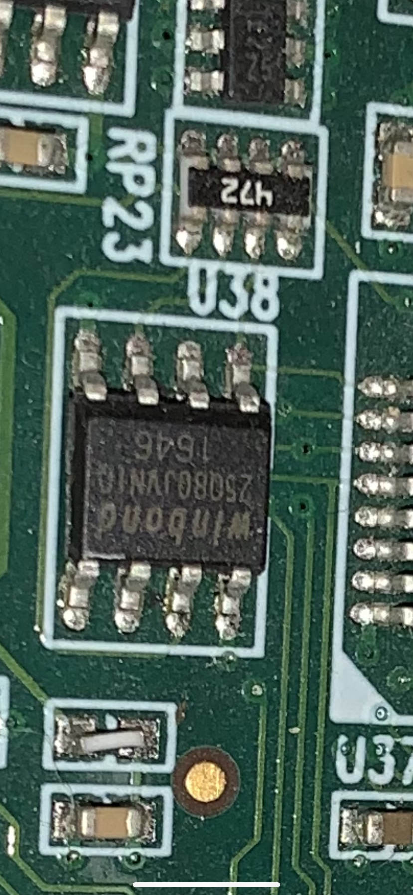

Soren,
Could you confirm that I have the right pins? (Before I mess up more)
According to data sheet wo bond w25q80
Dam1021 is rev5
Thanks a lot

Don't know exactly what you are doing.... To not load the FPGA firmware, you just short those two pins while powering up the dam1021. Then the uManager should enter directly, if not the uC firmware might have been damaged....

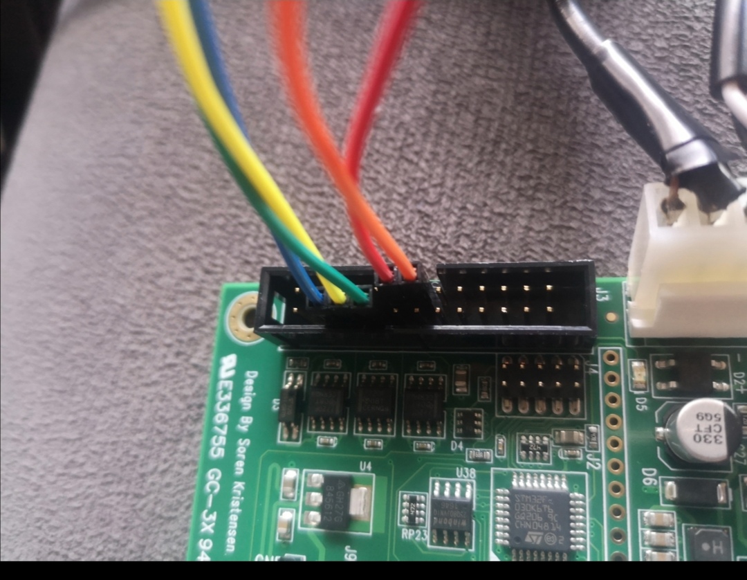

I connected it through isolated serial J3, according to my old documentation.

I reset the flash serial, then start up the pi and try to connect
with cu;
Code:
cu -l /dev/ttyAMA0 -s 115200
I get "Connected"
with screen;
Code:
screen /dev/ttyAMA0
I get a blank screen
It's not responding to +++ or anything else I type
Questions:
* Should I solder on a few small wires to connect to pin 5 and 8 (I assume I have the right ones?) so i can reset the U38 without disconnecting/connecting the pi?
* Can I keep those wires connected through normal use? Or are they functioning as antennas throwing noise on the serial bus?
* Is there any command that i can execute to make sure the flash serial is in the right state now?

You should always be able to see the output from the uC, the serial TX line is connected directly to the uC, only the RX line goes though the FPGA....
If you can't see any output, you should check your serial communication, up to putting a scope on the TX line....
If not, you might have messed up the uC firmware and need to reprogram it. That require the tools from ST Microelectronics....
