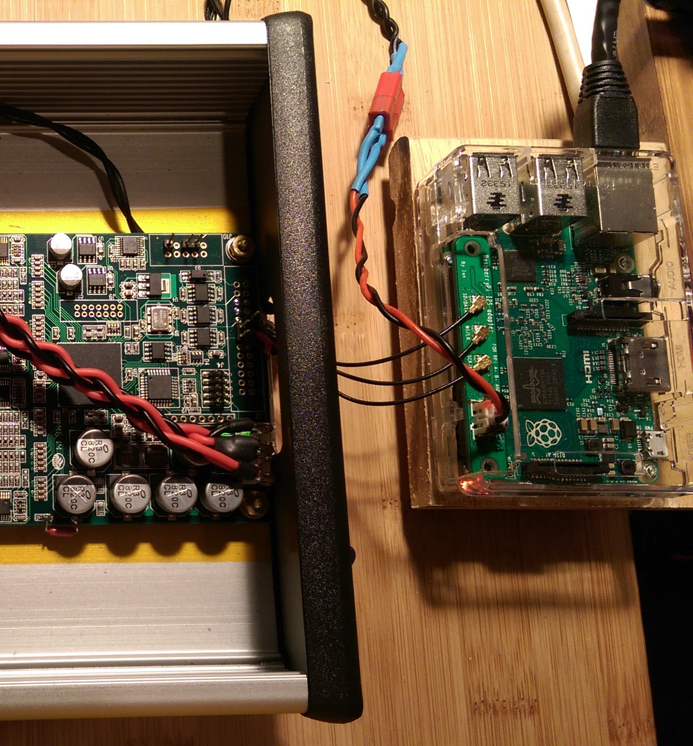

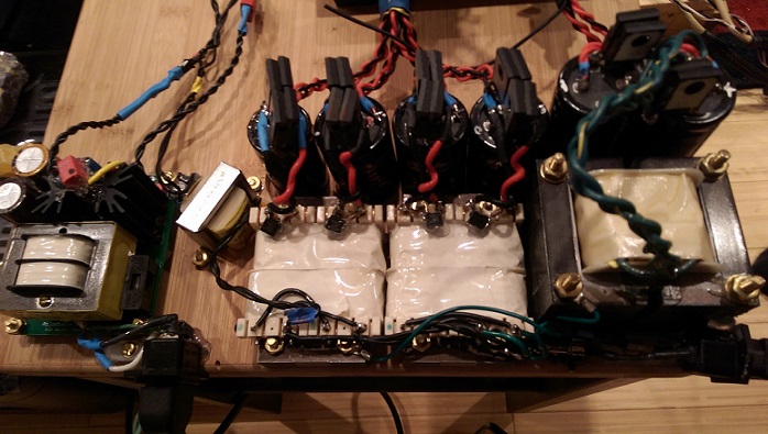

Robert,
I already have Archphile on my list already due to a strong recommendation from the guys who make the MamboBerry DAC (which BTW sounds much better than a $110 R-Pi HAT DAC should ever sound!). I'll move trying it up on my priority list.
I already have a good power supply for the Pi connected through the 5v-Ground pins on the expansion header using an Ian Canada R-Pi adapter board which also sports u.fl connectors for the I2S pins. I've hard-wired short u.fl leads at the DAM end and have the DAM in a separate enclosure to lower radiated interference from the Pi.
See attached pix of my R-Pi->DAM connection and the related power supply array... the one on the far left powers the Pi, with about 15,000uf of filtering and a good LT3083 regulator chip. 1 of the other full supplies has 30,000uf of Mundorf, the other 5 47,000uf of Jensen 4-Pole caps each. The smaller transformer is for a power-on mute.
Greg in Mississippi

Hi Greg!
Very impressing! This is what I would call a PSU;-)
I generally recommend to keep power wires' lenght at least after the last capacitor-bank below 10cm in order to achieve as good as possible 'on demand' performance of your caps. If not possible, place the last cap-bank as close as practicable to the consuming device.
Very interested in your personal Archphile- experience;-)
Greetingz, Robert
