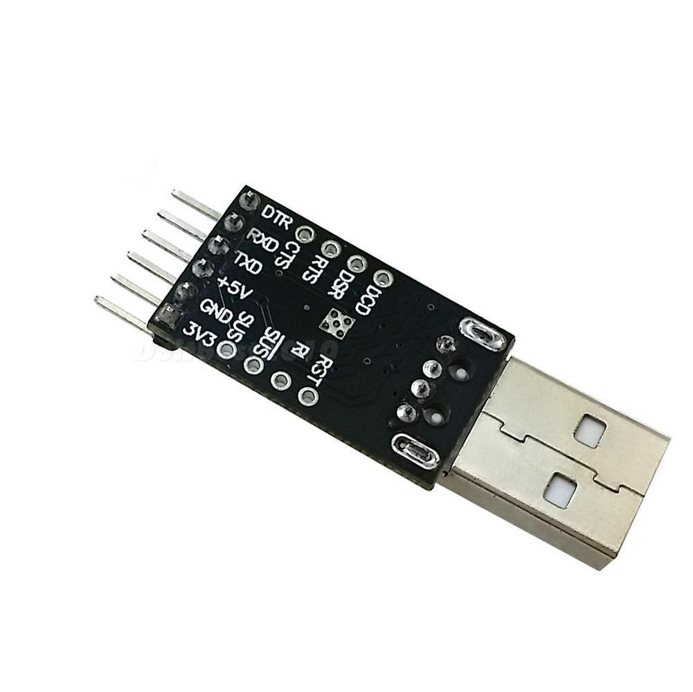

Looking at J3, the pins you need are ISO RXD IN and ISO TXD OUT. You will also need a ISO GND connection.
Keep in mind that this serial port is isolated from the DAM but shares a common ground with your USB to I2S interface..
Plus, these pins are at 3.3V levels (and not RS-232 levels), assuming that the dirty side of the isolators is powered by 3.3V. So your RS-232 interface will not work. You will need a "simpler" interface, like this one: USB 2 0 to TTL UART Module Serial Converter CP2102 STC Replace Module Dteg | eBay which you should jumper for 3.3V operation.

Most of the time these adapters have a jumper that you can set for either 3.3V or 5V logic levels. Looking at this one, I thought I saw such a jumper, but looking at the description it looks like the 3.3V & 5V pins are voltage outputs, not voltage selection. Chances are that it's logic levels are already at 3.3V, but you should confirm that (measure it) before you connect it to the DAM.

Without isolation you are at the mercy of the I2S & Serial port circuits / boards. YMMV.

The USB isolator that you linked includes a DC-DC power supply for isolating power between the dirty & clean sides of the isolator. I would be more worried about what that would do to the DAM..
Regarding the USB isolator's supported speeds, I don't think it should have problems supporting a USB to Serial adapter. I wouldn't be surprised if I saw it running at USB 1.1.
My shield needs very few parts to work with the DAM. The problem is that the main isolator IC is a QSOP package, meaning that you (or anyone for that matter..) would need some magnification and a steady hand to solder it on. The other SMD parts are very few and easy to do..
