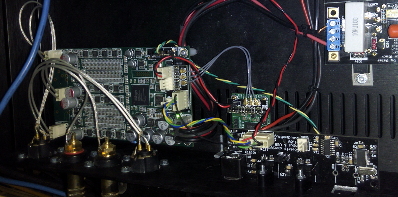

But viewing Salas's picture : are all the new Dams uf-l inputs friendly as well ?
What you are seeing is a small PCB that I built to accomodate U.FL sockets. It is plugged on to the DAM's header.
