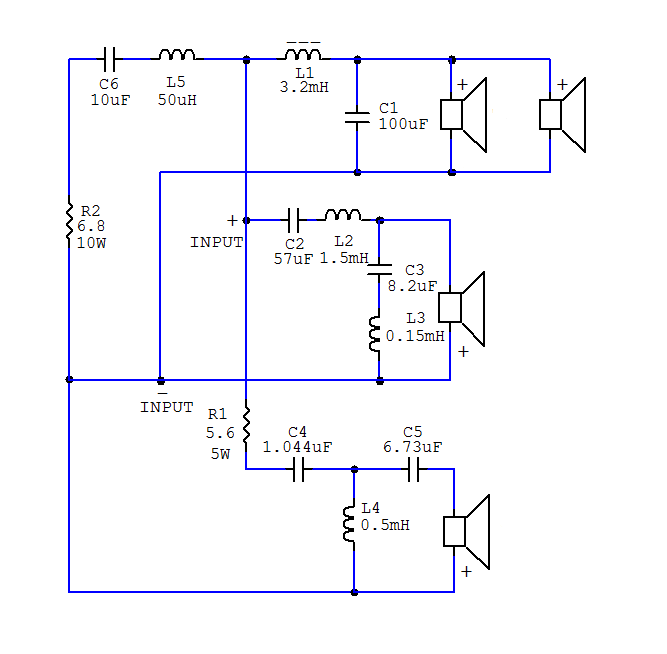

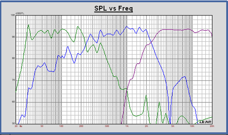

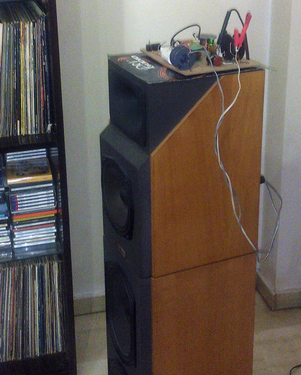

Its I wanted to listen with possible future systems my freshly revised speakers before calling the crossover design done and screwed back in the cabinets guts. The local DAC guys enthusiastically responded and soon a parade of hardware and streamer jargon happened in the house. Many thanks.

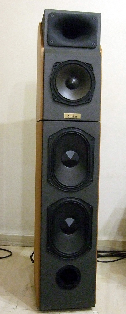

Could you please shed some light on the upgrade of your speakers. I guess the main part that has been upgraded is the crossover.
Its a diy self designed speaker that I have. I changed the HF part from tweeter to compression driver & horn. So the top cabinet had to be hacked for refit and the crossover had to be redesigned as a whole. Parts are plain vanilla from the bin and the connectivity is ironic before final fit. Crocodile clips are feeding power to the crossovers through thin old wires no better than lamp chords. 😀

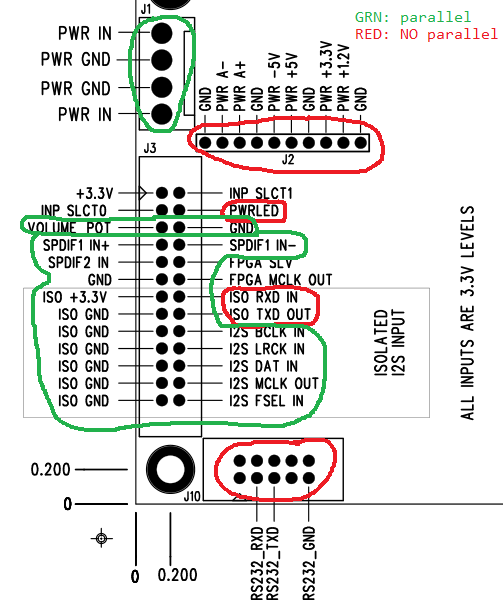

Yes, extra long pin headers are the trick. Attach them to the top board, so you have equal lengths on top and bottom which you can then plug into the board below. Parallel the I2S, SPDIF, ISO 3.3V, ISO GND, GND's and volume pins. (yes paralleling the volume is fine)
Don't parallel any of the others like the +3.3V or isolated serial ports. Use only the top board's +3.3V/1.8V to power your SPDIF toslink and Coaxial SPDIF biasing.
Thank you spikestabber, very helpful!
I created the attached diagram, which I think is right, though still a few questions:
You said, "Don't parallel any of the others like the +3.3V" - which +3.3V are you talking about? The upper-left of J3 +3.3V is part of the volume control, which you said is OK to parallel...
Also, not sure about "INP SLCT1", "INP SLCT0", "FPGA SLV", and "FPGA MCLK OUT" pins of J3.

The upper 3.3V is +3.3V proper, not part of the volume control per se. The volume control is the input pin that takes 0 to 3.3V and interprets that as -99 to +10 volume.
Don't parallel the +3.3V pin period. You will however use this pin on the top board only to power SPDIF toslink and one side of the volume pot.
Parallel the input select pins if you are using them.
MCLK and SLV I left floating as Soren hasn't implemented slave clock input.
I don't have any external controls on my setup as everything is controlled by dam1021.py that tees to both serial ports for specific commands, such as input, volume, etc.

I think I got it... Part of the confusion is that there are two +3.3V headers: one in J3 (i.e. the big 2x13), and also one in J2 (1x10). (I'm guessing those are probably paralleled at the board level?)
Either way, glt's blog shows using the J2 +3.3V header for powering TOSLINK, and the J3 +3.3V header for one leg of the volume control potentiometer. But I assume you could swap which +3.3V you use for volume pot or toslink power.
So what I'm thinking is this: neither +3.3V header gets paralleled. (It would probably damage one or both boards to parallel any of power headers, right?)
From the "top" board, I'll use one +3.3V to power toslink (probably from J2 as suggested by glt's blog).
And also on the "top" board, I'll use the other +3.3V (J3) to go to one leg of the volume pot. The other two legs of the volume pot will go to VOLUME_POT and GND headers in J3; those two headers will be paralleled to the "bottom" board.
Bottom board's +3.3V (and all power headers, for that matter) are left open.
