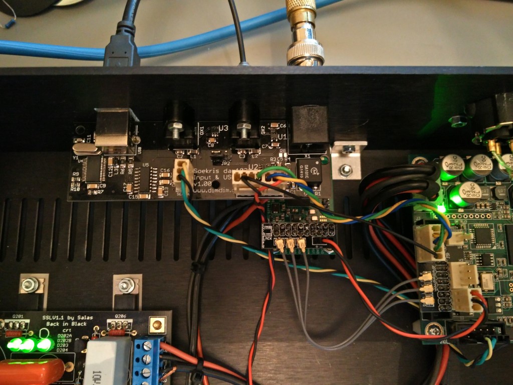

I used 192k optical receiver on . 005 version without an issue. But with isolated SPDIF heard some noise. Than later I realised it was due to the bad contact of the wire on the transformer. Check your wires the issue might be there.
BTW did anyone build am isolated SPDIF pcb, I did one connection using wires but it is quite bulky. Was thinking of using a pcb like this SPDIF isolated input

I built one for my Soekris, but it is a bit more than just a small board for the coax input:

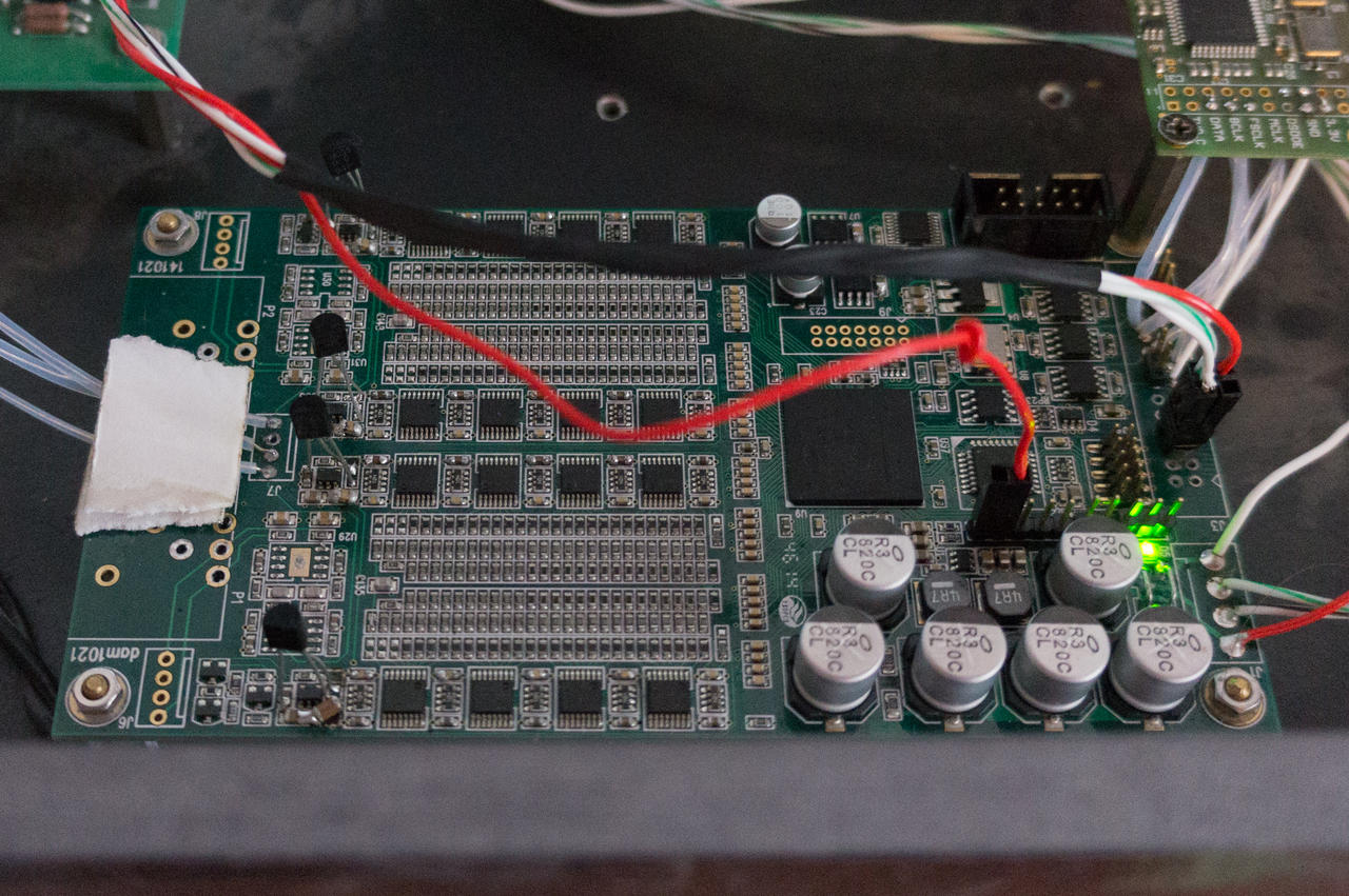

3.6V it is one of very old former approach. Now , after many hours of listening with top DACs and research, I have a completely different scheme based on transistors with 4V.

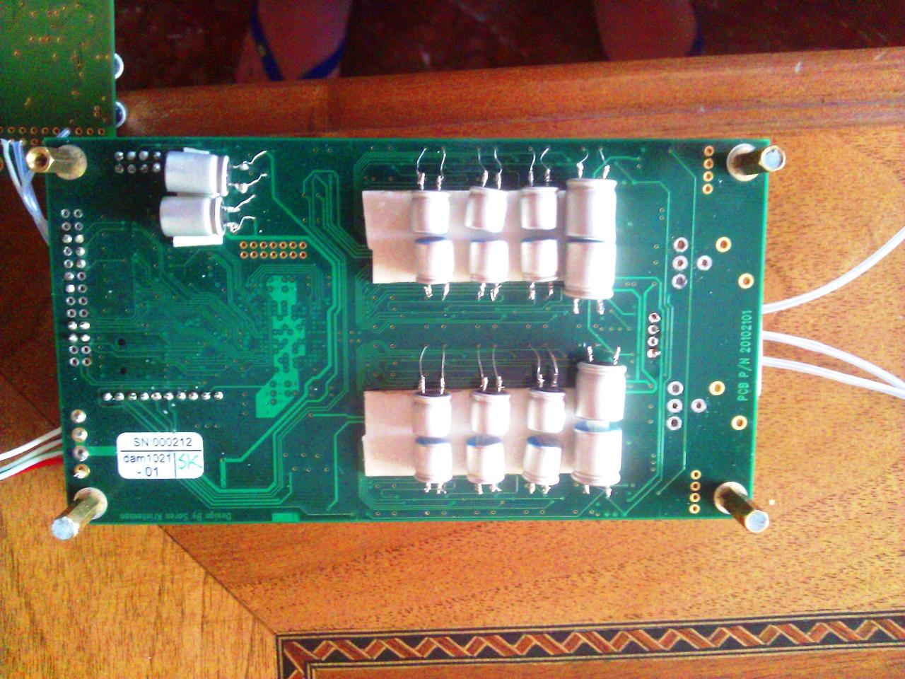

My version, of "Oneclock's" vref mod + 16x470uf!
Before, my mod was "hifiduino mod" 16*470uf caps plus removed output opamps!
Better bass better highs and better depth at first listen...!
PS: alecm share with us your approach!
Thanks to all members!

I'm finding with the low-res mod and 2700uF per vref that there is a loss of dynamics, which is one of the reasons I was looking at possibility of using staggered cap values, rather than 4 or 5 x single value. I want to take a look at the bc560/550 mod at some point to see if this helps, but I want to do before//after measurements to see what effect this mod actual has.
