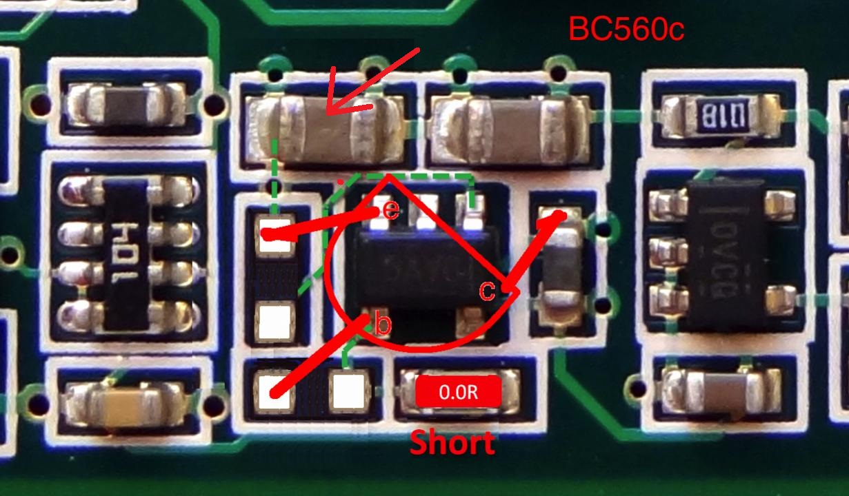

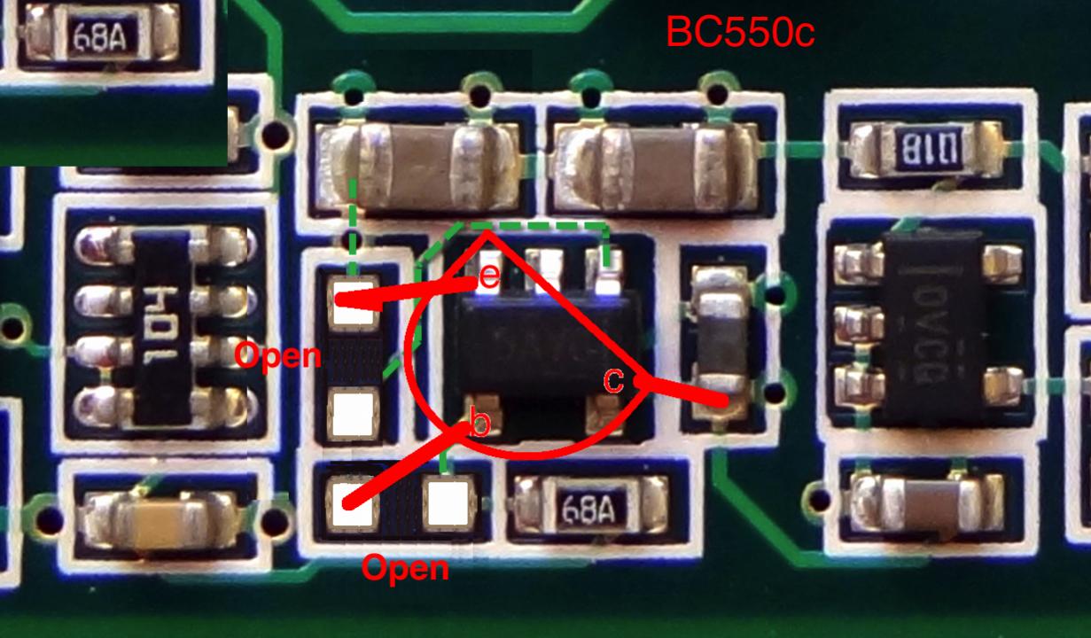

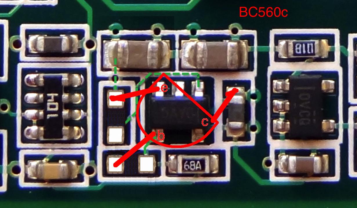

Can any body help me what capacitor in v2 soerkis it it? what capacitive and dialctric? I Thnink it is 47uf X5R .. i have burn it 🙂
I have check it by multimetr on diodes 🙂 I have done BC upgrade and stil want to have prewesly solderet 470uf polimer on the top of 47uf, I must it do again and one 47 uf burn it. For now i have playing without one 47uf , but whit all 4x 470 uf and transistor upgrades🙂

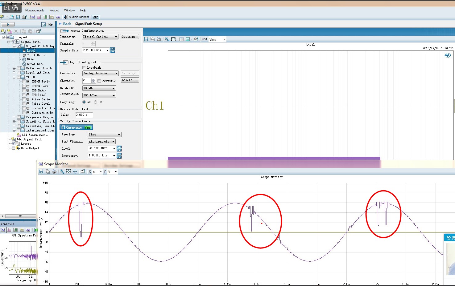

dam1021-12 distortion problem with 192khz ?
Soekris
I got both rev2 dam1021-12 & dam1021-05.
After simple connection, In: optical Out:XLR , AC 2x9vac power
I heard strange sound with the 0.012%board while 0.05% board is OK.
So I used the APx525 to check and found problem with the sine wave.
Do you have any suggestion ?

First, 2x9V AC power is too high voltage, it probably don't have anything to do with your problem but could burn you board....
Questions: Is it only with 192 Khz using Optical in there is a problem ? If so then it's probably your optical transceivers, not very many work that good at 192 Khz....

Thanks Soekris,
I will do more research with the dac board and keep you update.
Hope the board is not yet burnt.
PS. trans 2x9vac is too high ? and you know, will low load the trans sec.wind voltage will increase to 2x10V~ or even a litter bit more.
For DC voltage input, +-12V is Good ?

Specs are clear: 2x 7-8V AC or +- 7-15V DC, see also manual. Your board are probably fine, but with transformer AC input you need the margin for line and load variations....
