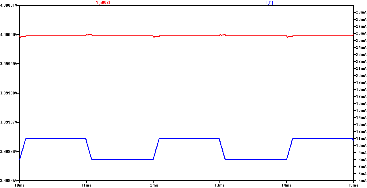

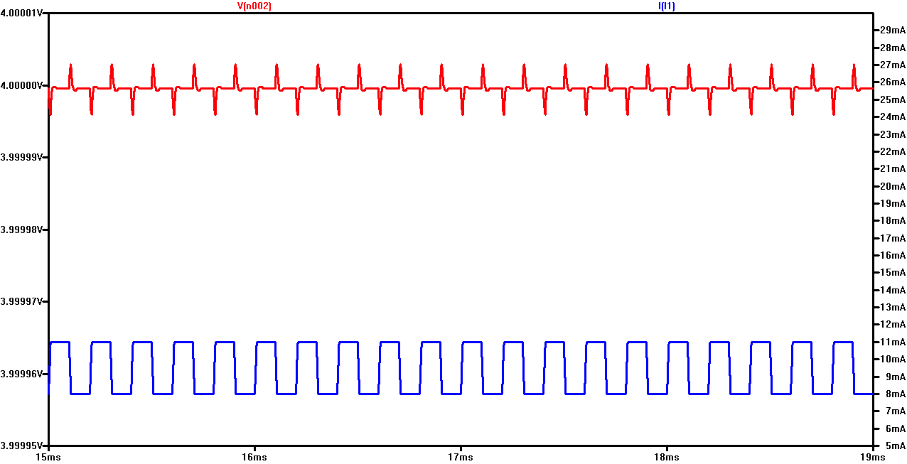

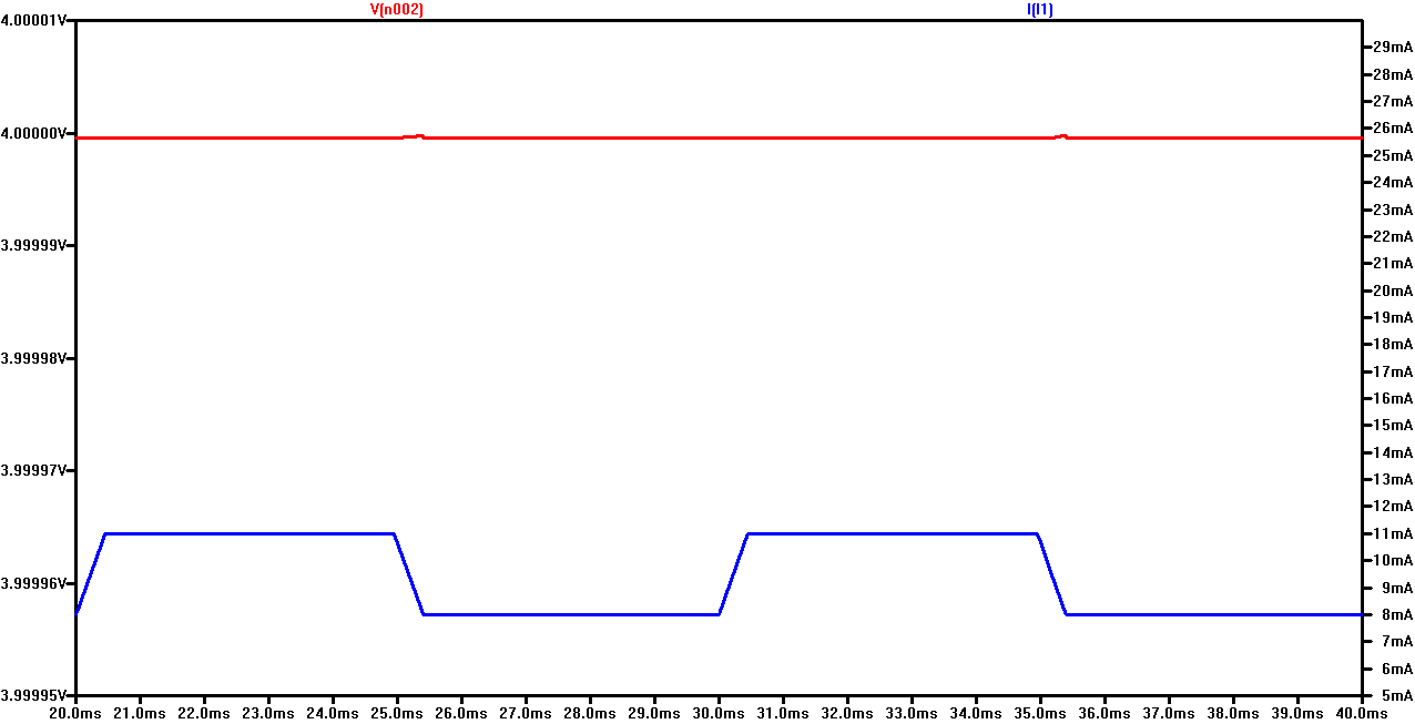

can you make a step responce of the transistor mod?

At first sight it looks good to me, so i made my own simulation.
Simulating with original ceramics (mounted on the board) i get some ringing at transiton point especially with fast rise times.
But after adding a 100uF polimer it looks better to me.
Can you show us your whole schematic?
P.S.: At murata Homepage you can get specific sim models with bias voltage.
