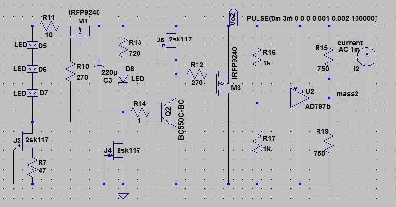

Super Regulator and Salas Shunt Regulator have Low impedance variation with current variation, but not possible 4 v. out.
8 vol is possible. I can bootstrapping OP amp. +8 vol. to make floating mass. I simulate with AD797. But need OP Amp that can work to +4 -4 vol. And 0 dB stable.
attachment.php

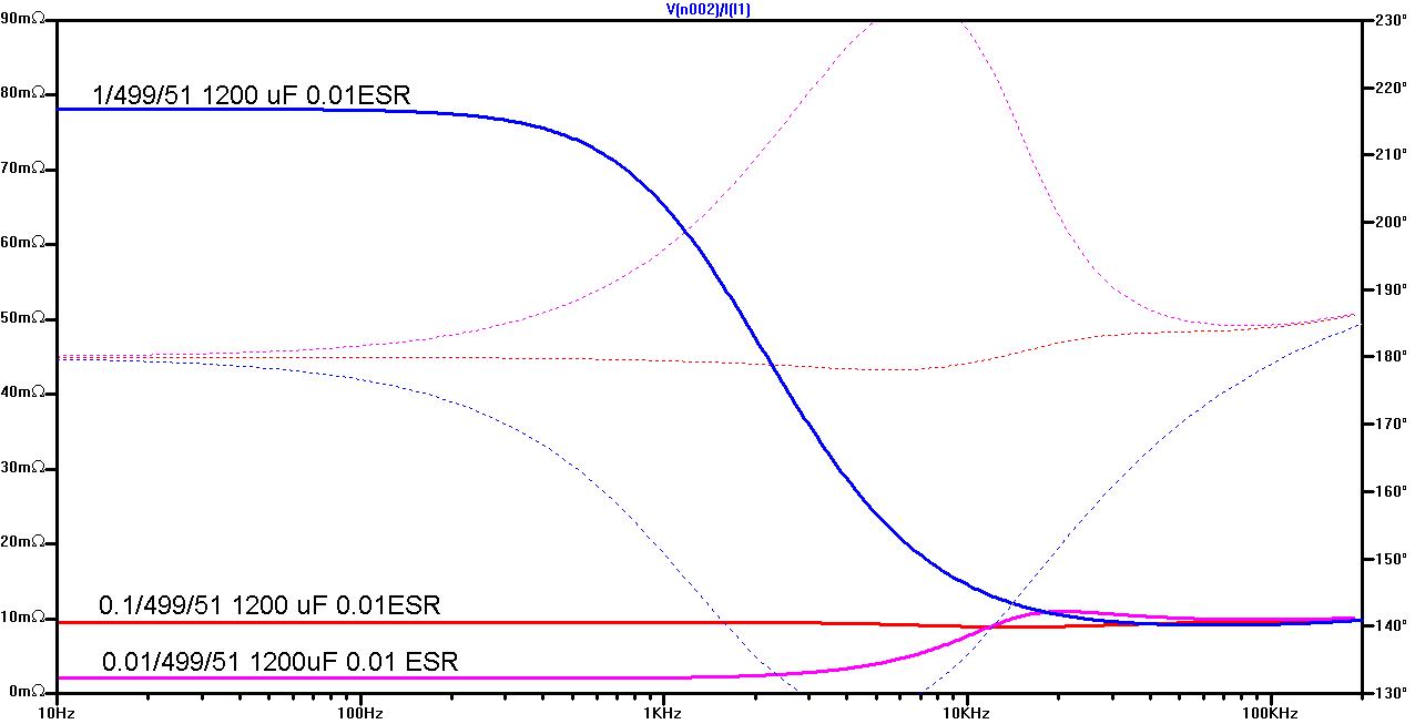

Currently running 1R series resistors on my v1 board (all I have at the moment) along with 499R Rc/51R Rp with 1200uF/0.01ESR. Definitely no more woolly bass here like there was with the 0R series and 16 cap mod.
I'm am curious how much difference between the 1R/0.1R series resistors make if one is interested in running a simulation for me. I've also replaced all the shift register bypass caps with 4.7uF X5R along with 47uF X5R vref ceramics. It appears Soren settled on 0.1R for production but I still see people running 0.01R as well.
