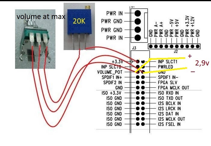

Hi I have connected Soekris v2 by raw output to my tube amp and i have problems with wird noise,When i put volume on 12 i dont have that noise, when i put volume lower or higher the nois i coming on, i have heard that problem is with impedance , and i must add bufor to soekris, good and transparent bufor is on 2sk170 j-fets, but for know i dont have power suply for them so i have question that my problem is on impedance ?

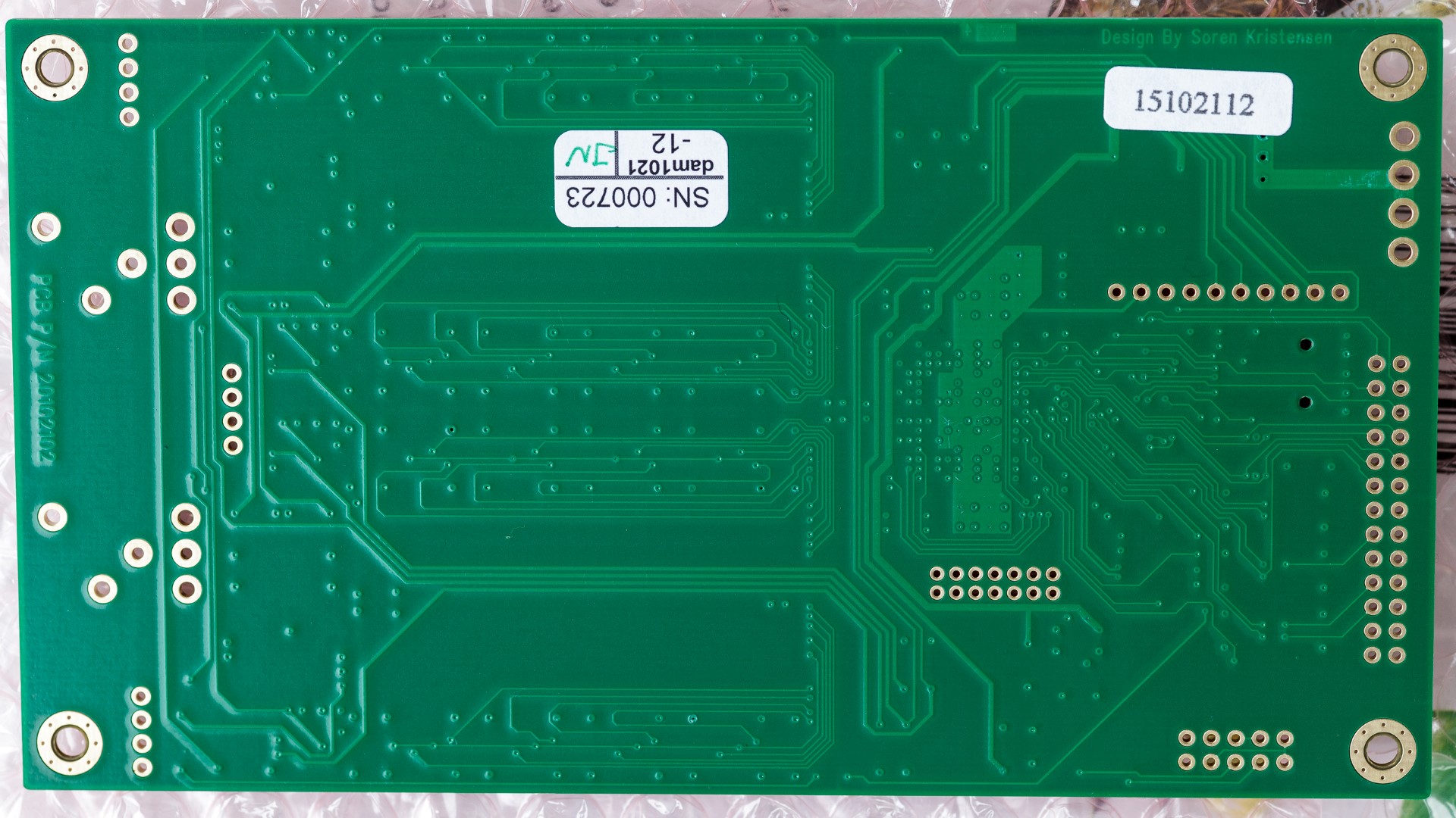

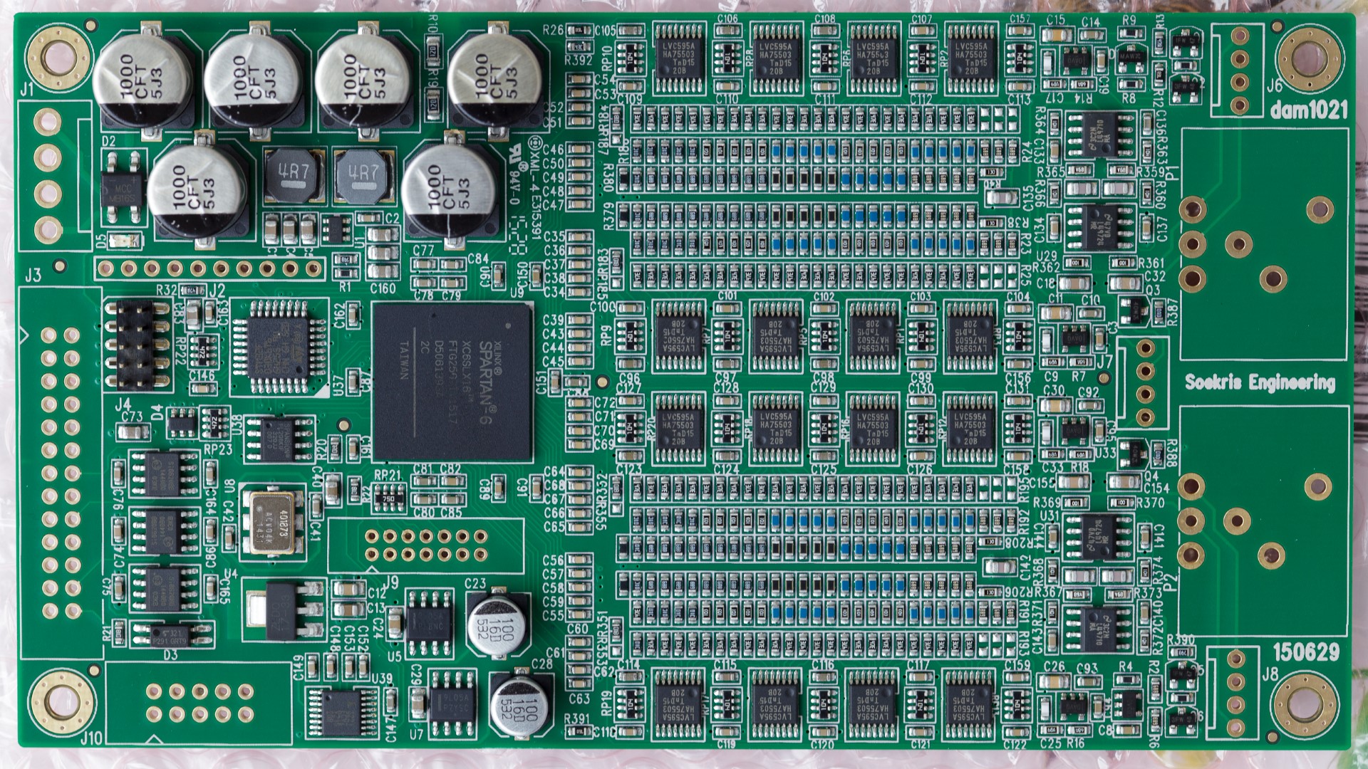

DAM1021 V2 Pics
I got my V2 couple of weeks ago and connected it to a DIYINHK XMOS (non isolated), Salas BIB +/- 12V, 3.3V Salas reflector-D and RPI2 with Runeaudio, DAMfilters, output to LDR>DCB1>Pass F6. Very pleased with the music produced by the set. Still waiting for he Nordmundss V2 companion boards to finish it.
Albert
The requested pics:
I had the same problem.
Fixed it bij putting a 20K pot between the 3,3v line of jour volume pot.
Set pot at 2,9v at max.of your volume pot (12).
