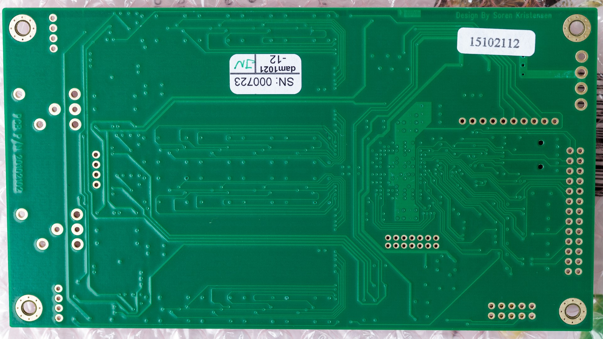

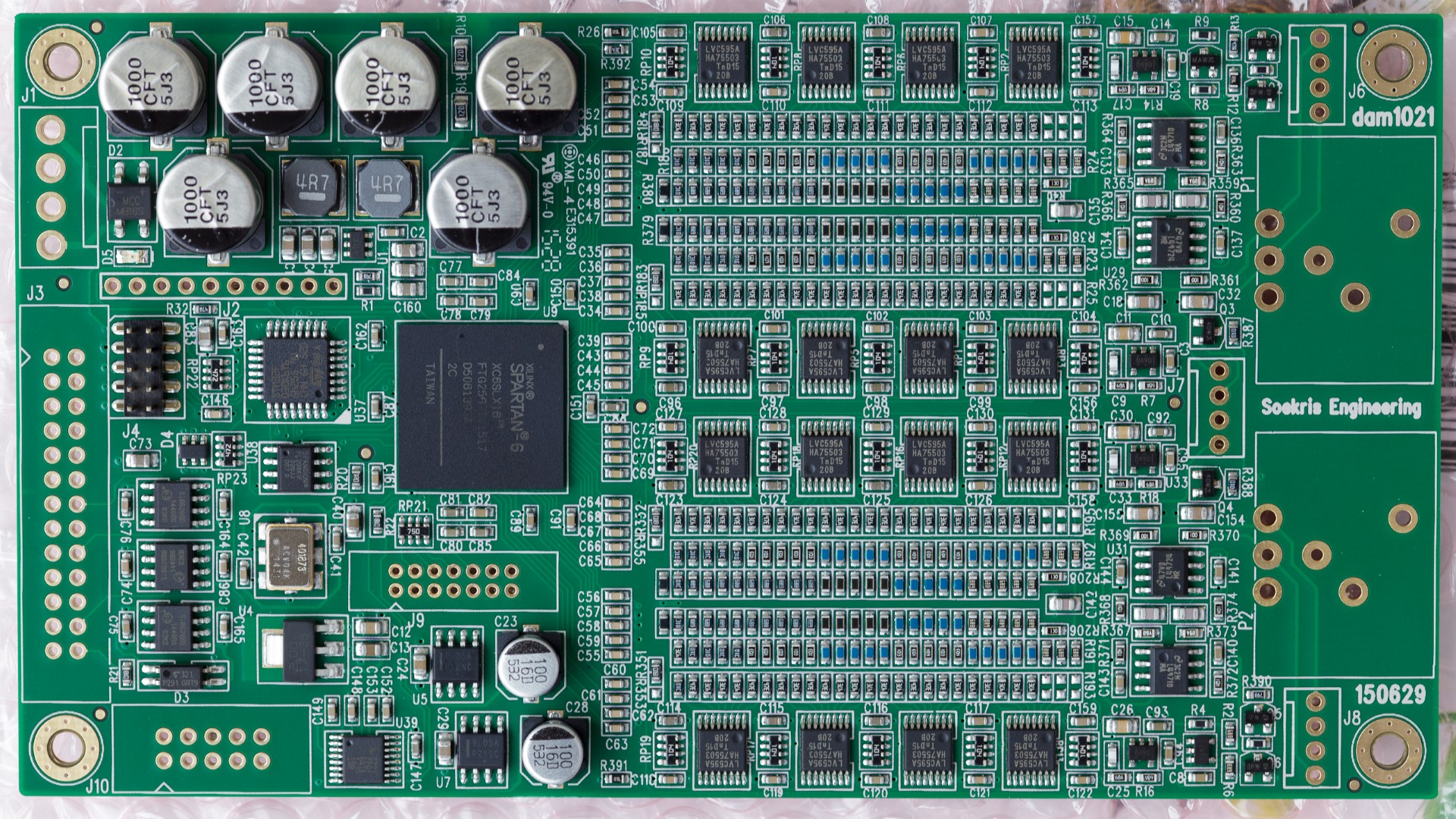

The requested pics:
Looks like the mute circuitry has been changed...

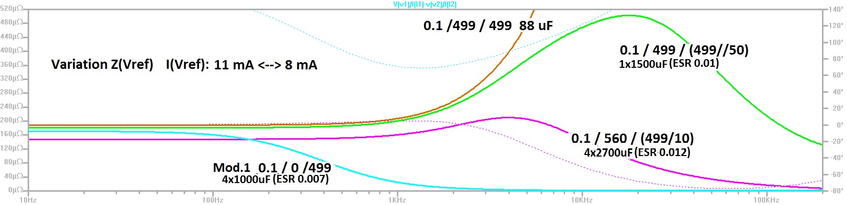

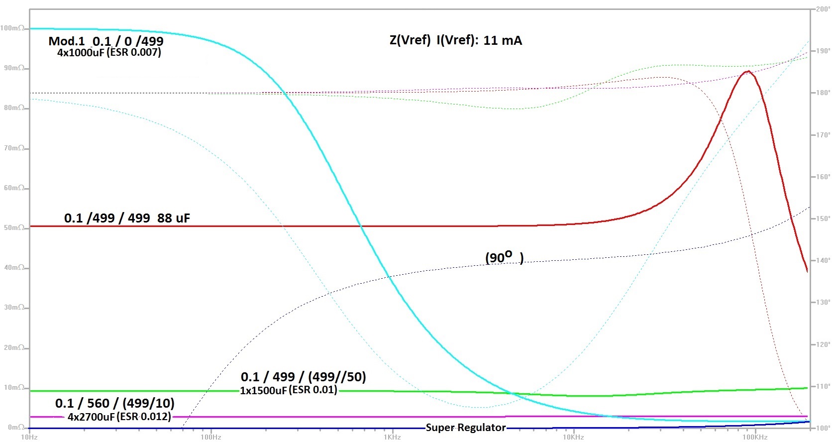

It's posible a new improvement: 0.1 / 560/10 4x4700 0012 ESR. Zout have 3 mOhm.
PCG0J272MCL1GS Nichicon | Mouser
We made comparison between: [Mod.1 0.1 / 0/499 4x1000uF 0.007ESR] and [0.1 / 560/56 1x1500 0.01 ESR]. It leaves doubt.
Comparisons have made with two DAM1021. Both sound great, beter than other DACs I have. And better than original 0.02 DAM1021 Ver.1.
Surprises, we have listening clear differences between the two configurations.
The new 1x1500 uF have analog sounds, very natural.
Mod.1 version is most spectacular scene, detail and dynamics. I prefer it. Have slight imbalance between bass and treble in that. But perception of this difference is more similar to the graph of impedance variation in the current. Mod.1 is better with less impedance variation.
I think DAM1021 can give in bass more detail and dynamic. I think 4x2700 uF and 3 mOhm not going to make a big improvement in that. Have low impedance but no bether variation with the current than mod.1.
