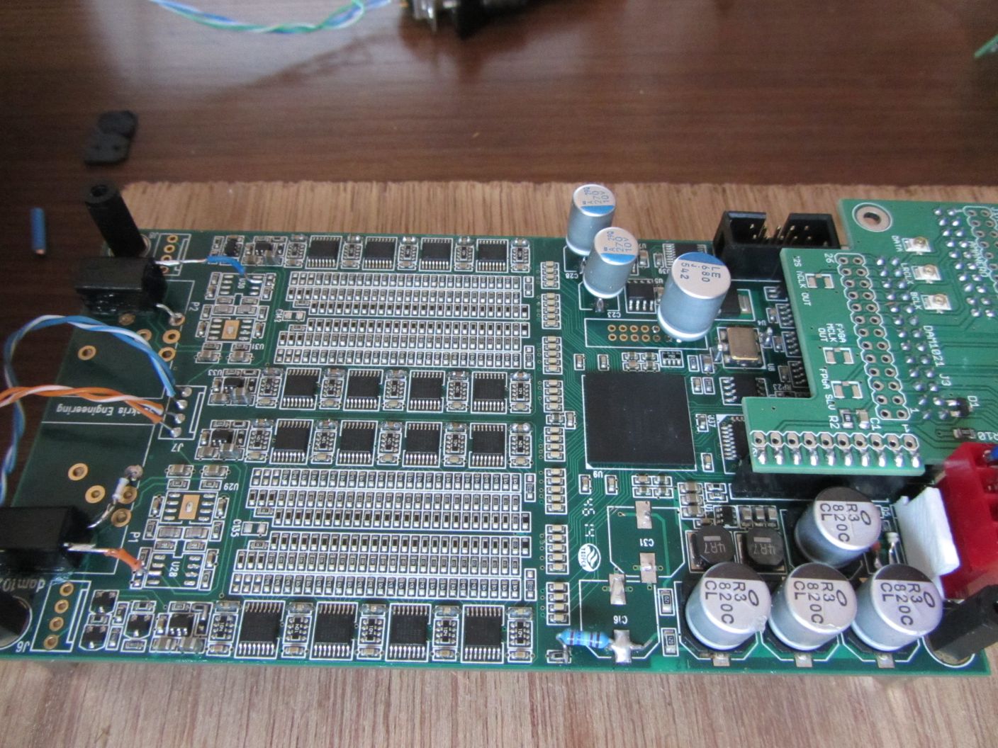

Nothing wrong with bass here 🙂
I think the major culprit for bad bass is the series resistor of the original vref PS,
on the V1 boards it's 100 ohm, Soekris recommends it to change to 0.1 ohm and the compensation cap to a 499ohm resistor.
My mods so far on the on the vref PS: extra 47uf on top of existing 22uf SMT,
0.01 ohm series resistor, 499 ohm compensation cap resistor, 9x 680uf polymer (UCC PSA + Nichicon PLE), 2x Wima MKS2 6.8uf, 1x 10nF polystyrene.
That's the 52 cap mod 😉

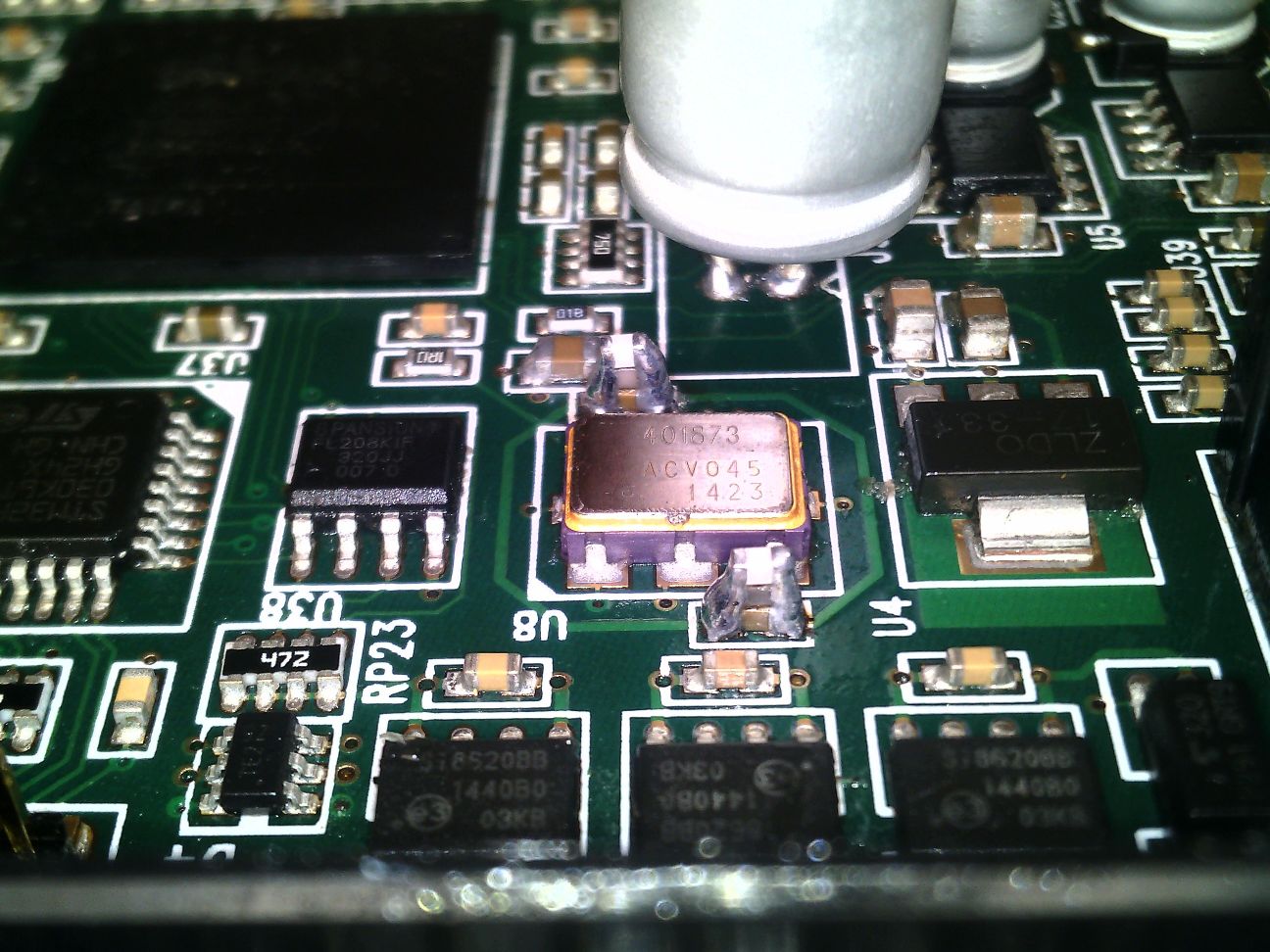

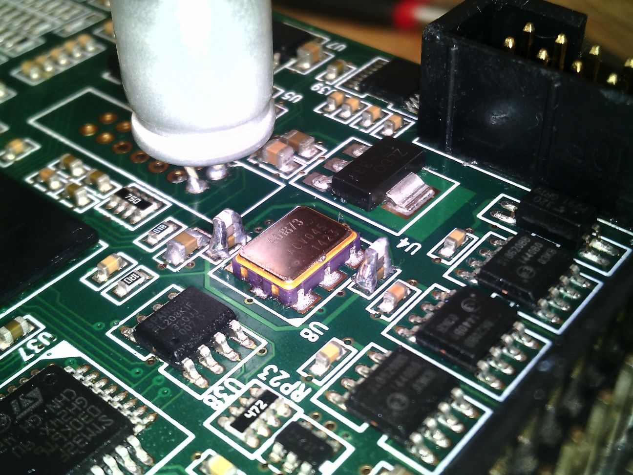

Mods on the clock: Building towers on the 2 existing 4.7uf caps around ring of clock: added 10nf C0G, 100pf C0G, underneath board through vias: 47uf X5R + 390uf UCC PSA.
So close to the clock there are 2 towers of 5x caps (see pics).
On J9 PS clock added 680 uf Nichicon PLE
Mods +5V: replaced original caps with UCC PSA 270uF
Result of all this: the DAC sounds very very good, plenty of 3D 🙂
Better than my es9018 and definitely on same level as AYA II.
Danny

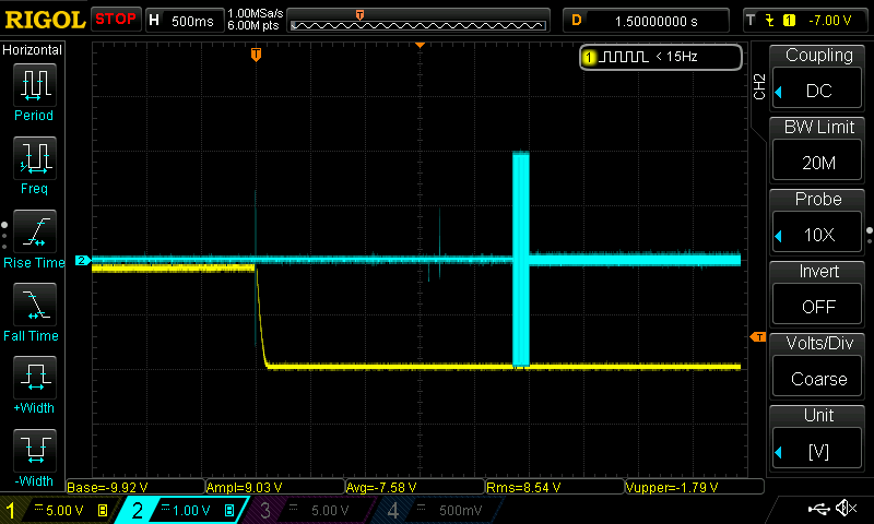

Power-on volume problem
Soeren,
If DAM1021 is powered on while music signal is present on the selected digital input, there is a rather annoying full volume sound blast before the dac sets its volume according to potentiometer position.
To make it easy to see, the attached image shows the problem while playing a sine wave. After power on, there is a 150ms full volume blast of undistorted sound before it does to normal volume as set by volume pot. Yellow channel is power, cyan is unbuffered output. It happens with all digital inputs.
It would be good to have it fixed in the next firmware release.
Serial port output during DAM1021 power-on sequence:
Soeren,
