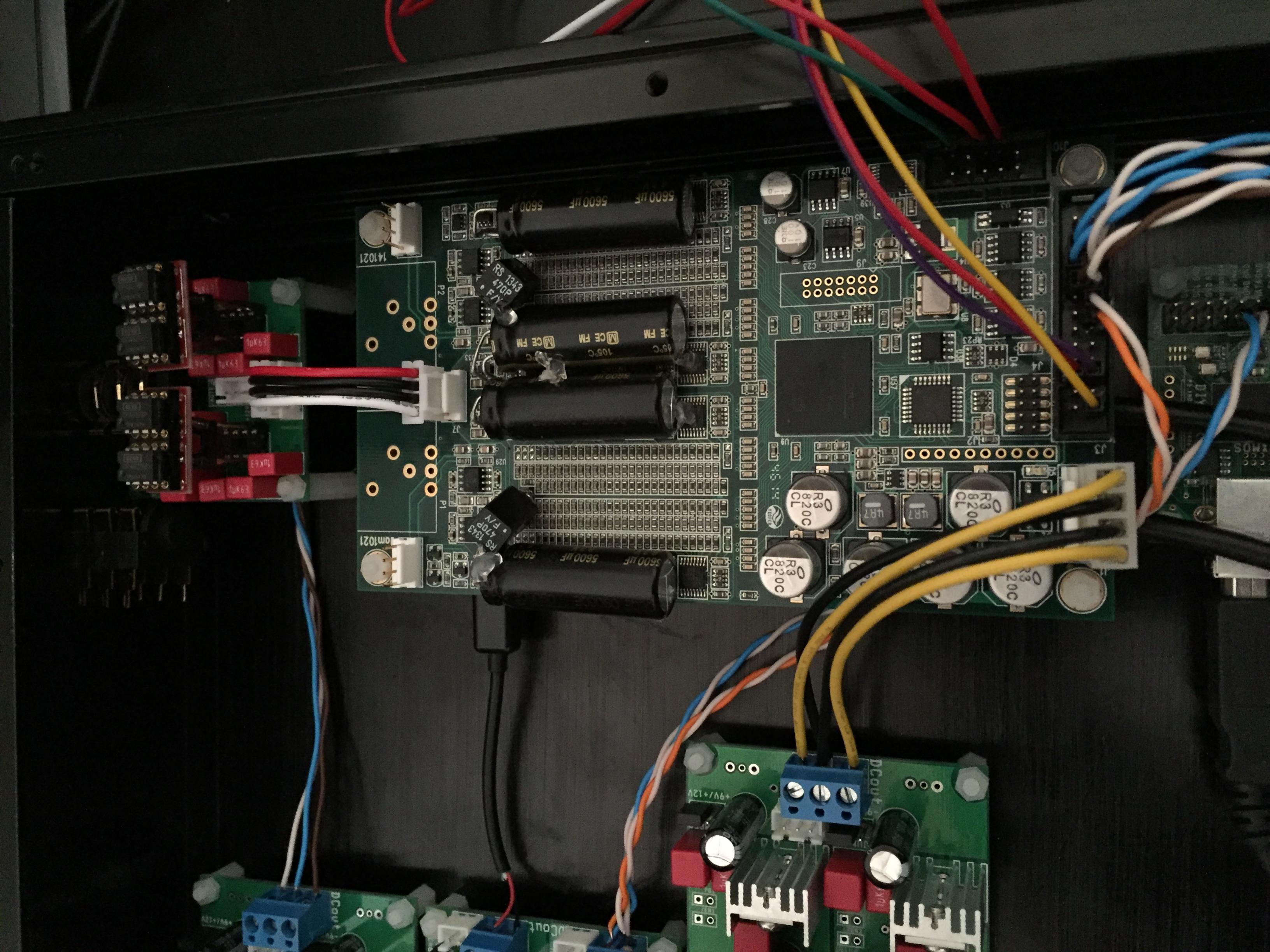

Dynamic issue solved but bass....
I made 0.01R/499R/5600UF, + 470uf ps cap mod
what i hear now it is a definitive improvement on dynamics. But there is something wrong with bass, it is too much punchy and annoying. Is there any way to measure output is fine or not. Maybe there is something wrong with my ears i always listen delta sigma dacs before so I am not used to listen R2R before.
