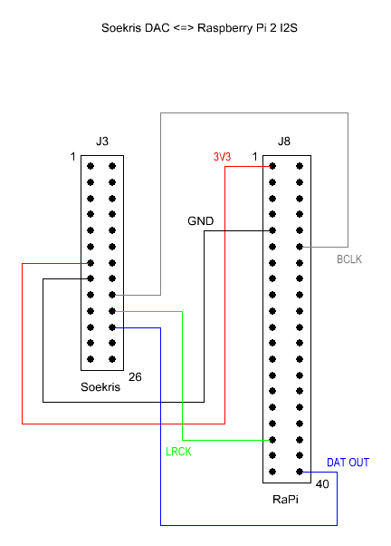

I'm using raspi 2 as audio i2s output, when I playback 384KHz file, the BCLK period time varies between ~40ns & ~42ns, just like below pic from logic analysis instrument.Does the i2s signal pass through dam1021's fifo, the jitter reduction mechanism can make it back exactly 384KHz?
Or should I add a fifo board before dam1021?
If it average 384 Khz over enough time, like 1 mS, then the dam1021 should do just fine by itself....

ExaU21 has 8x I2S outputs. Start with one and get it working. Rinse and repeat for the other 7.
The master clock comes from the exau21 via I2S. The DAM1021 are for all intents and purposes identical, and should respond to variations in the clock in the same way.
Timing delay and sync issues are going to be minimal: Søren has suggested 1ms would be about it. A time delay between boards isn't going to damage anything - it might offend your ears but that's about it.
The only way you are going to get confirmation that your exaU21 + x8 DAM1021 works in the setup you propose is to build it up and test it. If there are no problems, great, and if there are issues I'm sure Søren and other members will help resolve them.

The concern I have expressed is with the i2s signal from the exa21- without a master/slave set up between the dam's, I am concerned about sync issues between the dacs....
We already discussed the sync issues. A clear answer from Søren:
Multople dam1021's clocks will sync to less than one word clock period, probably to one bitclock, so the plan for multiple units is simply to parallel the inputs....
One word clock period (for 48k multiples) = 1/3072000 = 0.33 μs, more than sufficient. No need for a master/slave setup.
It seems you're lazy enough not to do anything with four DAMs and the exaU2I. All you have to do is to wire them up and see how it works...
Double check the I2S connections. The 3.3V isolators on the DAM must be powered.
Here is my RPI2, connected to to the DAM, cross reference this to the wiring diagrams posted earlier.
The green signal lock light is steady in this picture.
It works with moode audio player!
Configure => System => I2S Audio Device => Generic than Reboot.
