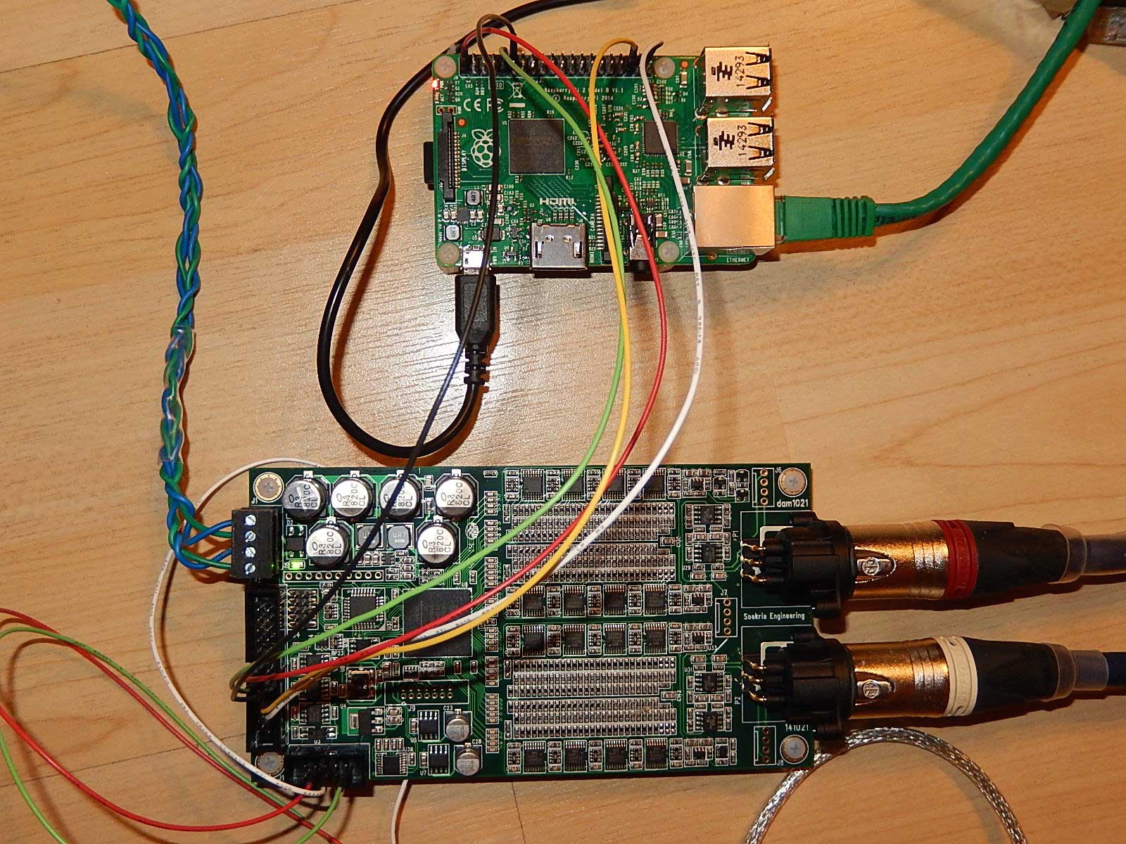

New situation:
Connect the Raspberry over Hifiberry Digi + Transformer to Soekris DAC.
The output (raw and buffered) with distortion.
The Raspberry works fine at other DAC.
If I switch of the Soekris Power Supply several times the output signal is o.k.
Any ideas ?
Daniel
Double check the I2S connections. The 3.3V isolators on the DAM must be powered.
Here is my RPI2, connected to to the DAM, cross reference this to the wiring diagrams posted earlier.
The green signal lock light is steady in this picture.

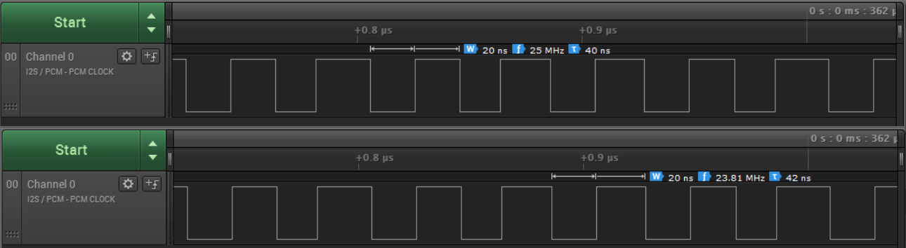

I'm using raspi 2 as audio i2s output, when I playback 384KHz file, the BCLK period time varies between ~40ns & ~42ns, just like below pic from logic analysis instrument.Does the i2s signal pass through dam1021's fifo, the jitter reduction mechanism can make it back exactly 384KHz?
Or should I add a fifo board before dam1021?
