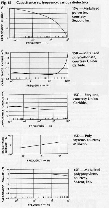

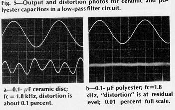

Came across John Curl reminiscing on capacitors in audio, maybe some of this could be applied to DAM1021 analog part?
Cheers
Danny
Cyril Bateman did the best work on capacitor sound, Jan now has them online: Cyril Bateman's Capacitor Sound articles | Linear Audio NL
Thanks for this, interesting reading ........
and in good old DIY saying: best capacitor = no capacitor at all!
that is why I was so drawn to DAM1021, no coupling caps in audio out!!!! not to mention the cost of V-cap Teflon and Audio Note Silver!
cheers
Danny
