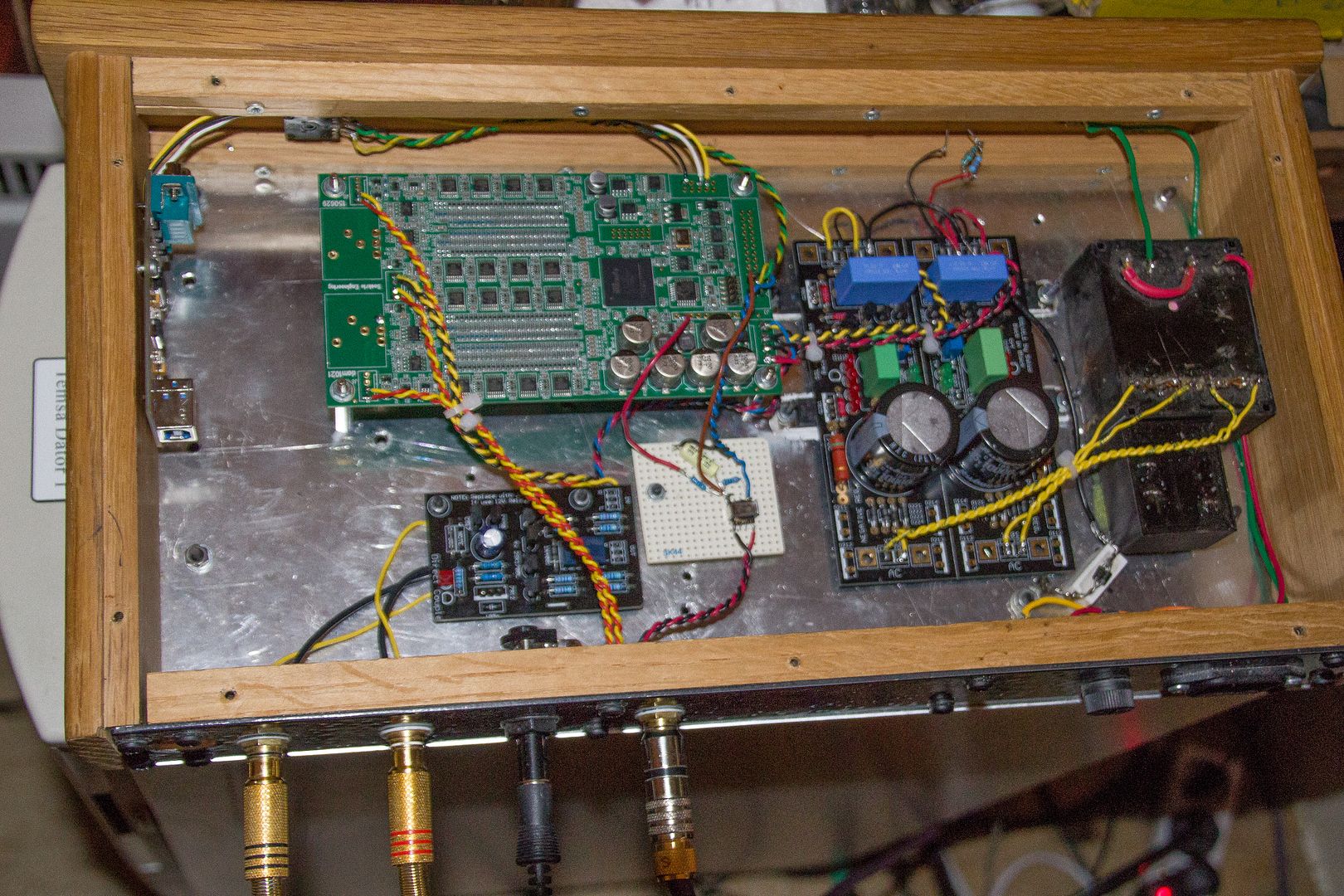

Finishing up the DAC
Hi, I have been using the Soekris DAC since this summer and am quite happy with it and now it's time to finish up this project. Move it from a plywood board to a nice cabinet. Add some nice DC supplies and so on.
I just wanted to have some feedback to the remaining things I plan to do:
1. Remove the 5V regs and feed +- 5VDC from a JSR-06 supply at J2
2. Feed 6-7VDC from a Placid supply for the digital regs at J1
3. Remove diode bridge
4. Possibly add caps to 3.3 and 1.2V at J2 (under the board)
The current state of my rev1 board:
Opamps removed, 16-cap mod, Factory mod, C135,142 removed and off-board Polystyrene used instead.
Any thoughts??
By the way, I am quite happy with this DAC. My best one yet.
Ulf

With the buffer opamps removed there is no need for a "minus" supply on the input. I am using +5.5 volts. (DDDAC1795 shunt reg supply)
The Vref needs plus/minus 5 volts - any more than that is wasteful heat for the Vref components.
Adding caps to the 3.3 reg has not been universally acclaimed. moreDAMfilters/Paul found it to be inconsequential. You can experiment. I am leaving it alone for the time being though I will try a better regulator.
Probably worth the trouble for the dc-dc converter.
If using a good regulator for the +5/6 volts supply at the "front" remove all of the on board caps.
I am using the cap pads after the 5 volts regs (pre-reg for Vref) as the input for the replacement regulators.

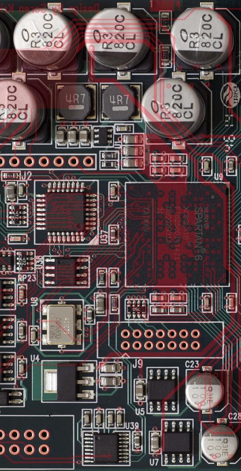

a bit worrying
its a bit worrying that these 4 13 ohm resistors would have so much influence
after further investigation approx half the msb goes through these 13r's
although these 13r's have the largest influence there is many other resistors contributing to an increasingly accumulative sq loss
it would seem from the pics from the rmaf that there's a different type of resistor on the most significant portion of the r2r ladder
and by the look of the dk website there will be a diy version and an oem version along with a newer version of the 1021 called 1121
is all the creases ironed out?
i'm doing my testing on a 0.05 v1 board so i'll likely not bother changing any resistors on this board maybe the "final" one
i removed the lpf cap for me it sounds much better without
but maybe there's a cap that will sound better
Same as original ones 13R / 0.01. I do believe these two resistors are in MSB chain (like it is 100R in attached diagram of 8bit DAC)
Speed and uMicro details are vastly improved.
Taking out capacitor will basically disable LPF (no lpf).
Søren have done this, way back (se post #143 and #144 on page 15) when he was testing speed of DAM. It is good idea to ground lifted pin 3 of "LME49710 buffers " .

Hi Ulf,
first I wouldn't suggest you to feed +-5v trough J1. Reason is that if you look closer, (see attachment) board traces from J1 they are all way smaller compared to ones going from reg's to buffer's. You will be better off connecting +-5v to pads under regs (attachment 2).
Second, Placid supply is excellent VR, however keep in mind that positive rail need almost 3 x more current than negative.... remove diode bridge, yeah why not.
Third, it was already (by Paul) concluded that adding any more caps to 3.3v and 1.2v didn't make any difference! This is because DAM1021 is R2R dac and as such doesn't really (unlike sigma-delta) need high precision clock to perform at it's best.
cheers
Danny
