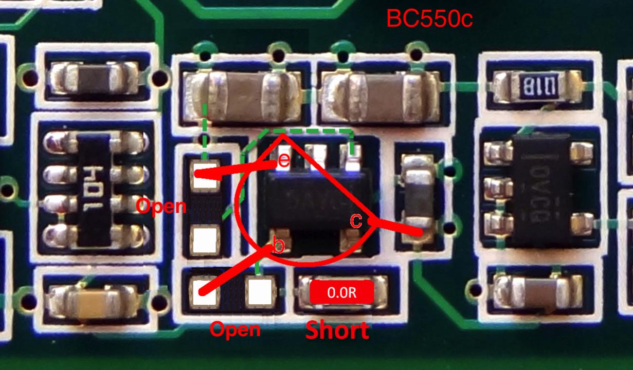

Finally, we tried (Oneoclock and me) the superegulator mod. From the measure view, the results are huge (Very low impedance), but our surprise "subjetive point of view" is that we can hear this upgrade and is really big achievement (soundwise).
I our oppinion is a must, very clean highs like the mod 1, plus a deep bass full of details, much more equilibrated.
Is the best DAC that we heard until this moment
We are very happy :-D

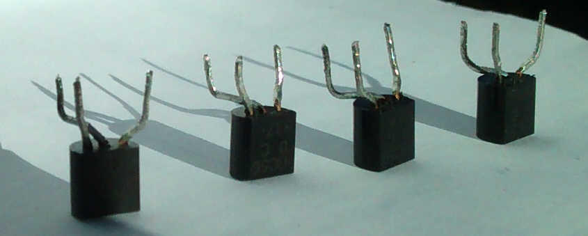

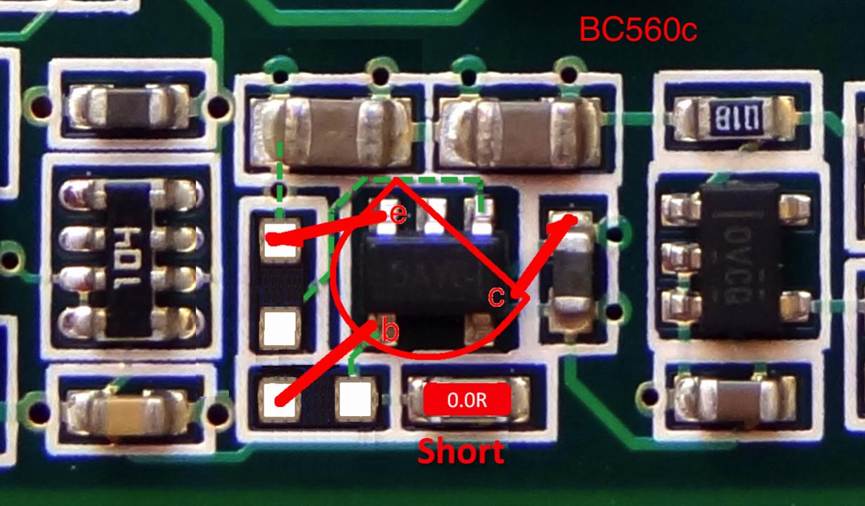

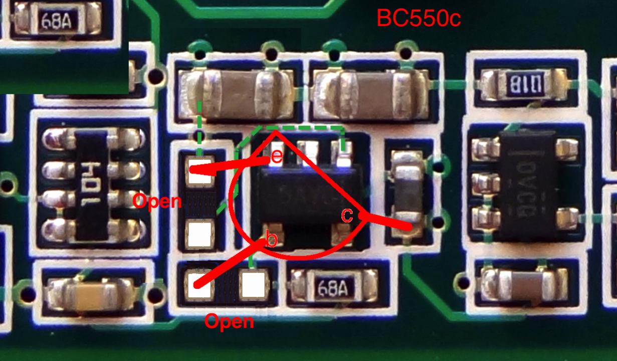

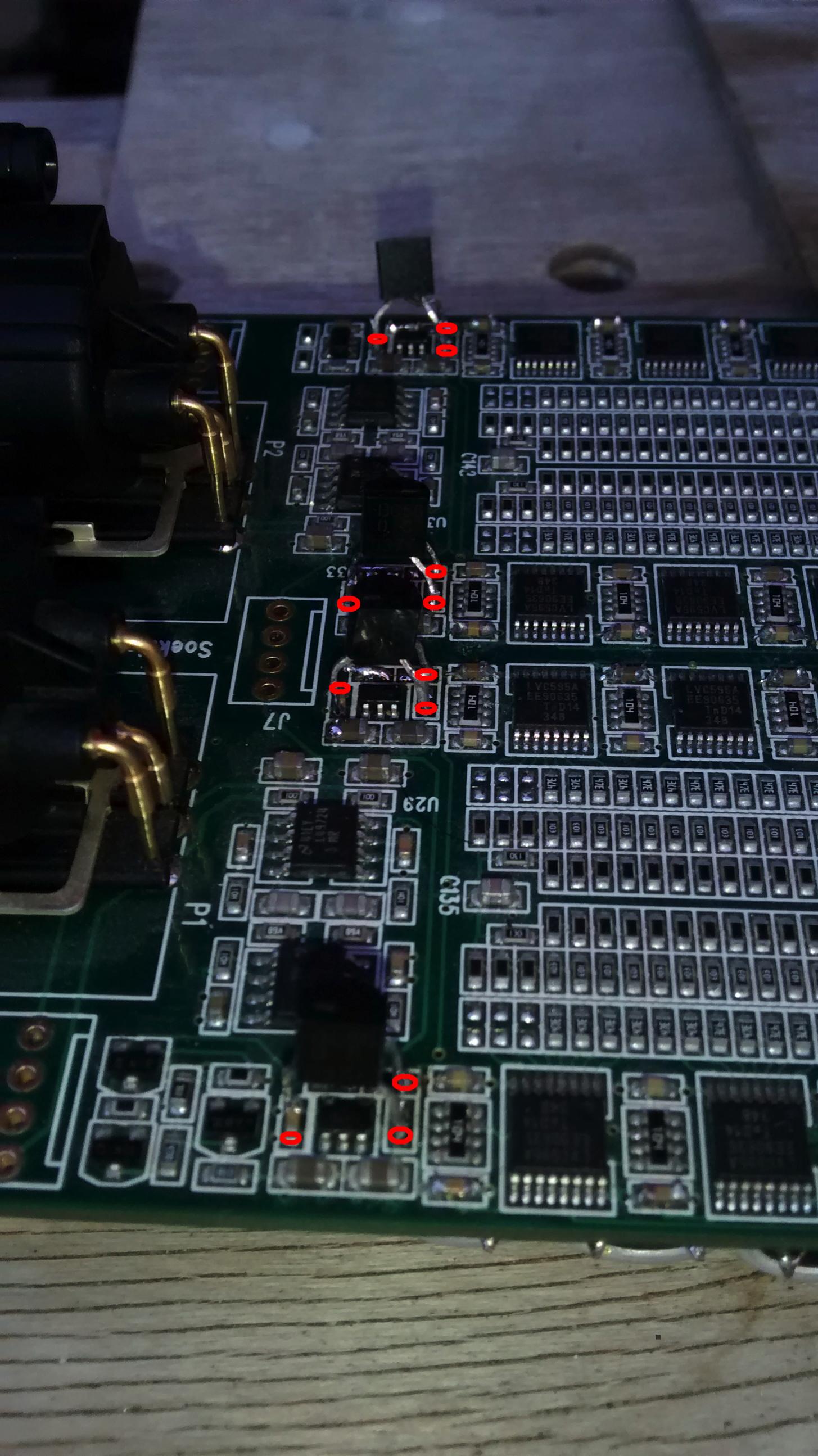

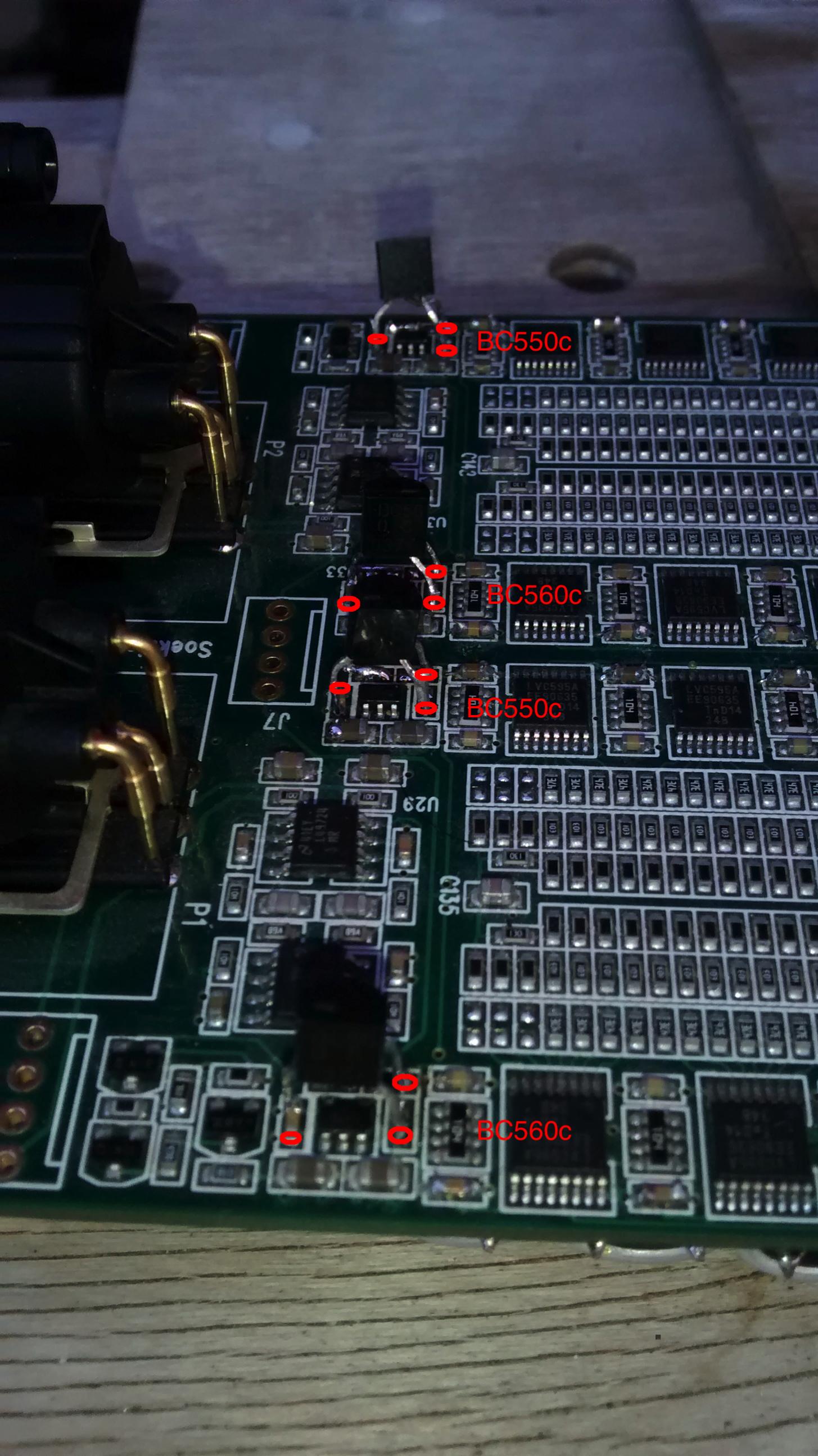

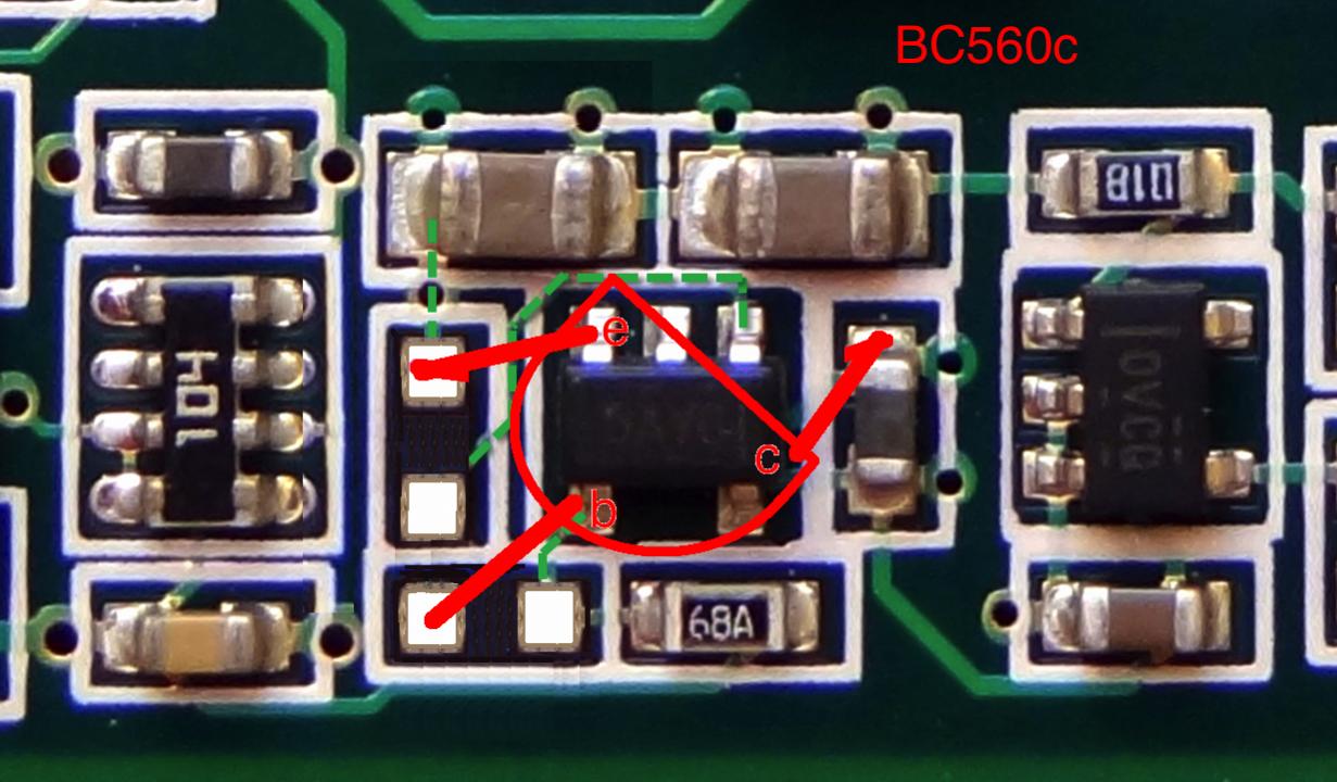

This mod definitely cleans up the bass. I've done it with D882/B772 NPN/PNP SOT-89 pairs. The collector tab solders conveniently onto the cap from the reference source. (use different sides per -/+ vref as in pic)
The emitter and collector pins can be soldered where the old series resistor was, no need so solder straight to the opamp, its a tight space.
Because I run balanced and so far only did one side (left), I can swap and tell the difference. The other side with original config seems to have more muddier bass.

Hi ,cam post some photo for this hot potatoe?
Yes. This is easier to do.The emitter and collector pins can be soldered where the old series resistor was, no need so solder straight to the opamp, its a tight space.
Sorry, I am really an idiot on electronic, but may I ask "open" means to cut a hole on the board or just remove the smd fROM the location?

I don´t disoldered original 5v 7xL05 stabilizers.
I haven't V2. It will be similar.
I'm sorry. I modify the drawing for the Short not appear.Just remove smd!
Red short for the sense resistor is not necessary, mentioned earlier in #4115 post
