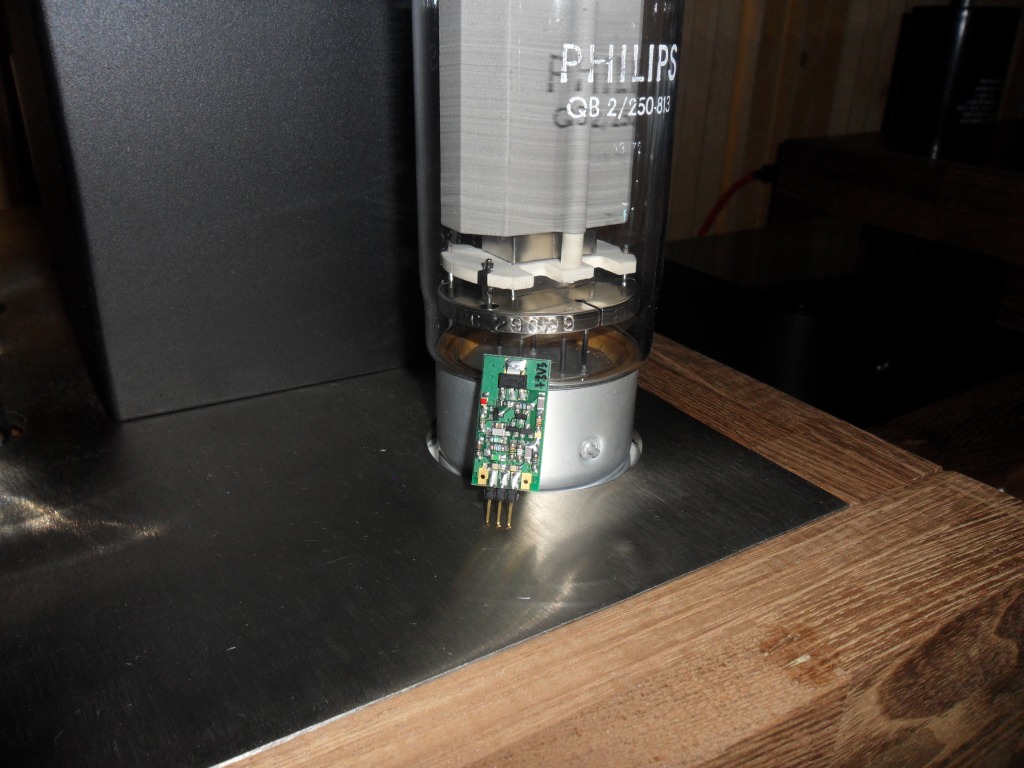

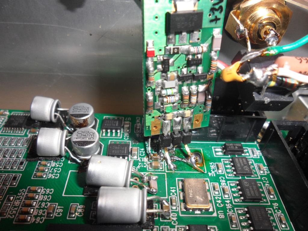

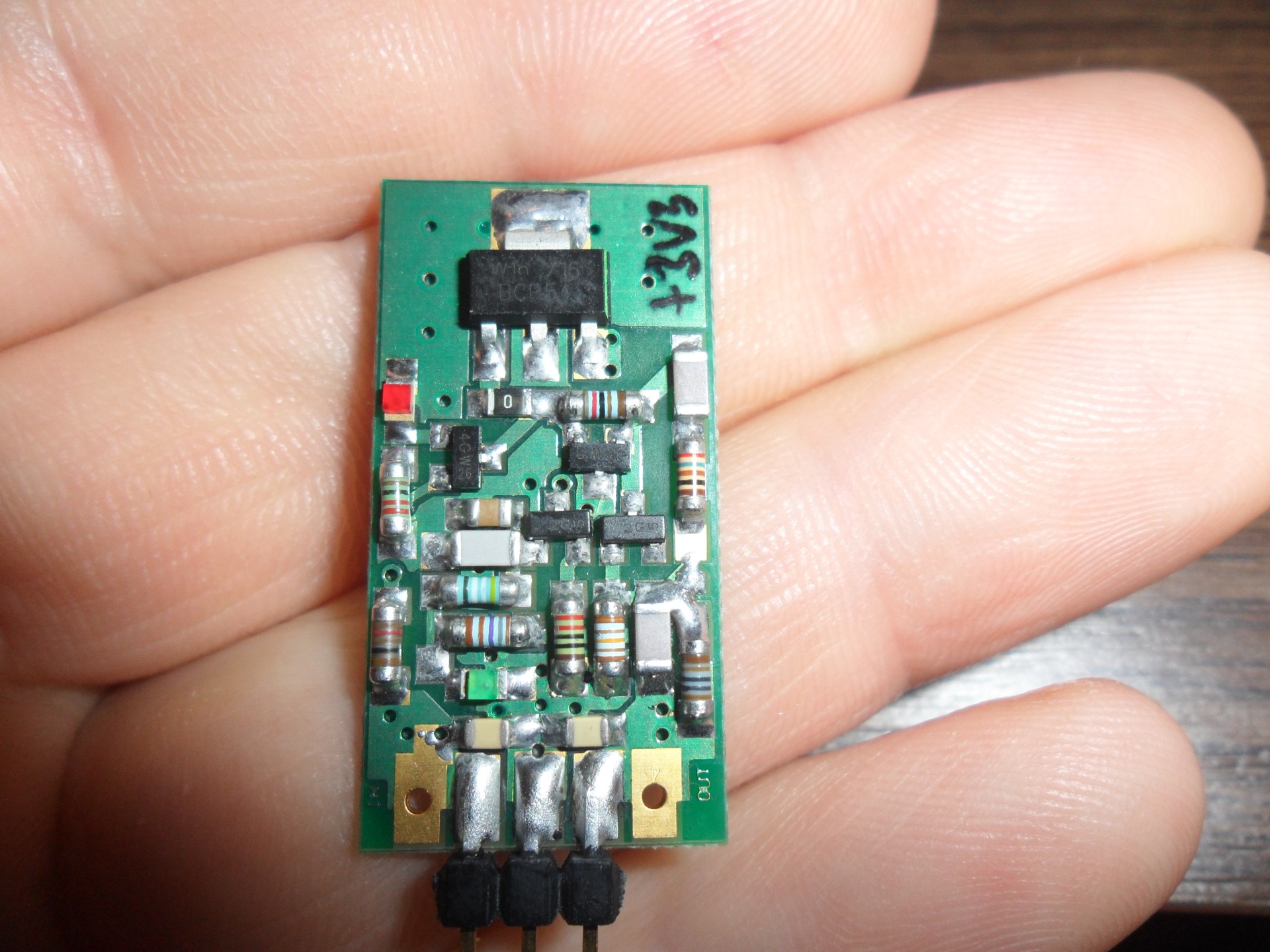

At last! I have it! "Muzg" discrete 3.3v V3 stabilizer for clock. Looks good, tiny, small and complex, good parts! But for now i must play some music on standard zldo17 3.3v builded stabilzier to see what change. Damn im happy! for now im thinking to change bulded 5v stabiliers🙂

Resultats of mod is very good.Plenty of 3D sound, deeper and wider sound stage. I| have listening to Shpongle - Are You Shpongled album and i can fairly tell that it is impasible! Outstanding efects! Damn but im still thinking about next mod, i have in mind two mods:

Input for v3 stabilizer is 12.7v dc, it is same power like we have on the soekris power input. Stabilizer is worm, but not hot. V3 stabilizer is not shunt wersion it is V3.0 – series regulator with transistor differential amplifier, NPN output, LED voltage reference, CCS bias circuit. I was consulting what stabilizer will be good for clock, and we chouse this, shunt version with 12,7 dc input and 3.3 on out will be hotier. Like the all shunts stabilzier. https://muzgdiy.wordpress.com/2015/05/18/vx-x-voltage-regulators-versions-explanation/ take a look a versions of stabilziers. I will probebly change builder 5v stabilizers for somethink better, mayby i will be shunt version. Some body added a picture with no builded stock stabilziers and has connected output power suply, but i lost it🙁

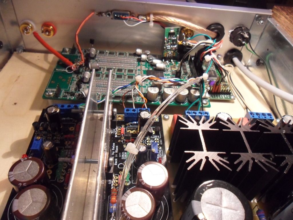

I use a USB to I2S adapter, and only use the I2S input with this dac. I use the same power for the adapter, and iso3.3V, and found that improving that voltage made a significant difference, more than I expected honestly.
This is not recommended, but I've removed the opamps that provide +/-4VDC, and provide my own power to the ladder, and that was significant. But I also never made any of the recommended changes to that circuit, so I don't know how my dac compares to the more standard mod.

My dac mod info
My approach was to provide as good as power as possible at the power user. IMHO, using a salas shunt for the 12V input doesn't help that much, because there are regulators after the salas. Instead, I replaced the internal regs in the dac.
But, there are many ways to do this, and I have not compared my dac to one with the standard mods, and that is unlikely to happen.

My pictures show where I connected the + and - batteries, you would connect +/- stabilizers to the same places.
