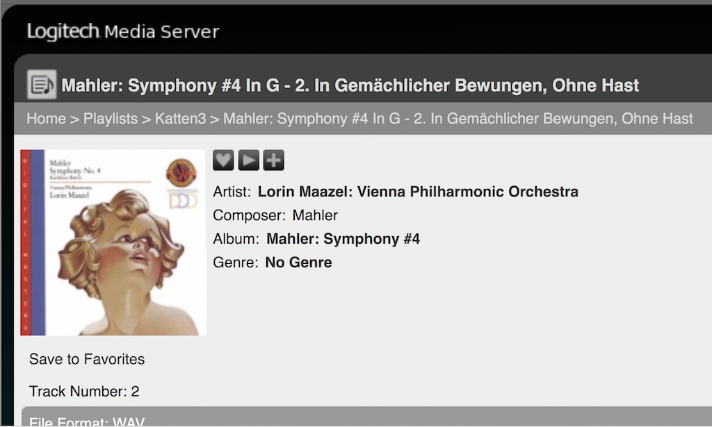

Thanks Sören! I hear great differences between caps in this position. I need to try without then also. No playing: http://uk.rs-online.com/web/p/polystyrene-film-capacitors/0116240/
with MoreDAMFilters latest -3,5dB version.
Playing: Mahler: Symphony #4 In G - 2. In Gemächlicher Bewungen, Ohne Hast
Exciting, involving, real, detailed, dark as in reality, resolved, clean. Wonderful.
Best yet.

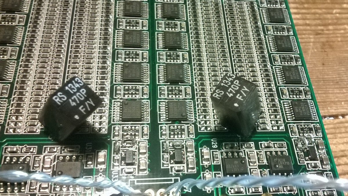

C135 and C142 have no other function than reducing the high frequency noise, as long as they sit across the R-2R network you can change type, value and location to fit you, or remove them totally if you don't have any problem with high frequency noise, we're talking aliasing of the final 3 Mhz sample frequency....
The normal -3db cutoff is 130 Khz (625R || 1.2 nF). I don't believe anybody can hear the high quality ceramic NP0 type used at that cutoff, but this is diy....

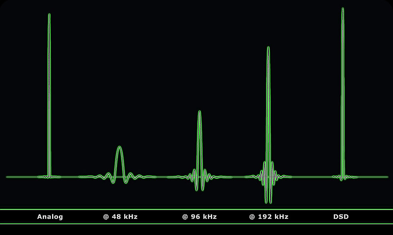

btw. for all of you struggling to find hi-rez/hi dynamic test files go to : NativeDSD and download for free (after registering) DXD file No6 : Mahler 1 finale - session recording DXD. (352.4khz)
p.s
In my opinion DAM will truly shine (as did TP Buffalo III) once DSD (attachment :recording pulse response) is finally supported and as per post #109 "384 Khz sampling is more for show anyway, afaik there are no 384 Khz music files available, I could as well do 768 Khz sampling" Søren could you please, once DSD support is included, enable 768khz (future DXD format of 21th century - 44.1khz is so old as SPDF is)
