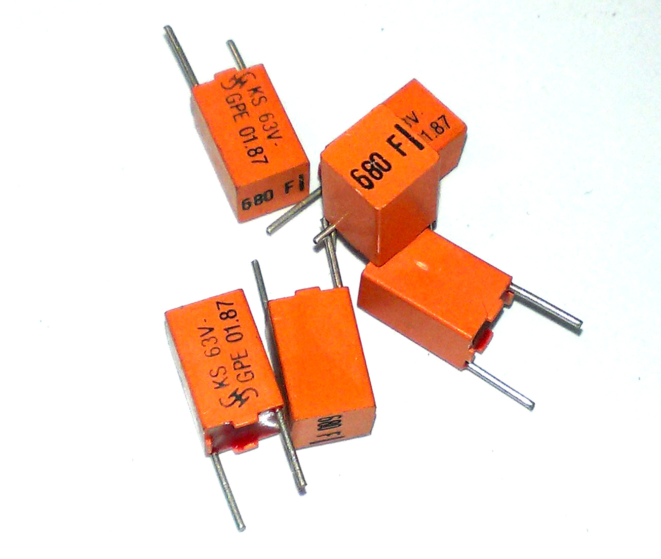

I'm now on FKP2 since 30 minutes. This is much more easily consumed. And yes some beaming in the upper midrange is gone. Stage larger but a little more fuzzy where the room ends. More bass. Did the cheap styroflex have anything on these... there was something exiting that I can't really put my finger on... lets listen for a few days on these now....
The cheap styroflex are probably for the explorative and curious...
I doubt you find them in high reliability products. I suspect when one finds them in a product it is because they are cheap and work well enough to pass QC before being boxed up. CAVEAT EMPTOR
I thought these things ceased being manufactured long ago. Thought it was still surplus being sold.
Here is a link to a proven excellent PS cap - The RELCAP RT - Capacitor Sourcebook - AudioCap RT
They were used in the past in precision products and they were not cheap then. In fact they were amongst the most expensive caps then. Production has stopped many years ago, what you find now in current production are optical similar caps but with different dielectric. Mostly KP AFAIK. "Open" polystyrene/styroflex/KS caps have somewhat higher susceptibility to moist compared to other film type caps, for that reason the encapsulated types Siemens/Philips made are the best in that area. Too bad these often have diagonal pins which makes their use somewhat unpractical. Many have very low tolerance, 1 or 2.5% is no exception. These were ridiculously expensive and hard to find for DIY use. Soundwise I haven't found any objection using these, on the contrary. I still use them as I have many values in numbers in stock, even in large values which were not very common in their haydays. I guess their susceptibility for overheating them while soldering makes them unsuitable for the SMD form factors which possibly led to their demise. Let's be clear that their positive features outweigh their negative features. Please check facts with Google on polystyrene or Styroflex caps as they are called here. They have some really good properties.
In older japanese quality audio gear styroflex caps (made by japanese manufacturers) were used, especially the copper foil types that are sealed with resin are real gems.
The "open" silver colored types are at surplus level now which probably explains their current low pricing at some places (not everywhere !):
http://www.hificollective.co.uk/components/polystyrene.html.

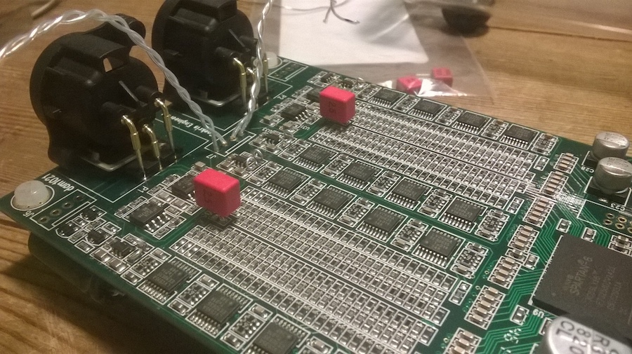

TNT keep us informed on how FKP2's sound evolves. I was planning to use some russian 1200pf teflon caps based on Salas's post in http://www.diyaudio.com/forums/parts/168423-c0g-np0-coupling-caps.html but I guess I will just use the panasonic ECHU capacitors. I have them in 805 size. Do you think I will be able to replace the 603 original ones?
