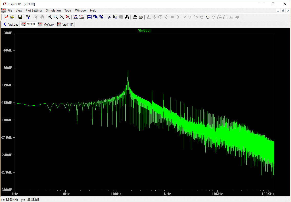

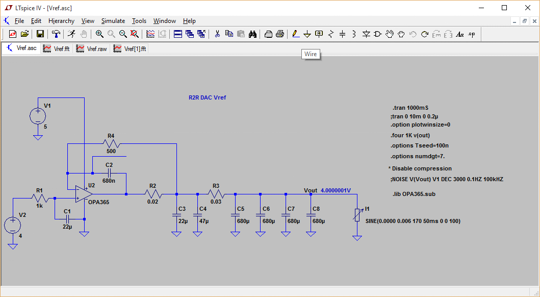

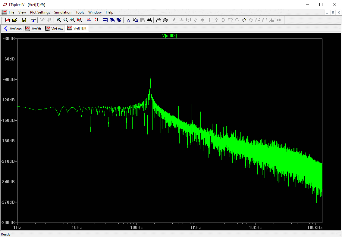

Yes, I've calculated them according the application noteAre you using the 0.68uF cap in the feedback loop instead of a jumper?
Did you try the jumper and find you preferred using this cap?
I also did some simulations in Ltspice and a large capacitors bank (3000uF) with a 0.68uF compensation cap gave me a better result in the simulations.
The series resistor is 0.01 and a guess of the PCB trace resistances.
The FFTs are taken between R2 and R3.
I also have some jumpers that I will maybe install later, but my simulations say no, first enjoying the DAC some time before back to SMT soldering 🙂

Actually I have improved the factory circuit a little since for rev 2, using 0.1R series resistors and 500R feedback instead of the capacitor, then you get 0.05R output impedance. The rev 2 dams then have around 80uF of capacitance on each vref rail. Considering that each LVC595 then add 0.3R internal then it's a good design.
