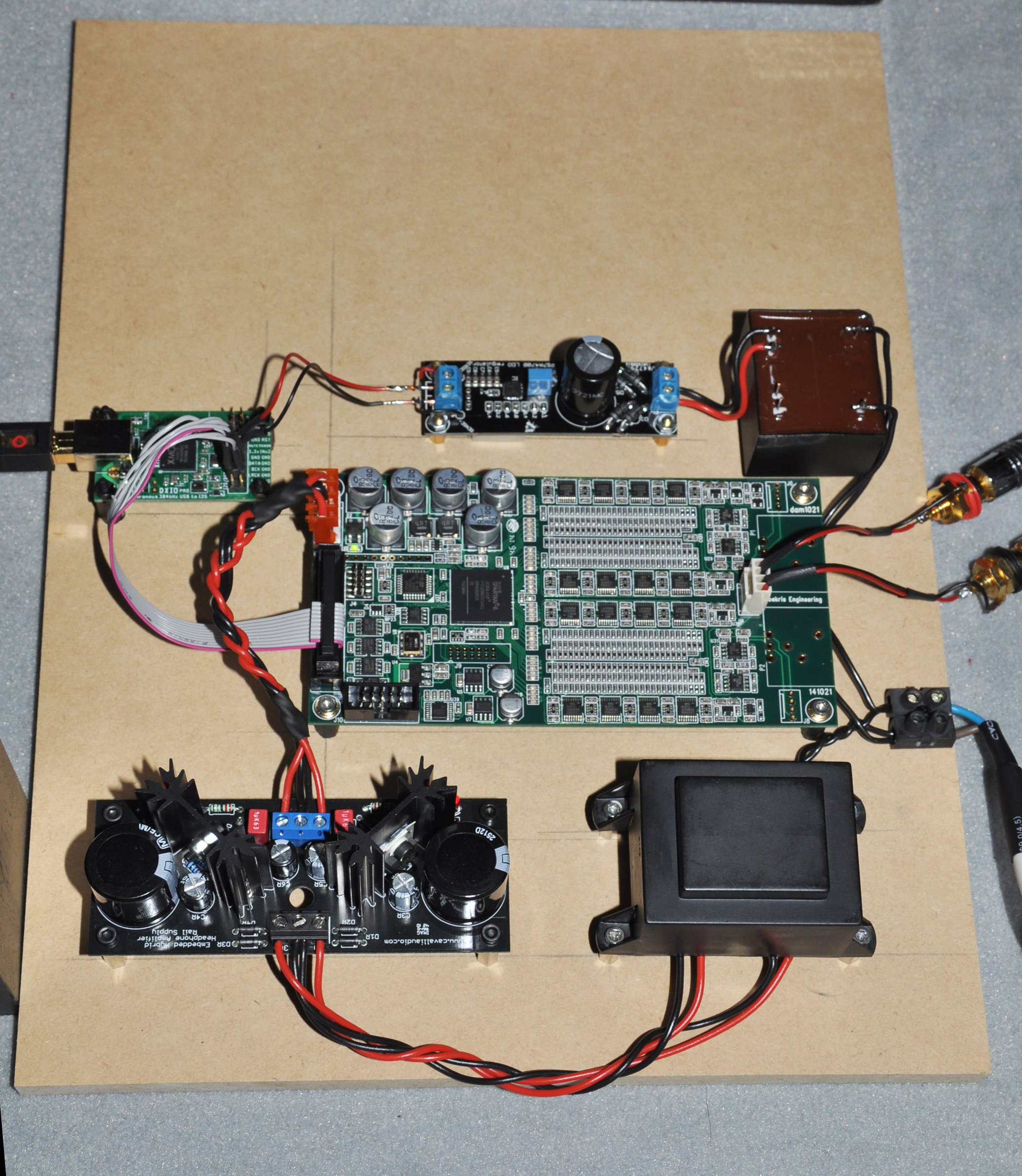

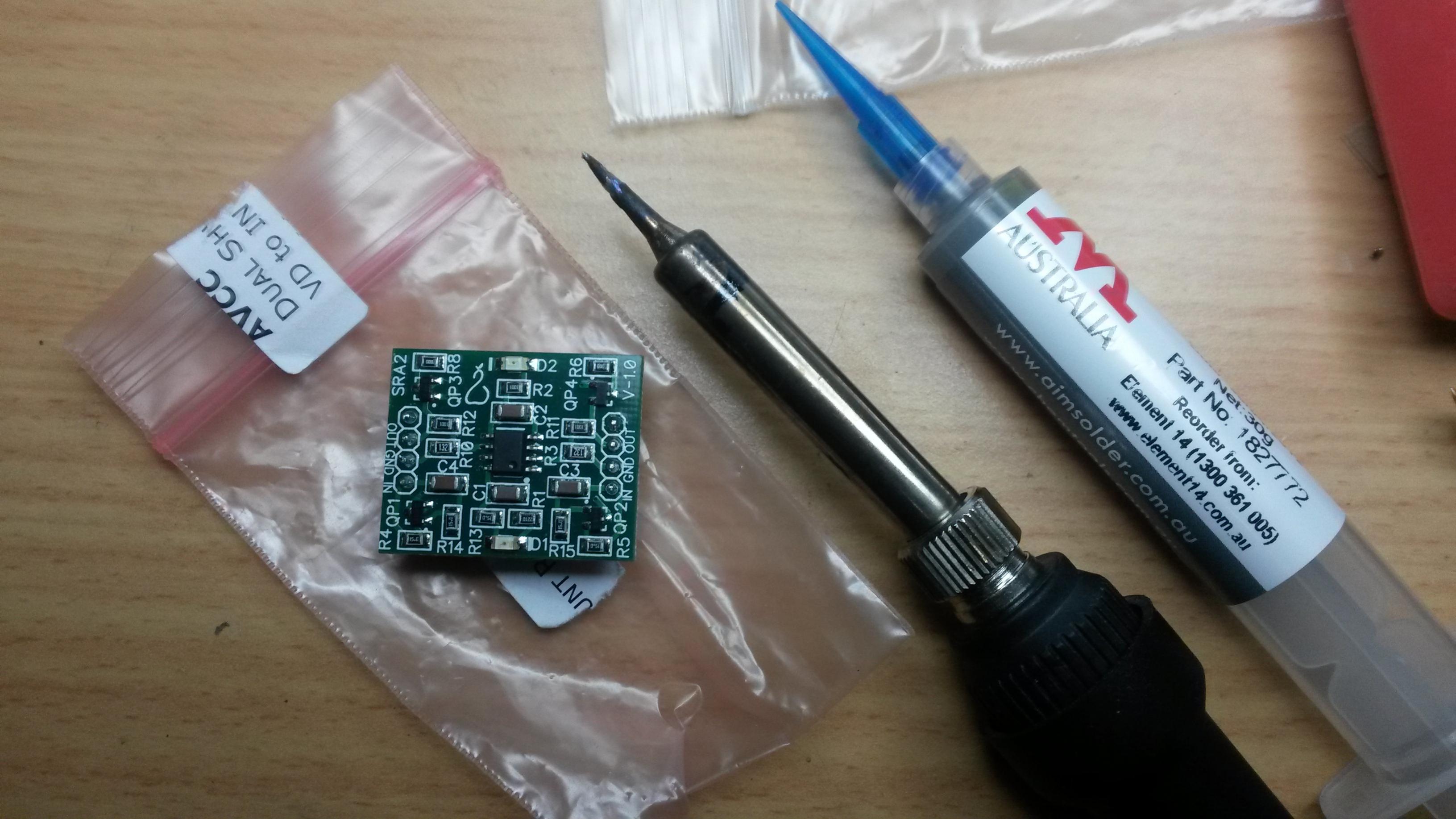

The powering of the WaveIO is big progress on spatiality. And the U.FL Cables are on the way to use the non isolated output.
Next step is building the Salas - Shunt Regulator BiB for the DAM powering.

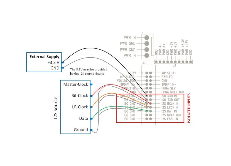

DAM works OK with diyinhk XMOS DSD usb I2S converter?
Yes, perfectly. You only need one dedicated 3.3V supply to feed the converter and the isolator...
So, basicaly, you are feeding 3.3V to XMOS and from XMOS to DAM you connect the same PSU?
Actually when I used diyinhk xmos board, I didn't provide 3.3v and it's working.
Now I have Amanero which has 3.3v output
Not powering the DAM's "dirty" side has been known to work in some cases, but only for low sampling rates, like 44.1, 48k or even 96k. Above that, the DAM has trouble even locking to the signal.
But I would not recommend it. The I2S signal's quality is probably seriously compromised.

I wouldn't run mains that close to the board,...
Absolutely true TNT.
This is the breadboard for testing, final case layout will be much better and take proper wiring into account.
Still the DAM is as quiet as it can get.

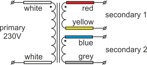

Yes it is excellent after all bugs in volume control that we know off so far are fixed in 0.99 firmware, however, personally I am not using it (have wyred4sound STP-SE pre) and wish
that there is optional firmware where this doesn't exist and these bits are used for longer taps in FR. Get yourself unbuffered XMOS board (cheaper option), as DAM1021 already have I2S buffer. And on power I would (as I did ) suggest you to order one 6-7v AC dual winding 30VA toroid (if using RAW out-if not for buffered I would go with 2x9VAC), and you are set. I know 30VA is overkill but there is reason to have oversized trafo and small filter caps. Also keep in mind that there is, even with latest boards slight "tump" if connected direct to power amp so observe power up/down routine.
