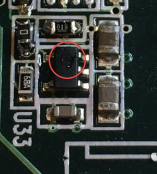

Hi bambadoo, it's look like you have blown one of the buffer IC (next to U33 mark). Have you checked polarity of (to late now)big caps before powered?
If you are lucky you will have to replace only one buffer IC and/or -5v reg.

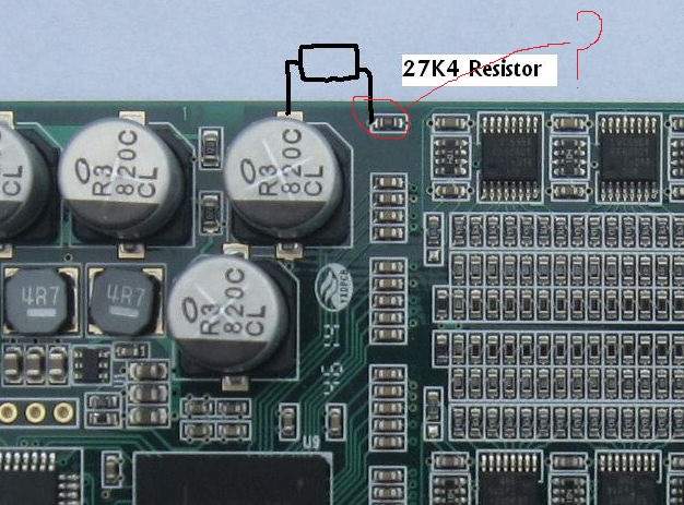

Took the plunge. Did the vref mod. First 16x caps mod from hifiduino.
Tested the dam. Works ok.
Then the other 0r, 0.1r mod.
And also the 27k4r poweron/poweroff mod.
Measured resitance after with a dmm. Seems ok.
Power on and no sound. Can connect to umanager with no problems. The dam got signal and lock but unfortunately no sound.

Every "voltage" at J2 is ok.Check the vref voltages for starters, its the first thing I did upon poweron after performing my 16 cap mod.
However I got about 3-4mv in the vref What could be wrong? Desoldered the vref mod for one channel also. No change.
The polarity for the 16caps are ok and just as described from hifiduino site.
One good thing. The poweron/off issue is gone... Absolutely silence since nothing arrive at the output..

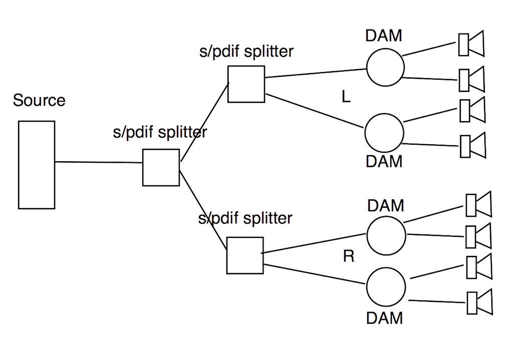

Your application can't be solved with one DAM either. If you don't use 4 boards. And you could use 3 toslink splitters to create 4 Toslink lines form one source... so.. maybe.
Get 3. But the first might need to be active.

bambadoo, for each OPA365, check that it is receiving power and that it has either +4V or -4V on its '+' input, which will indicate that the reference voltage is present.
Hi, will check later today but I suspect that the reference voltage is not present.

bambadoo, the RC caps supply the output opamps, so if you are using the raw output they shouldn't matter - that is unless they are pulling the supply down. As you are measuring 10.5Vdc, I would expect this not to be the cause of your problem.
You need to measure that you have got +/5V for the opamps, and +/-4V for the references. This will give an indication of where the problem is.

I can find +-/5V for the opamps. However nothing for the references. Well approx 1.5mv
Or maybe it is the 27k4 mod itself?
This little bastard here. (With a red ring) Can this be fried? I desoldered and try to "Ohm" it. Infinite. Is it a resistor or something else? It is too small for me to tell.

If your filters will be implemented in DAM, you can simply connect the data line from TOSLINK receiver into all dacs in parallel. No need for optical splitters, although it implies all DAM boards need to be located close to each other.
If you want to do filtering in computer, then of course you will need separate channels to the DACs.
That should be a 6k04 resistor. EIA-96 code 76B = 6k04This little bastard here. (With a red ring) Can this be fried? I desoldered and try to "Ohm" it. Infinite. Is it a resistor or something else? It is too small for me to tell.
Yes you are right. Thanks.
One of the metal ends of the resistor is loose and I had to push one dmm tip right into the side of it to get a reading. 6k04r it is.
Could this be my problem? The resistor connect 2 isolated parts of the board it seems.

I am planning to do all DSP/crossovers computer side, mapping each speaker channel to an individual digital output on a multi digital output pro sound card. Then probably multiple DIY DACs per channel.
