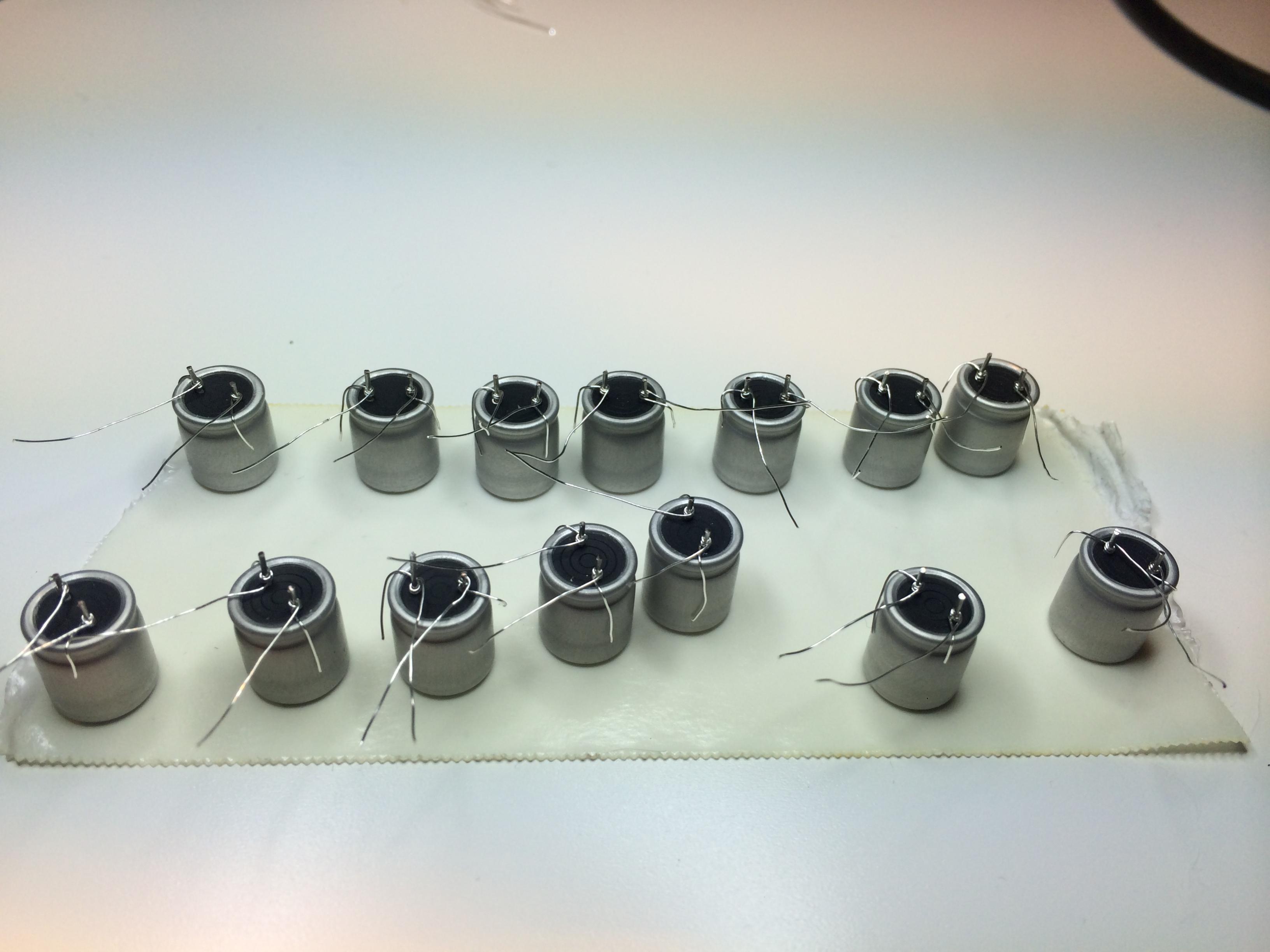

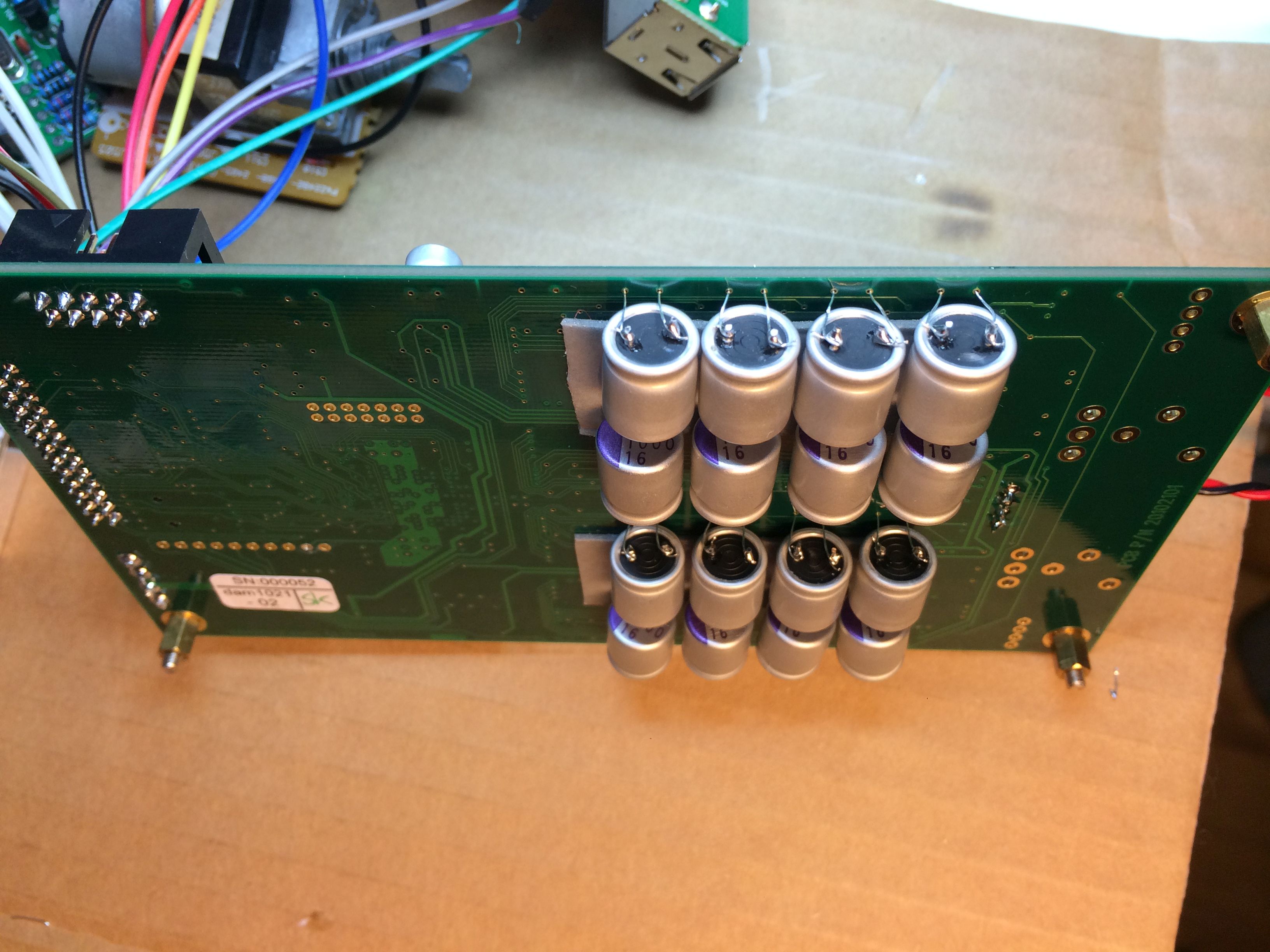

Took the plunge. Did the vref mod. First 16x caps mod from hifiduino.
Tested the dam. Works ok.
Then the other 0r, 0.1r mod.
And also the 27k4r poweron/poweroff mod.
Measured resitance after with a dmm. Seems ok.
Power on and no sound. Can connect to umanager with no problems. The dam got signal and lock but unfortunately no sound.
Late here now. Will do some more testing in a day or two..

Check the vref voltages for starters, its the first thing I did upon poweron after performing my 16 cap mod.
