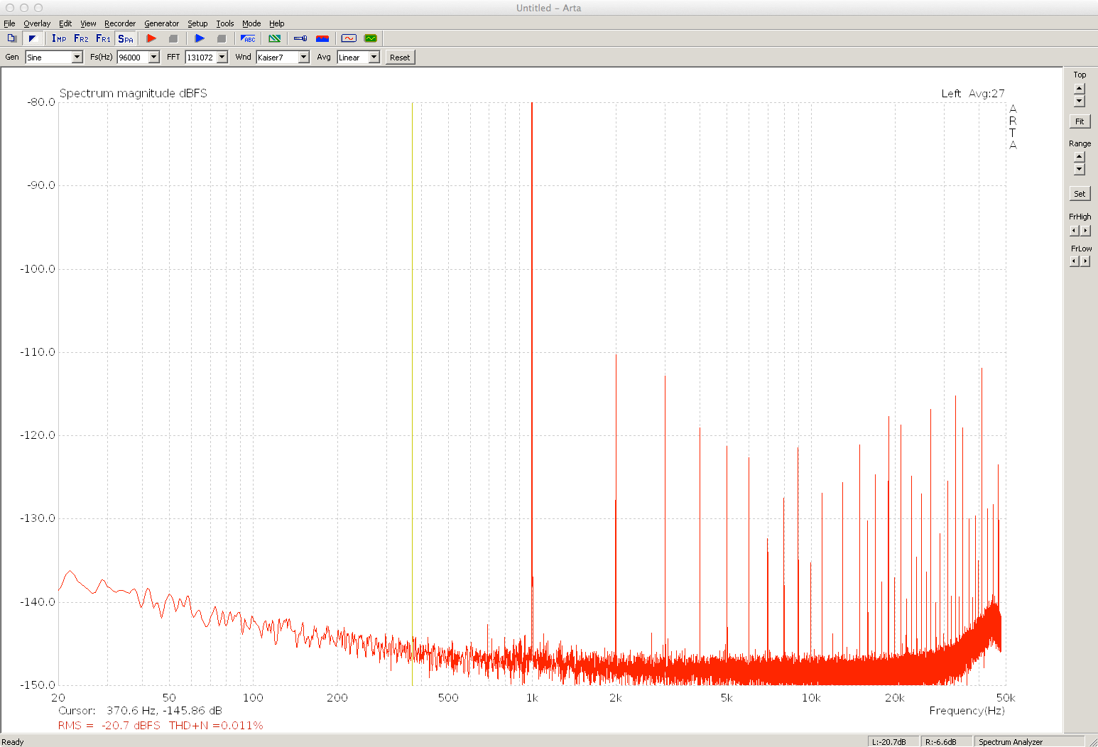

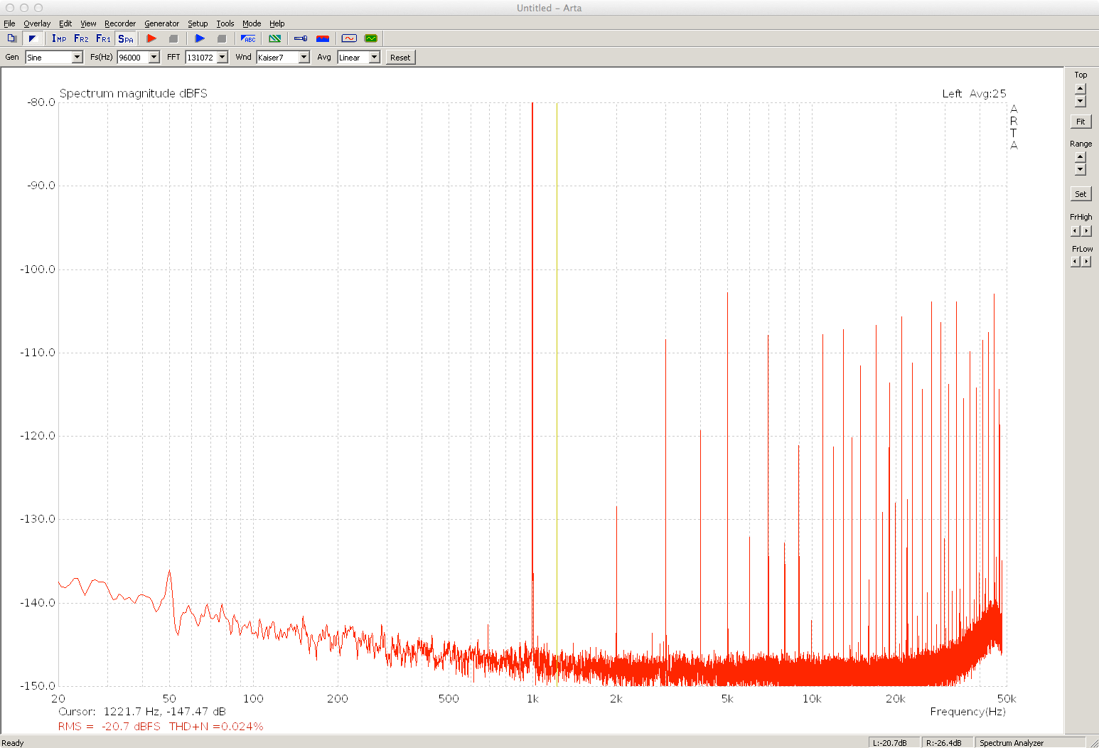

As stated long time ago, the dam1021 resistor network direct out is a voltage source with 625 ohm in series. If you want to lower the output level you simply just shunt the output with a suitable resistor....
Some random thoughts.
On the volume control;
When I connect the DAM directly to the power amp I usually end up with volume settings V-15 to V-20. In view of
the realization of the volume control in the DAC ladder is convenient but a waste of resources. The expensive MSB resistors are never used, and the specs are thus (theoretically) worse than if you attenuate after the ladder (for the volume only, no precision resistors are needed) or lower Vreff.
Perhaps a future revision could realize the coarse part of the volume control outside the ladder.
So I did a little test. First plot is with DAM volume set to -21dB
Second plot DAM volume set to -1dB and a 69 Ohm shunt resistor resulting to the same output level.
As you see THD+N is only half in the later case, however with a very different distribution of the magnitude of the harmonics.
Nice test.
I definitely prefer the second, looks more like a nice declining FFT of a triode

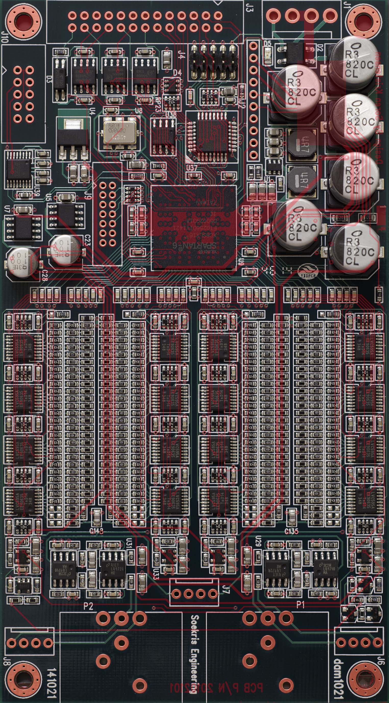

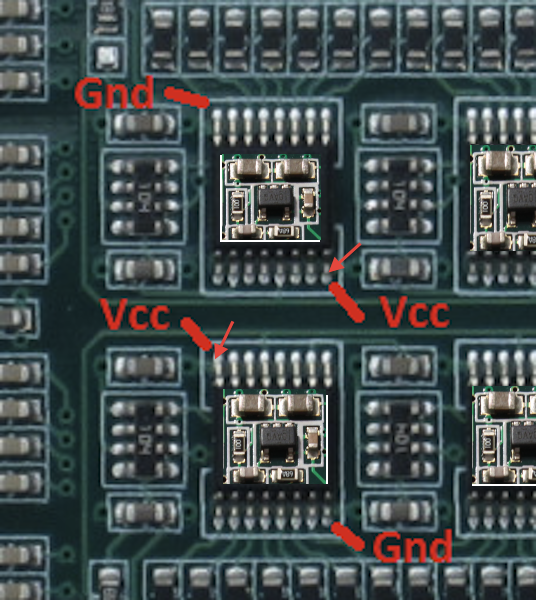

Perhaps helpful also for others until we (hopefully) get the schematics:
I photoshoped the traces and vias that are on the backside of the DAM (rev1) as transparent red on the front side. What is missing are the traces on the front beneath the components or covered by the white paint and on the back the ones that are under the sticker.
