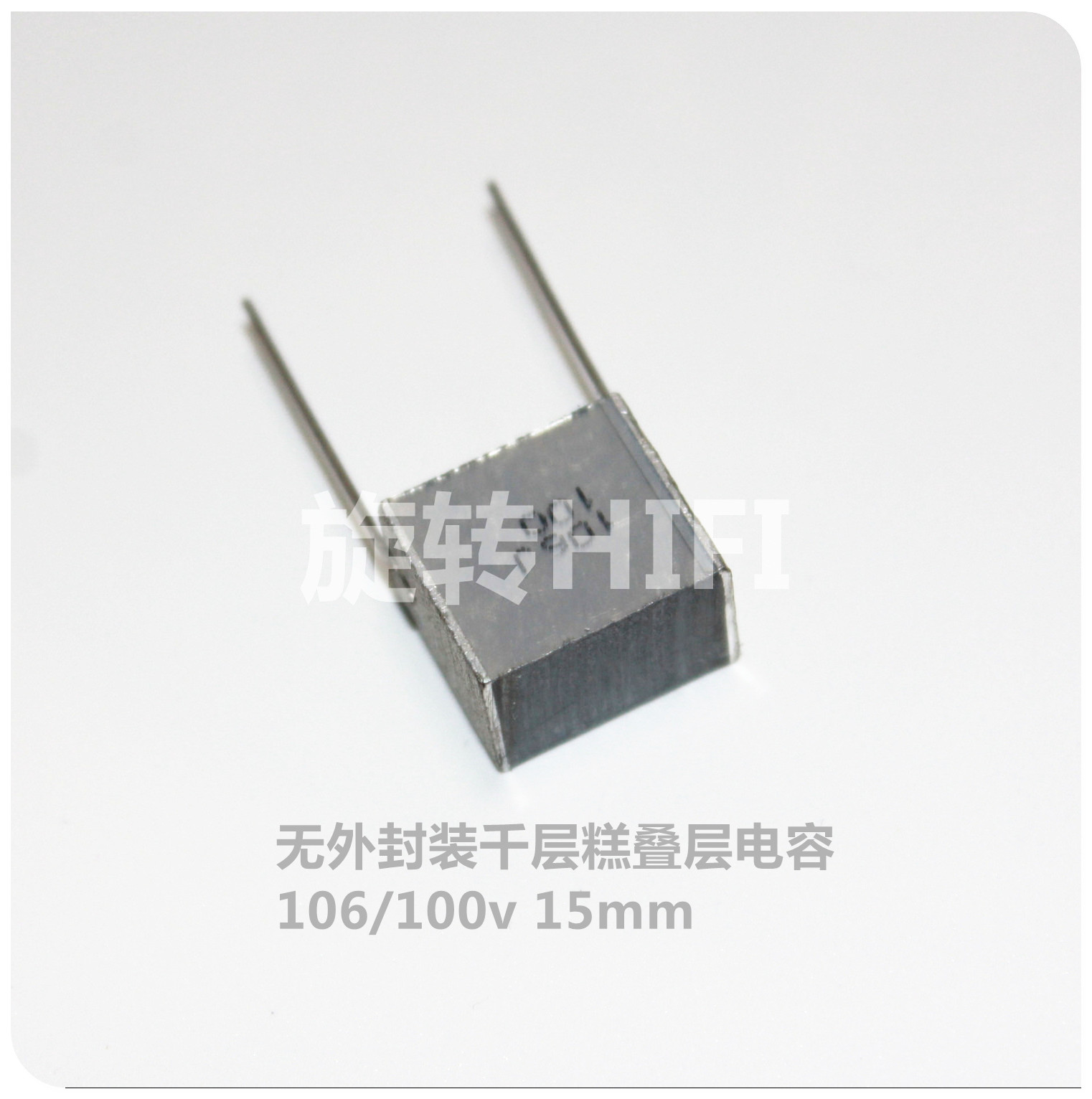

I did, replaced all ceramic shifter caps with 10uF stacked film.....
Danny
"stacked film"... is there not 10uF film ones? Why/how "stacked"?
Which cap product did you use?

What kind of 10uF "stacked film" cap are you finding in 0603? I can find nothing in film anywhere close to that value.
you must have truly excellent SMD skills.

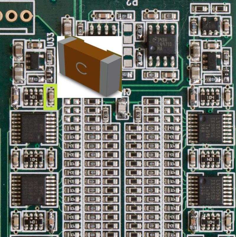

Sorry guys, I never said it was 0603 (those green marks are only pointers where ceramic are missing). Any one who already done trough hole big capacitors mod can do it. Before you cut them out just place SMD 10uF film capacitor on both wires coming down from board, and solder it. Now you can cut off big electrolytes.
Of course with good SMD tools (SMA adhesive really helps) and skills one can solder 1812 on that footprint by
placing cap vertically (there is 4.5mm x 2.6mm space).
Cheers

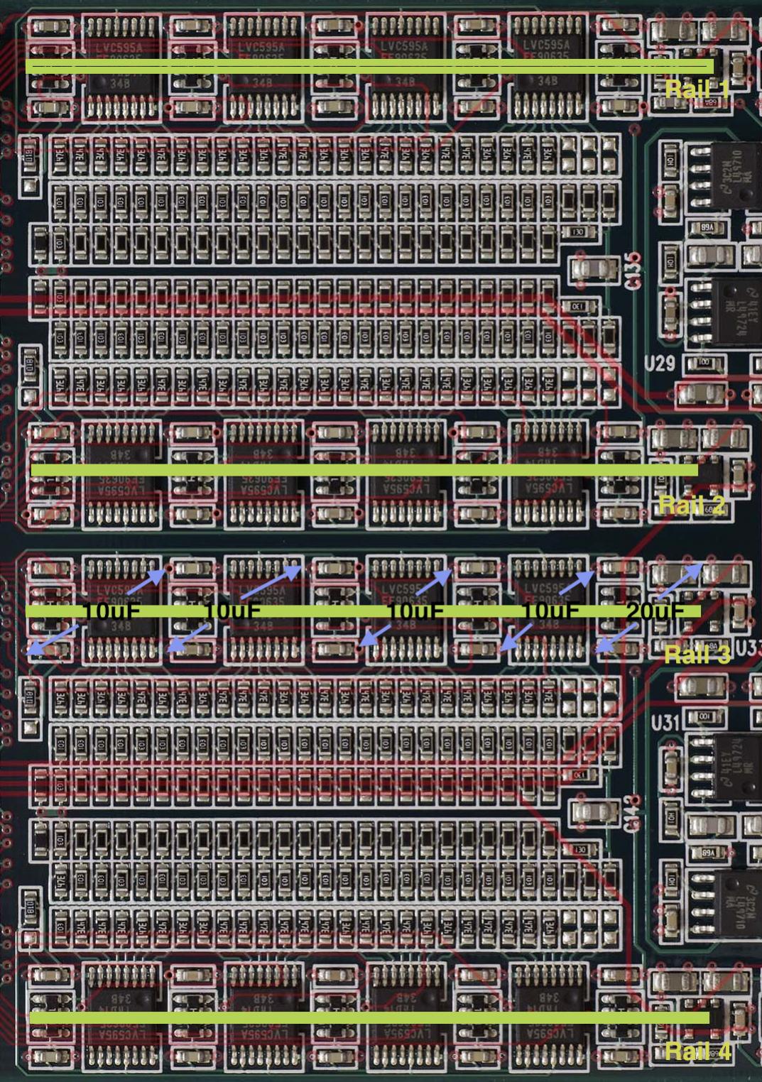

One thing to clarify for some of you :Rail is two voltage lines (+4v and Gnd;or -4v and Gnd) so 60uF per one rail (see attachment - yellow line).
Cheers
Danny
