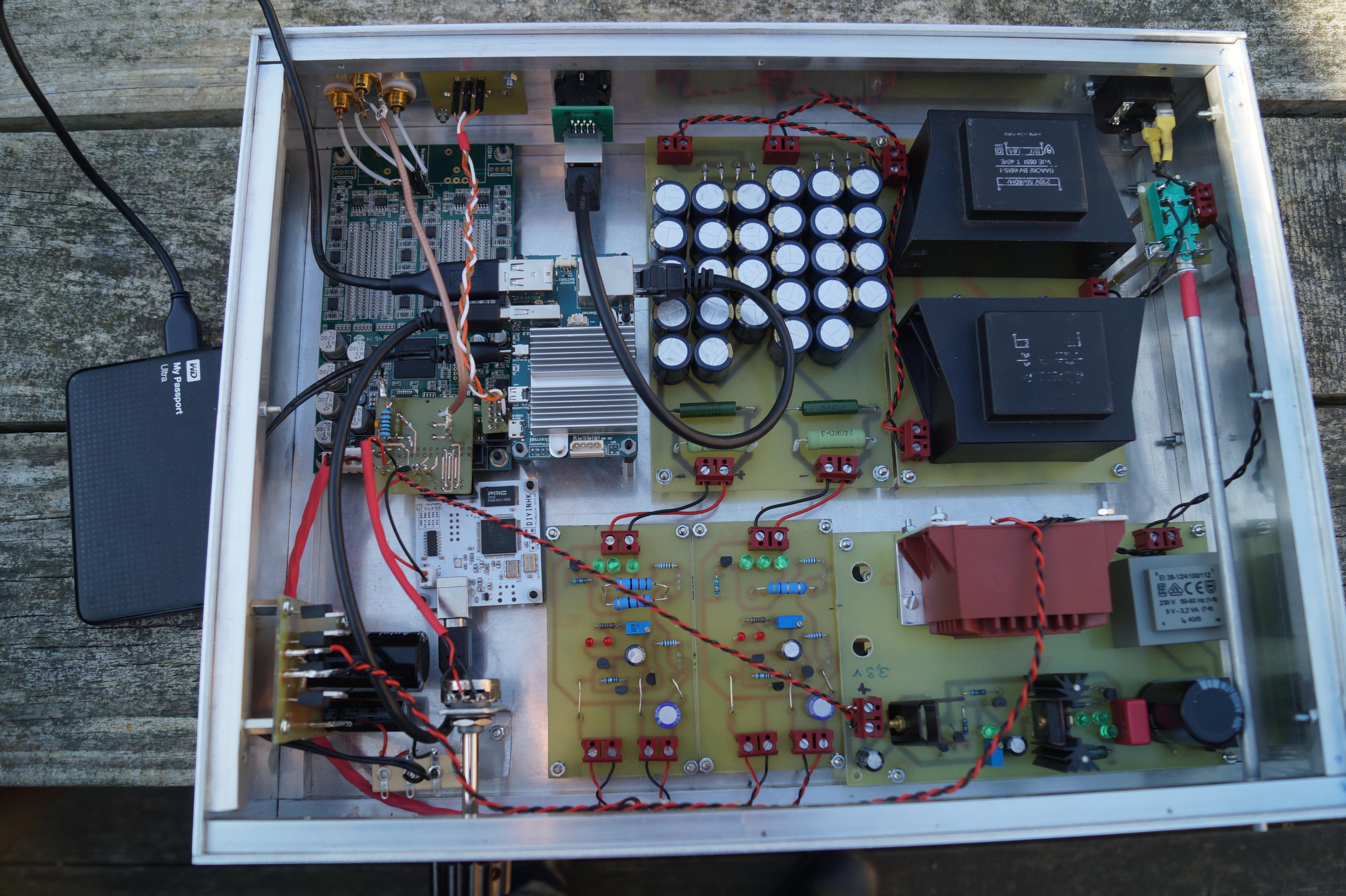

I was hoping to connect this to a Pi2 via I2S, if I can get the Pi2 powersupply right.
