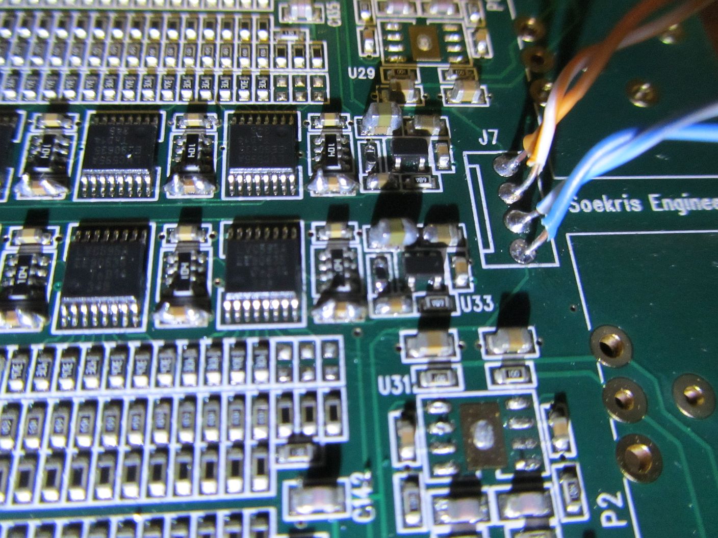

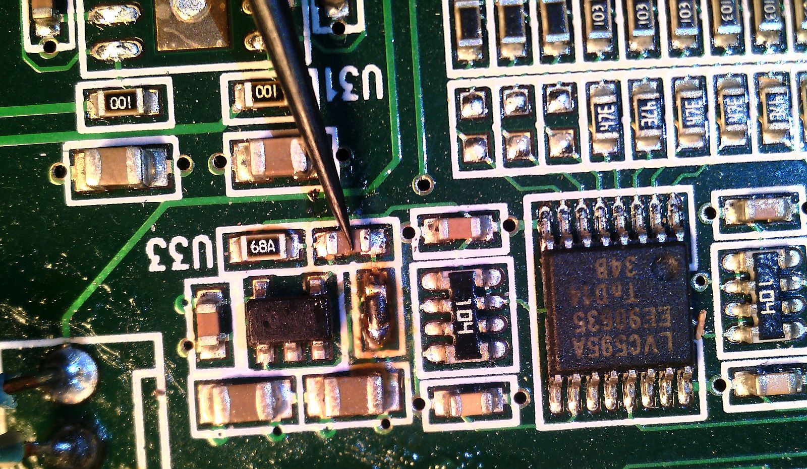

Ok - thanks. I think that the output cap mod was the simplest, Just "warmed" away the smd caps, bent the legs on the new ones 90 deg to get little feet and soldered them in. And it will not be hard to get rid of them as now one can lift a leg at a time which is the problem with smd. I'm well familiar with the current status as I have had it for the last 2 week - time to test other 470pF.
Vref mods:
There are basically two way to good result:
1) The official modification with 0.1 ohms resistors and 47uF capacitors, all smd which can be a little tricky to solder.... You can afterwards add additional large capacitors, any type. But I admit that soldering 0603 smt parts are not that easy, so:
2) Just add large enough electrolytic capacitors without changing the smt parts, simulations show the best result with 3300 uf low impedance electrolytic on each rail, just your regular good caps, you don't want their impedance to get too low, 40 mOhm is perfect for the 3300 uF.
There are an additional internal power supply impedance in each LVC595 shift registers, I have measure 0.3 ohm. That mean that there is really no reason to get the vref impedance insanely low....

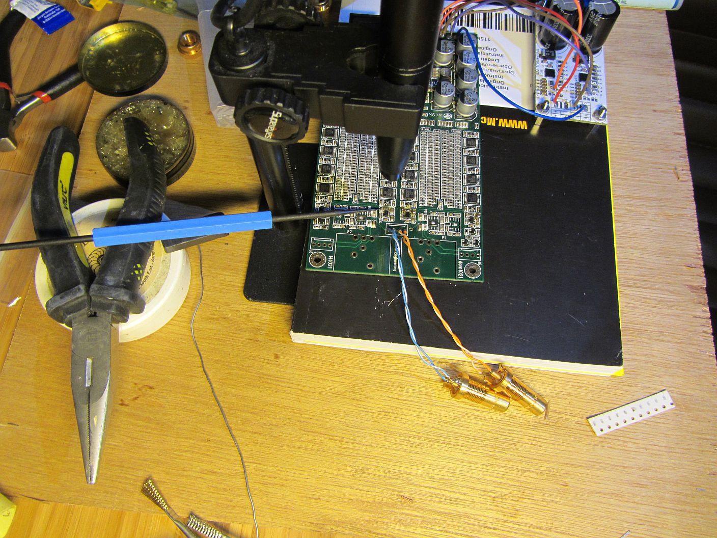

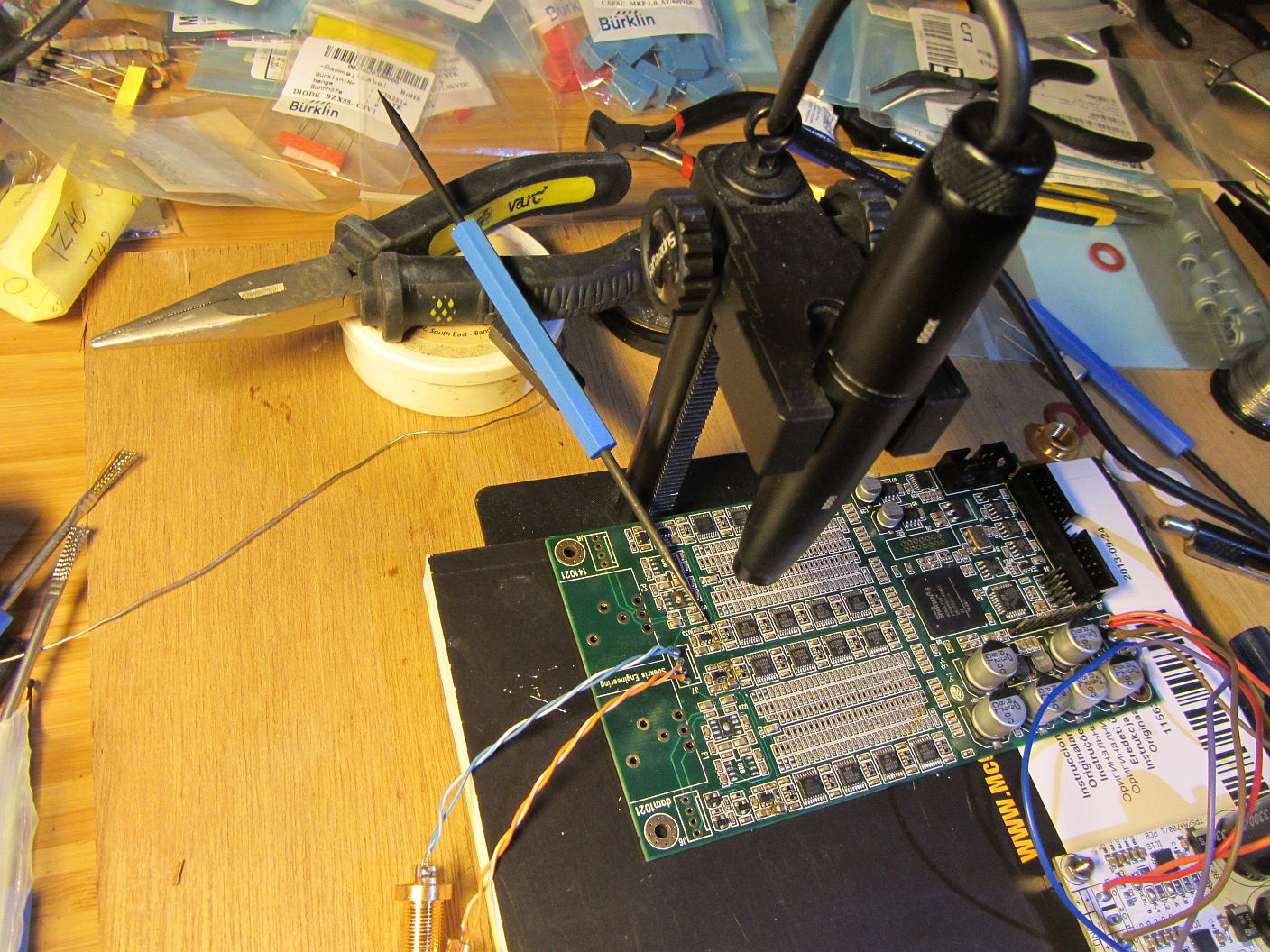

Finished soldering 🙂

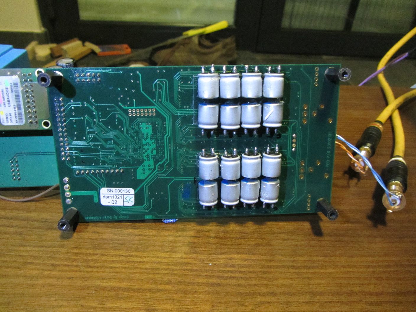

All is soldered now: vref mod (0.01ohm series, +47uf, 0.68uf compensation) and a 680uf cap (x16) for each shift register. Also additional 390uf for the clock.
Without a PC microscope I would be unable to do it, also very practical to inspect the quality of the soldering afterwards.
Problem is also to have a steady hand, move 0.5mm and it's ruined.
One trick that I did was:
- position the component on the PCB
- put a forceps/pencil/long needle on top of the component and the other end of the forceps/pencil/needle not in your hands but a few cm higher on a object.
Now you have both hands free and the component will not move 🙂
I needed some extra weight on the long needle to have some pressure on the component, I used pliers for that (not on pictures).
DAC is playing fine now and much better, the Vref mod is a must !
Before the mods it was more 2D, with the mods the DAC has entered 3D 🙂
I think the R2R DAC can stay in my system now 🙂
Danny

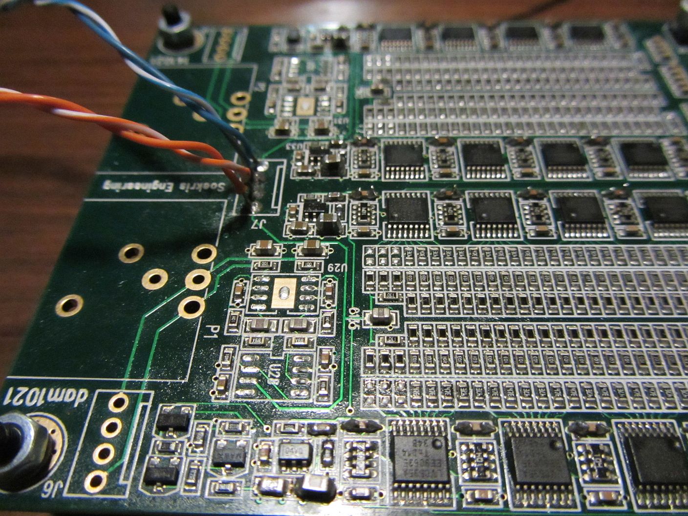

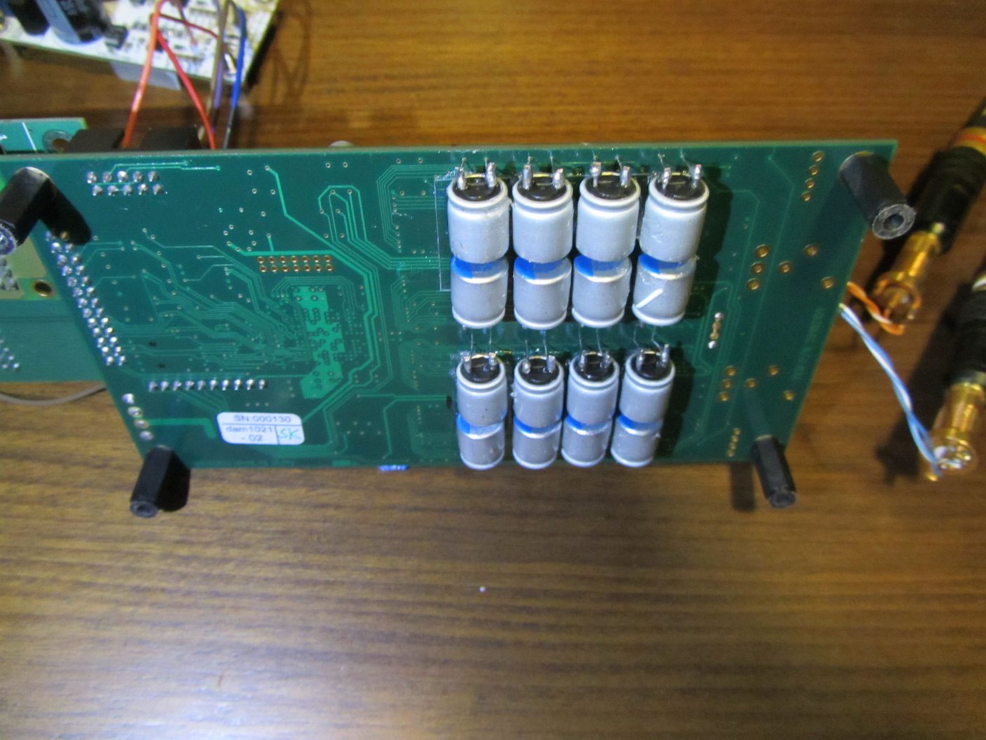

More pics
Here some more pictures of the mods done.
The vias are a blessing to add extra caps, 26AWG wire fits nicely through the vias. Thanks glt !
For the moment playing with the latest filters from Paul, thanks Paul !
Congrats Soekris for the DAC, after the vref mods it's on the level I want it to be 🙂
