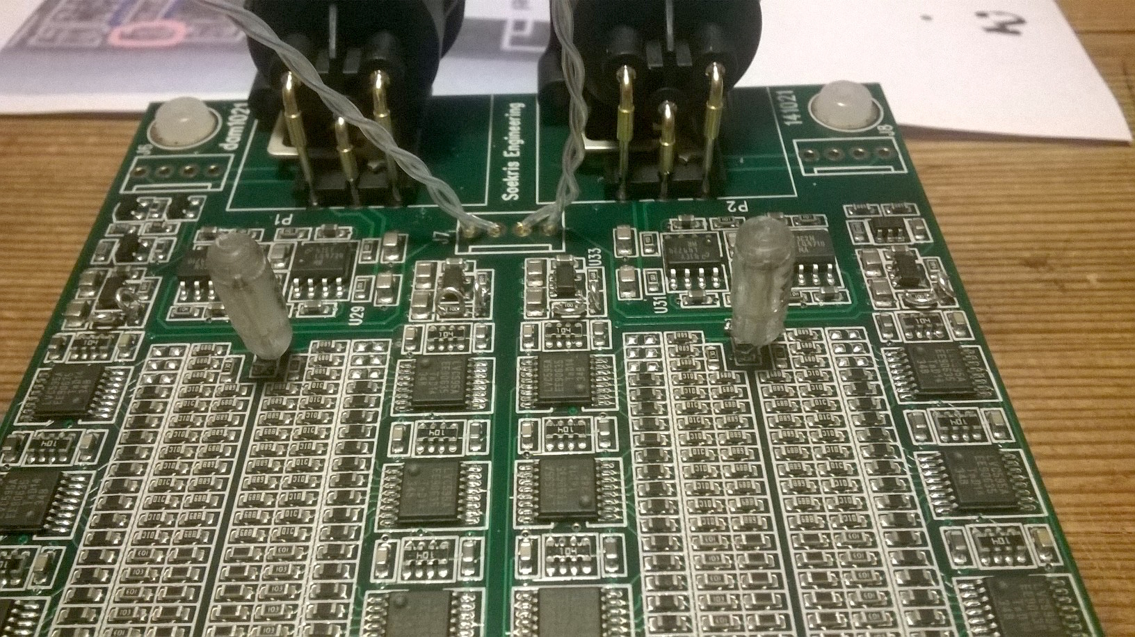

Pic of reconstruction filter caps. and vRef mods.
..... I have improved my DAM a lot.
# I did the ref mods (shorting)
# Added 1000uF per vRef (4)
# Added 1000uF for clock power feed.
# Physically dampened the clock chip with Noise Killer sound damping paint.
# Replaced output filter caps with styroflex cap (same value)

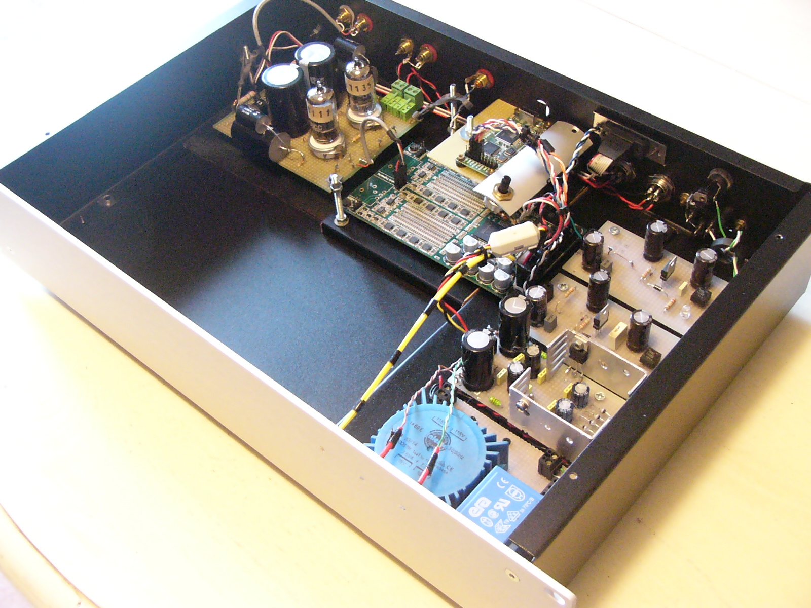

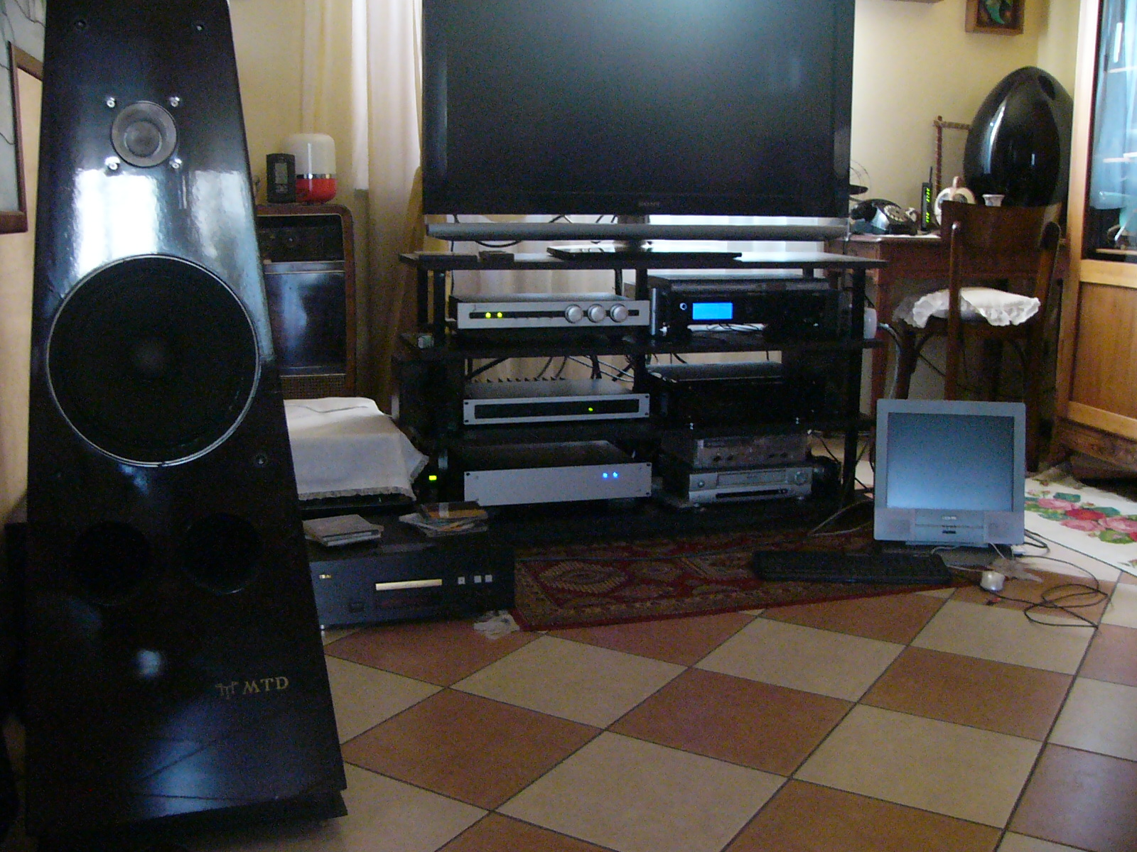

According to me the problem of dam1021 is the output buffer is not suitable for a rest of the card. With this configuration, the sound has improved a lot: I connected to a raw buffer circuit valves see link, without potentiometer, I only improved the anode supply by replacing the resistor with inductance and increased the capacity of the power supply capacitors and coupling the output - voltage stabilized filaments, resulting all very quiet. Then I added a potentiometer to the dam set at -14, I did last firmware update, filter F4. I compared the dam1021 with Lector Digicode 704, see link: mechanical Teac cd VRSD10 connected to dam1021 (SPDIF), the digital source connected to the Popcorn hour c200 Lector Digicode 704 (SPDIF), Spectral dmc12 preamplifier, amplifier Spectral dma80, speakers MTD MUSIC. TEST THE BLIND AND SWITCHED FROM LECTOR DAM IN REAL TIME, WITH HELP OF A FRIEND OWNER LECTOR. Result: timbre, spaciousness and three-dimensionality INCREDIBLY EQUAL, I REPEAT THE SOUND WAS UGUAE. I do not have a premise in a technical, do not ask measures or graphics, the result of this all depends on what I have described above. Congratulations to Soekris.

TNT,
What are the loops of wire I think I see on your board? I could understand for the cap jumper but I think I see them at the resistor position, also.
Hate to have to say it but those styroflex caps are not very good for anything. Maybe you can get away with them. Certainly they have the advantage of being very light in weight.
They are renowned for their gritty sound. Excuse the rhyme.
When I FINALLY get around to it I have got some Russian teflons which will be difficult to use but should work very well.
Nonetheless, congratulations on making the mods and thanks for your picture. I am ginning up the courage to go and finally do them this afternoon.
Take care,
The loops are the parts of the "factory mod". One takes away the cap, the other was to set the output resistance to 0,1ohm but I went for 0. Styroflex is the ultimate capacitor dielectric. I wanted specifically a capacitor made out of this. Maybe will aslo try some other make of styroflex.
Polystyrene is an excellent dielectric but its presence is not enough to make a cap "good".
I did not realize you were using jumpers all of the way. From what Paukl/moredamfilters found with his tests is this low value requires, at least, 1000uf additional to have a reasonably flat impedance.
Using those jumpers might be easier than using those damned resistors! After losing two in a glob of solder I threw my hands up in frustration. I hope I can get them back down to try again with jumpers. Much cheaper ...
