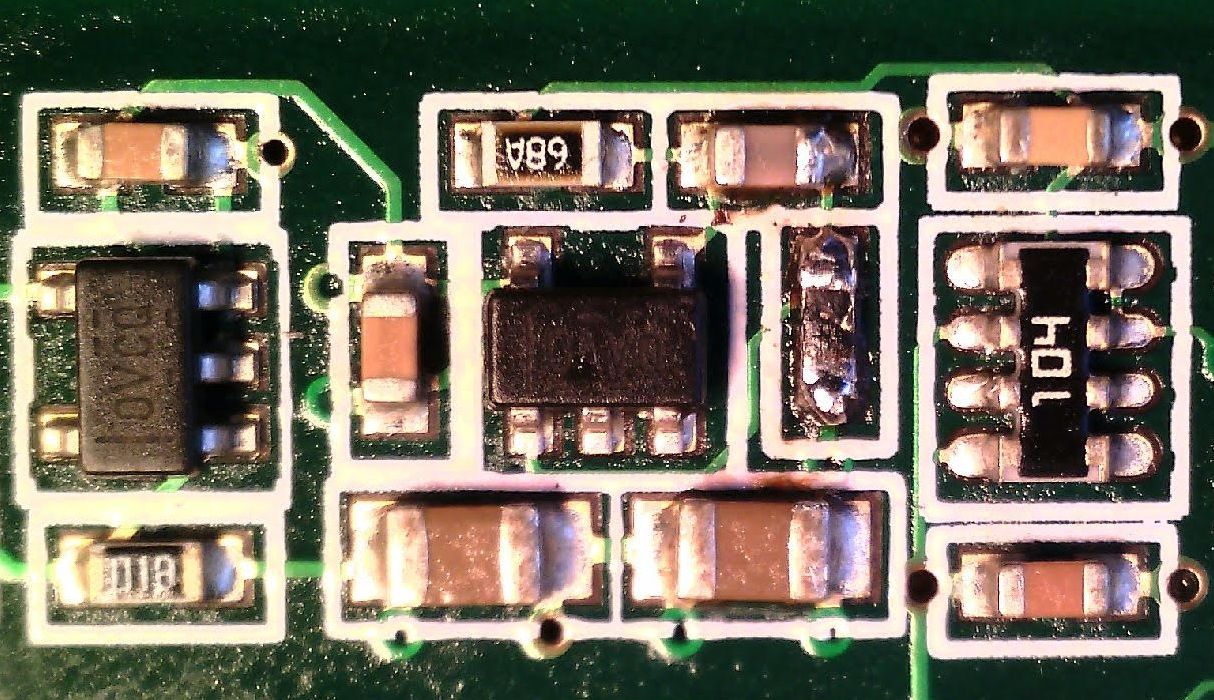

SMT soldering
Hello,
yesterday I started soldering the Vref PS mod, one hour later I finally had one resistor soldered 😱
I use a PC microscope to see what I'm doing.
Those SMT are really small, I've done some SMT soldering in 1206 package and that's still doable.
But the SMT package of the R2R is really small, many times the SMT component stick to my soldering iron instead of the PCB.
Is there some kind of trick to keep the SMT part on its place ?
Danny

Apply solder to one solder pad, hold the iron against that pad to keep the solder melted, move one side of the resistor onto the pad with the help of a magnifying glass and forceps and then solder the other side while the first side is secure. You might have to resolder the first side if the contact isn't good enough.

It's crucial to use a very fine tipped soldering iron. I used a 0.12mm and it was relatively easy.
You should start by putting a little soldering paste on the existing solder joints. Do not skip this step - it will make your job a lot easier.
Then add some solder on one of the two joints of the existing part so as to tin it. Then place the new part on top of the existing part and heat the tinned joint while holding the new part in place with some forceps. I usually just press lightly on top of it to keep it in place. Use needle-point forceps.
Upon heating, the solder should melt and stick to the new part as well. Then go to the other side of the part and solder it.
Once the new part is secured in place I usually go back to the first joint and add some more solder, just to be sure.
