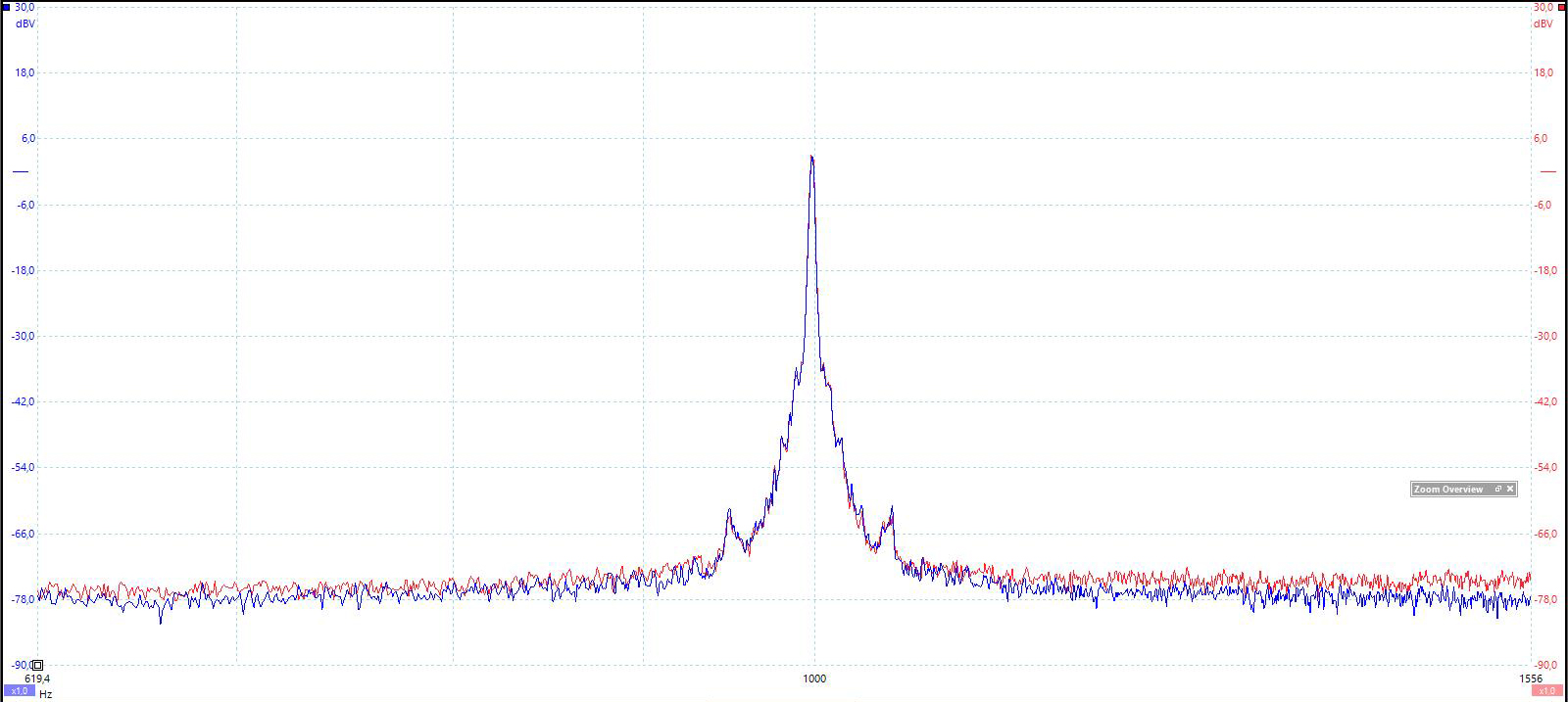

Yes, excitation of the sub-audio cart-arm resonance does not show up in audioband spectra of surface noise. But it does show up in FM analysis, pitch stability or vibrato of programme material, which is a different sort of degradation of programme playback. Amplitude of the resonance can be a benchmark for friction in a specific setup and record combination, which IME correlates with surface noise.
Where LF resonance really shows up is as IM distortion.
Look at my stretched recording below of a 1Khz tone and you will notice the IM products at 1Khz +/- (n*fres)
The better the damping of the resonance peak, the lower these IM products will be.
