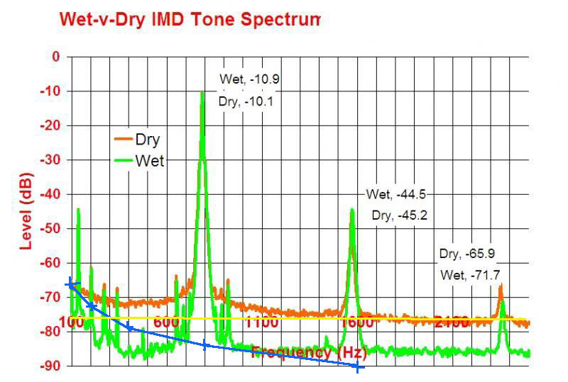

I took your picture, and painted in blue a 6dB/oct line starting at 100Hz.
As you can see, this differs from the noise in your picture.
Then I painted in yellow the base noise line.
The point where the measured noise lies 3 dB above the base noise is the corner frequency.
This is roughly at the same 250 Hz as in my measurement.
Compare this mechanism to 1/f noise in Fets and Op amps.

Hi Hans, thanks and no problems here.
You happen to have selected a start point and arbitrary region where the fit is particularly poor, not least because there is a lot going on. The octave between 1kHz and 2kHz and thereabouts, for example, shows -6dB or so, and so on. What is clear is that there is a gradient, whereas there is no gradient in the measurement with low friction. Also thoroughly clear is a -10 to -15dB reduction in noise level, on average, as measured, with low friction, whilst signal level remained roughly constant.
Yes, one has to be selective to say the curve roughly fits 1/f, but does for at least an octave or two. However, the fit is not good especially at low f. The mechanism I believe is stick-slip motion, and although the friction force may follow a 1/f flicker law, motion itself only results when friction force exceeds a certain threshold, and only motion produces noise. It is very different from mechanisms in semiconductors, I think, which behave more ideally.
At certainty of ruining your test disc, you could repeat my result for yourself, but IME it tallies with audible results and I would stand by the measurement result, if not the interpretation and explanation of mechanism/law.
Even if it means that 'better than cutter S/N noise spec' is achievable, because I doubt that spec anticipated ultra-low playback friction.

1/f friction noise that starts and stops in the middle of the frequency range?Yes, one has to be selective to say the curve roughly fits 1/f, but does for at least an octave or two. However, the fit is not good especially at low f. The mechanism I believe is stick-slip motion, and although the friction force may follow a 1/f flicker law, motion itself only results when friction force exceeds a certain threshold, and only motion produces noise. It is very different from mechanisms in semiconductors, I think, which behave more ideally.
Highly unlikely to my opinion.

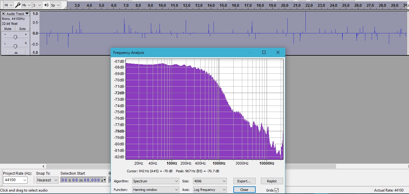

It is a complex artefact of the random nature of stick-slip mechanics involved, I think.
A few years back I successfully simulated authentic sounding surface noise, crackle-pop-tick. I used a pink noise sample, and applied a noise gate with a threshold a few dB below peak level, leaving just the residue with amplitude above, say -2dB. The waveform resulting is a random series of short spikey events which vary in amplitude. It is immediately audibly recognisable as very similar to surface noise.
In mechanics, I believe the pink noise represents random variation in friction force between stylus and groove. Above a certain threshold, a stylus can stick/lose contact with the groove, and this is represented by the noise gate threshold.
Attached is an example of a waveform and its spectrum for a 30s sample at -2dB. You can see the events resemble random amplitude impulse like spikes which occur randomly in time. The resulting spectrum is complex, random to a large extent, and has gradients which characterise certain regions.
Obviously, this is only a crude simulation, but I found the resulting spectrum is always complex, has many regions, and depends critically upon the colour of the pink noise source as well as the threshold. Most remarkable is how much like real crackle-pop-tick noise this sounds !

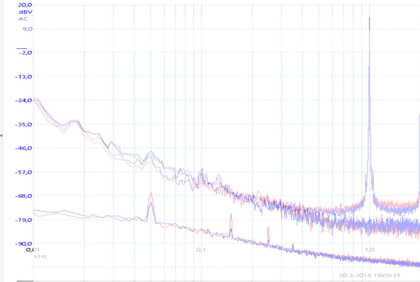

When comparing noise from a recording with a silent track and a recording with a 0dB 1Khz tone, when the needle would be loosing contact every now and then with the groove, it would certainly happen more often when following a strongly modulated tone than with an absolutely flat groove without any modulation at all, wouldn't it ?
And following your suggestion on this phenomenon, the spectrum of the noise would change accordingly, especially in the range up to 2Khz where energy in your figure is the highest.
However, look at the figure below representing the spectra of the left and the right channel in both situations. LF Noise is not affected by the 1Khz tone.
The lower spectrum is recorded with the arm in the air and the motor running, showing the background noise of the whole playback system.
Yes. And exactly this happens. In programme material when there is a clear loud high pitch tone, background crackle-pop can be significantly elevated. There is a particular Tom Petty track which demonstrates this beautifully, I'll look it out. On some test records, loud test tones which are inaudible to me because they are, say at 18kHz, can clearly have notable elevation in surface noise when the test tone starts and stops. In other program material, such effects are masked by the level of the programme material itself; only certain material allows it to be heard because programme material masks it, but it probably happens often, whenever trackability is stressed.
It is not mistracking, in the classic sense; it arises because difficult tracking programme material 'consumes' VTF budget, then threshold for friction force required to cause the stylus to lose contact becomes lower, so surface noise notably goes up.
In arms with an offset angle, the effect is often more pronounced on one channel, depending on skate force balance. This is because the offset angle invokes variation in skate torque in response to variations in friction, and peaks always pull the stylus onto the inner groove wall.
If I understand the plot, there is about 4-6dB difference w/o the test tone, over at least apportion of the LF spectrum.

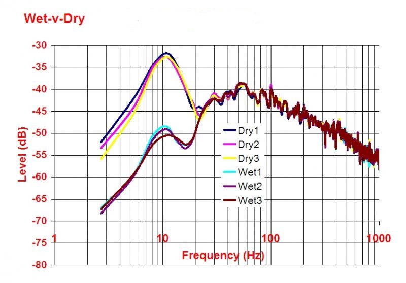

Another huge discovery for me was the effect of ultra-low friction on sub audio spectrum, specifically the arm-suspension resonance. Attached is a plot showing LF spectrum wet-versus dry, repeated three times for certainty because it is such a remarkable result.
You can see there is a profound reduction in the amplitude of the classic arm resonant response, whilst the Q remains roughly unaltered implying damping remains unaltered !!
After much thought, I realised that random variation in friction causes random variation in skate force. I concluded that reduction in random groove-stylus friction reduces stimulus for motion of the arm, hence reduction of the amplitude of the resonance in the spectrum because a significant stimulus has been reduced. The arm is thus far more stable with ultra-low stylus-groove friction.
This, I believe, is evidence that friction force varies.

Look again and you will see that the portion that is higher in noise is the noise with an unmodulated trace. This does not correspond with your findings in any way.If I understand the plot, there is about 4-6dB difference w/o the test tone, over at least apportion of the LF spectrum.
Looking at your figure, it must be that some form of a rumble filter is attenuation the low frequencies.Another huge discovery for me was the effect of ultra-low friction on sub audio spectrum, specifically the arm-suspension resonance. Attached is a plot showing LF spectrum wet-versus dry, repeated three times for certainty because it is such a remarkable result.
In my recording no rumble filtering at all was taken place (-3dB at 1Hz), and I see nothing of the sort of bump that you have at 10 Hz.
Again our findings are completely different for whatever reason.
I did look again, and it's not possible to tell from your plot which curve is which because colours are the same and they cross over. In any event, a 4-6dB difference is surely unexpected, would need explaining, and would fit if there were some confusion as to which trace is which ?
In any event, 1kHz at 0dB (5.6cm/s) is not exactly a tracking challenge. To see the effect clearly it's necessary to stretch trackability somewhat.

The cartridge-arm resonance at c 10Hz is well known, pronounced, and shows up readily in just about all LF spectra. It's a crucial part of cartridge-arm mechanics. My preamps have a roll off with a corner c 3Hz, so what you see is pretty much what you get. The curious question is why you apparently don't see it in your plots, Hans ?

Hans, I looked again at your plot. If you check out the octaves above and below the 1kHz test tone, you'll see the noise floor is c 6-8dB higher when the test tone is present, also there is notable difference between the channels when the test tone is present, more noise on one channel - see my mail above!

1) I am afraid you are loosing yourself into details that have a completely different reason to be there.Hans, I looked again at your plot. If you check out the octaves above and below the 1kHz test tone, you'll see the noise floor is c 6-8dB higher when the test tone is present, also there is notable difference between the channels when the test tone is present, more noise on one channel - see my mail above!
LD
What you see around 1Khz are of course the sidebands belonging to the type of windowing, making the peak somewhat wider and the sidebands significantly lower. In this particular case the sidebands are starting at ca -80 dB below the peak, you can't get it better than that.
2) And the difference of 1 or 2 dB in noise between channels is also completely insignificant in a noisy signal.
Concentrate on significant facts and not on details of details.
3) A 1Khz 0dB signal is a giant step in strain on the needle compared to a blank trace, you do not seem to accept information that does not fit into your theories.
Again I do not doubt your measurements, but your attempts to explain and prove things are not enough substantiated.
OK, but these are your measurements, and I don't see the point in analysis and presentation that isn't capable of resolving the phenemenom you are looking for. Even so, there are interesting hints such as difference between channels, and differences in the lf spectrum, outside the sidebands.
What one might say, positively, is your setup and test disc appears very quiet, and you apparently are looking for a phenemenum that isn't prominent or perhaps isn't even there in that particular test and conditions.
As already said, your LF analysis appears to lack the normal cart-arm resonance, for example, which is also very odd.

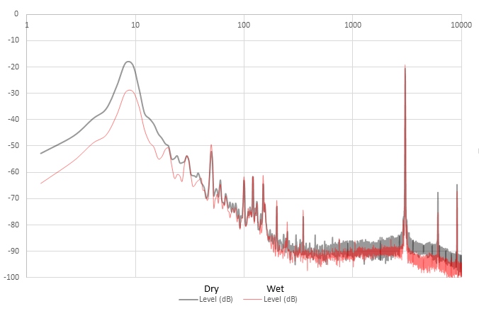

AFAIK, the only other case of someone sacrificing a test disc in the cause of examining wet-v-dry noise, appears to confirm my own measurements.
Both as to significant improvement to general noise floor, c 6 - 10dB, and significant improvement to cart-arm resonance amplitude, ie arm stability.
Attached is the spectrum for wet versus dry, but since the files came from a 3rd party some time ago, I know few details. It seems to be a c 3kHz test tone, in two wav sample files.
Anyways, here's the raw spectra, attached that show the analysis.

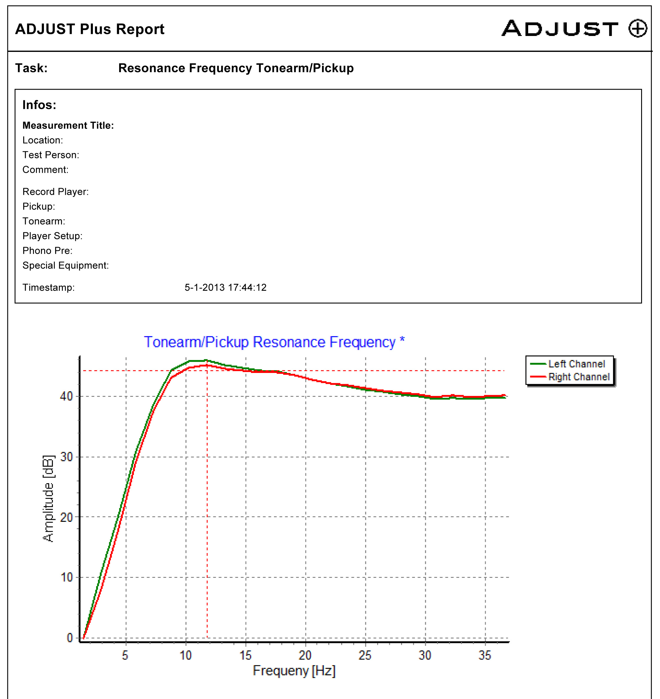

For sure my cart arm shows like every other 2nd order system a resonance peak when stimulating with sweeping sinewave.
So nothing special, but this is hardly reflected in the noise when playing a blank trace or a 1Khz tone.
